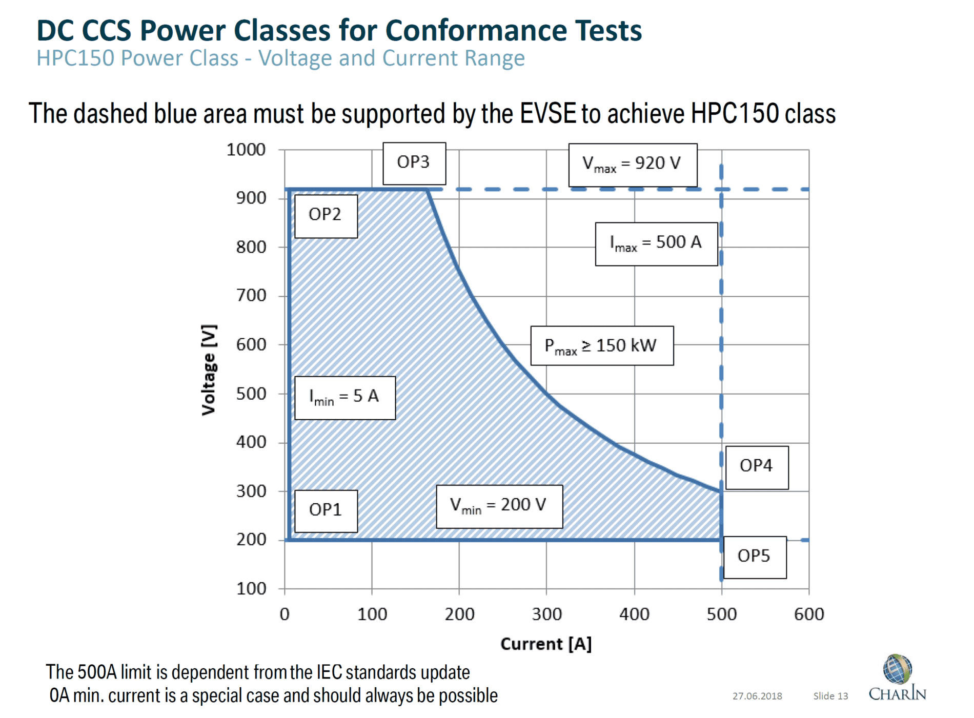

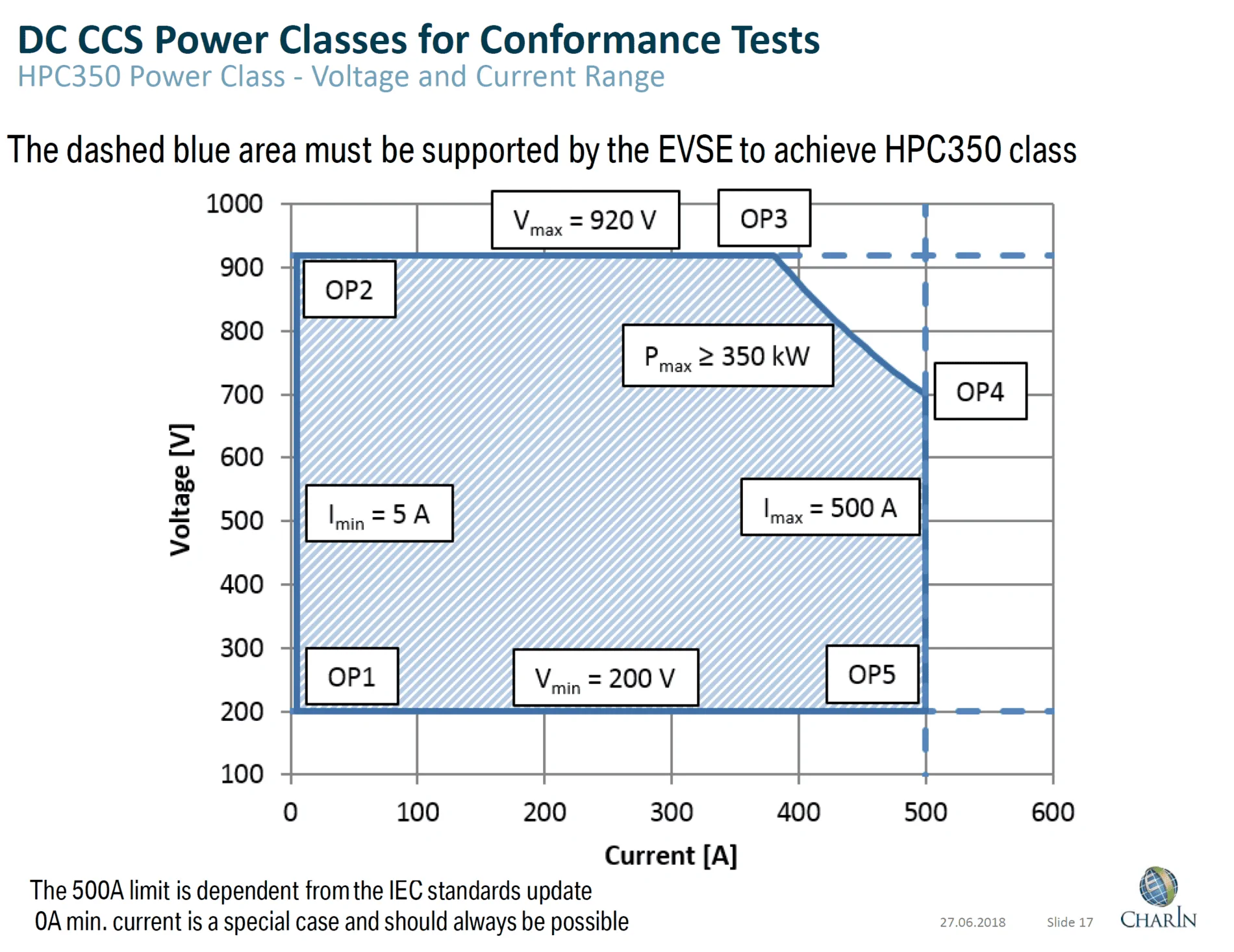

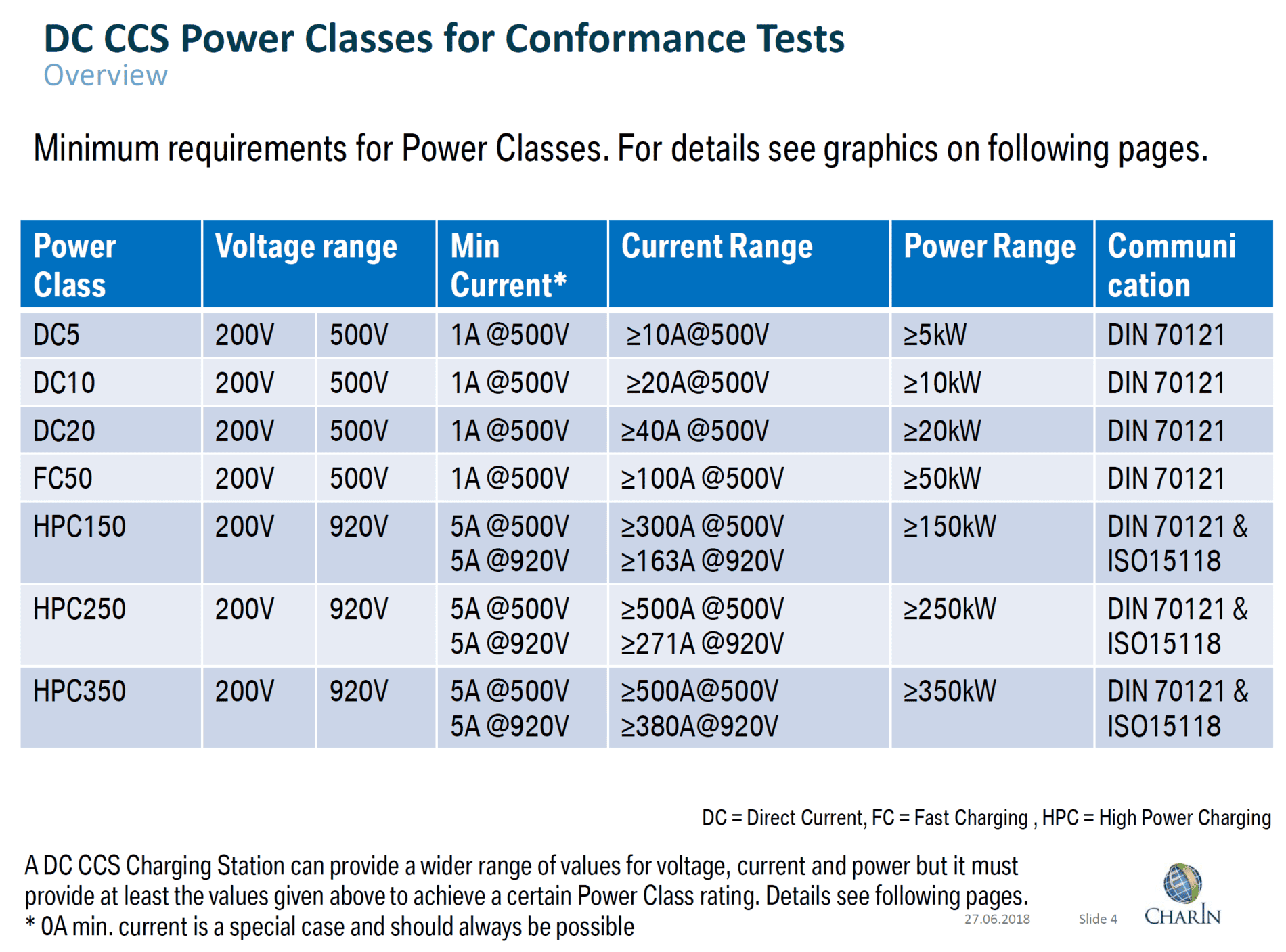

My bad. Posted without confirming what I thought I knew.
CharIn specifies minimum voltages/amperages, but does allow for greater values outside that range.
HPC350 actually requires 500A support at up to 700V.
HPC150 actually also requires 500A support (at up to 300V).
A 150 kW unit that had 400A Max could be certified as FC50 (>=50kW), but not HPC150

It looks like CharIn has not set a maximum for either voltage or amperage, but set minumum values and the range of combinations of the two that must be supported and can therefore be tested for compliance/compatibility.
Manufacturers of both charging equipment and vehicles can design to use higher amperages and/or voltages, but interoperability could potentially be (more of) an issue.
