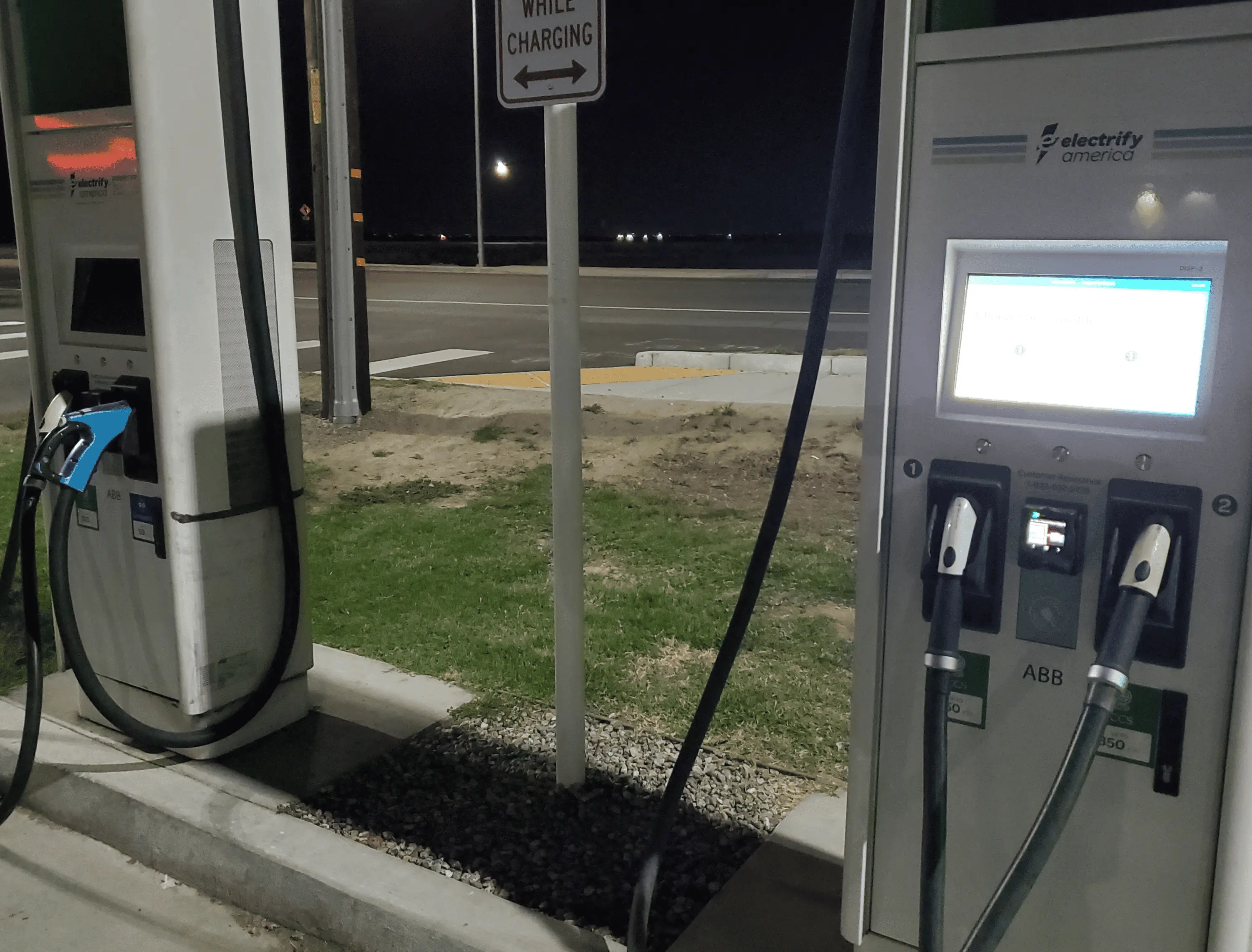

I arrived to my location, which was close to a charger. Went to charge the truck then go to dinner while it charged to 100%, to get me most of the way home the next day. Tried 6 different chargers at that location and none of them would work. On the phone with EA and they rebooted two machines (four charger plugs). No luck. Others were charging at the same location. Was going to wait for one of them to leave and try one of those chargers since they were clearly working.
Finally, the EA representative on the phone basically gave up and said, "I can't help you", "sorry", and added a complimentary session to my account for future use.
I then decided to do a full reboot of the truck after about 45 minutes of trying multiple chargers and going in circles getting nowhere. Did the full reboot (hazards / left button). That did the trick and was finally able to charge.

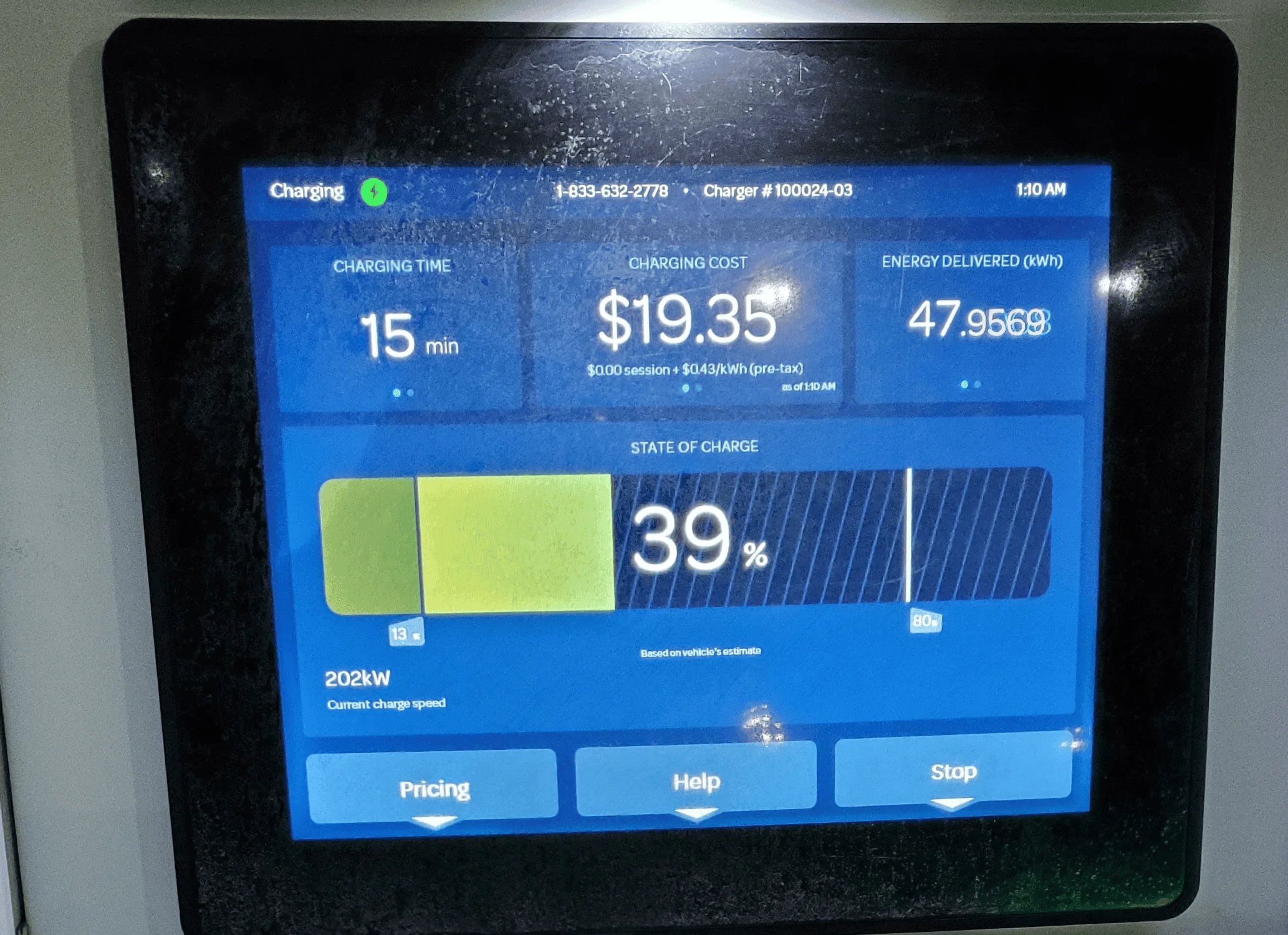

I was happy to see on one of my charging sessions at a 350kw charger that it peaked at around 210kw on the screen. Was down to 202kw by the time I grabbed my phone to take a photo (see below)
One on the right said charger unavailable. One on the left was powered off.

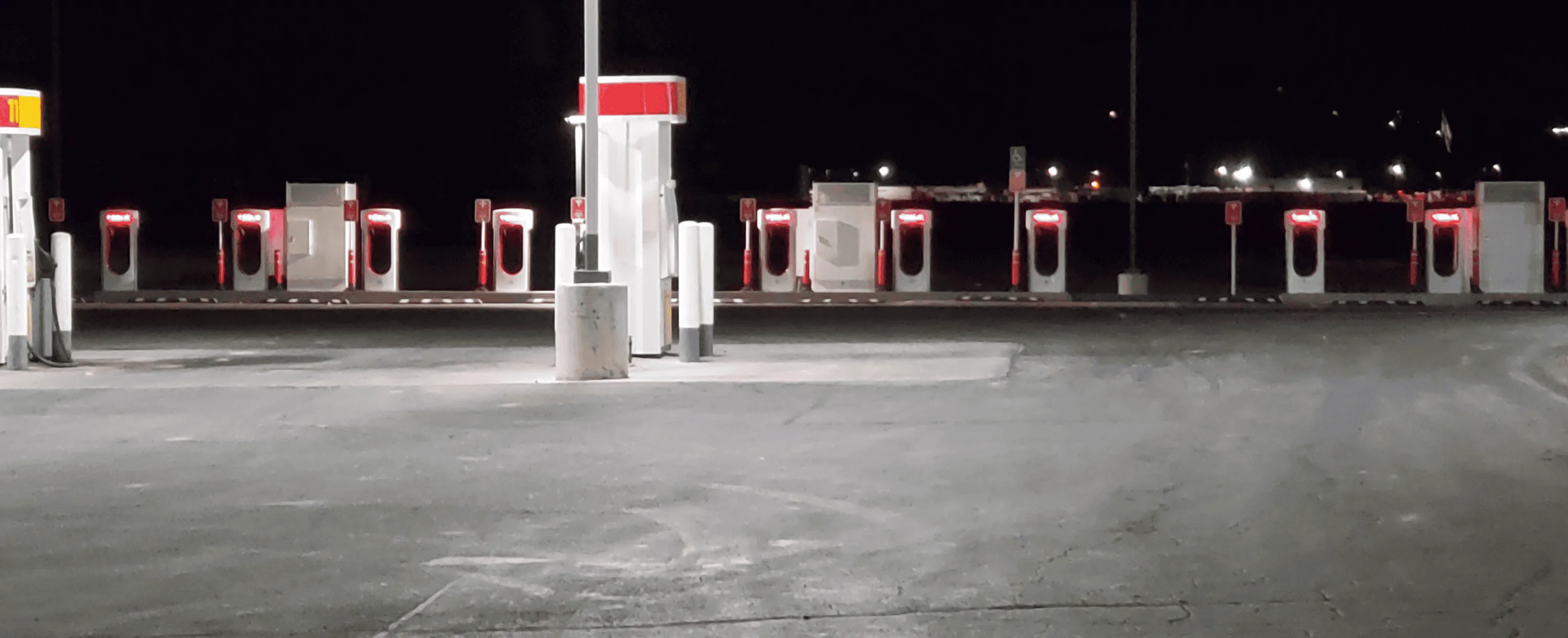

Was missing my Tesla when I couldn't get the truck to charge.......

202kw charging rate (peaked at 210kw)

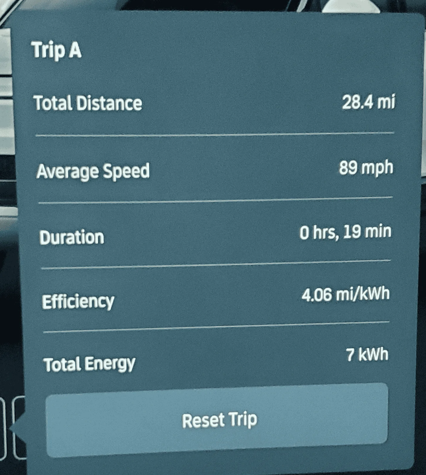

CHECK OUT THESE NUMBERS!!! (This was at 4:00 in the morning)

I have used EA just about exclusively on longer trips. I have been able to charge successfully every time, and every session has been complimentary since early September. The screen says they are in the process of upgrading their systems starting Sep 7th. Don't know if that has something to do with it. There is one on my most common ~200 mile trip and I don't really have to stop to make it, but as long as its free I'm going to stop. And the Taco Bell across the street appreciates it.
I'll occasionally see it peak around 205-225, but it pretty quickly pulls back to ~150-175 until the taper starts. That is still plenty fast to get me to 70% with a trip to the bathroom and Taco bell (surely related events), but I usually sit through the slower charging to at least 85% because its free. I'm up to around 4200 miles on the truck. Home charging is mid day when my solar can provide between 60-95% of the power. I don't track it that closely, but I'm certain I have spent under $150 total for that 4200 miles. That would have been somewhere around $700 of gas in my old Escape.

I had a similar problem on my road trip this summer. Turns out, a failed EA charger at an earlier stop "corrupted" the communications module used during the charging process. Finally figured it out after trying three other charging stations and then calling Rivian. Rivian had me do a hard reset but cautioned that doing so wipes all logs. So, they recommend only doing so after talking to them....I guess so they can pull the logs for diagnostic purposes. Like you, once I did the hard reset, charging worked well.
Strange thing is, I was lucky at my first charger on the way there. The screen was completely sandblasted and couldn't read a thing on the screen. Knowledge told me to always plug in first. I then swiped my phone as I remember doing that at a prior session.
On my road trip, I found most EA screens unreadable. I got to the point where I relied on the EA APP to start all sessions as I found the majority of the NFC readers not working.
For what its worth (and off topic) this changed to some degree in 2022.31 update. Now when you do a hard reset you get a message that logs are saved and service can access them after a reset somehow.
Also I'm skeptical that the EA charger corrupted the communications on the truck, sounds like an excuse for a problem with the trucks software.
