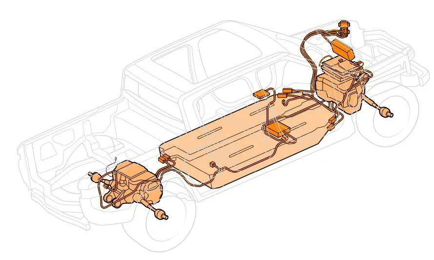

I'm interested in learning more about what part of the HVAC uses HV.
The heater blower PTC does.
https://www.ebay.com/itm/145634265430
Depicted as the orange rectangle above the front motors in the emergency response guide, though I think it's slightly inaccurate here, and should be a little further back.

I think the issue is you've lost the ability to monitor that HV circuit if your 12V is glitching out. Since there's no *good* reason for the 12V issues, I understand why they'd err on assuming the worst case.
