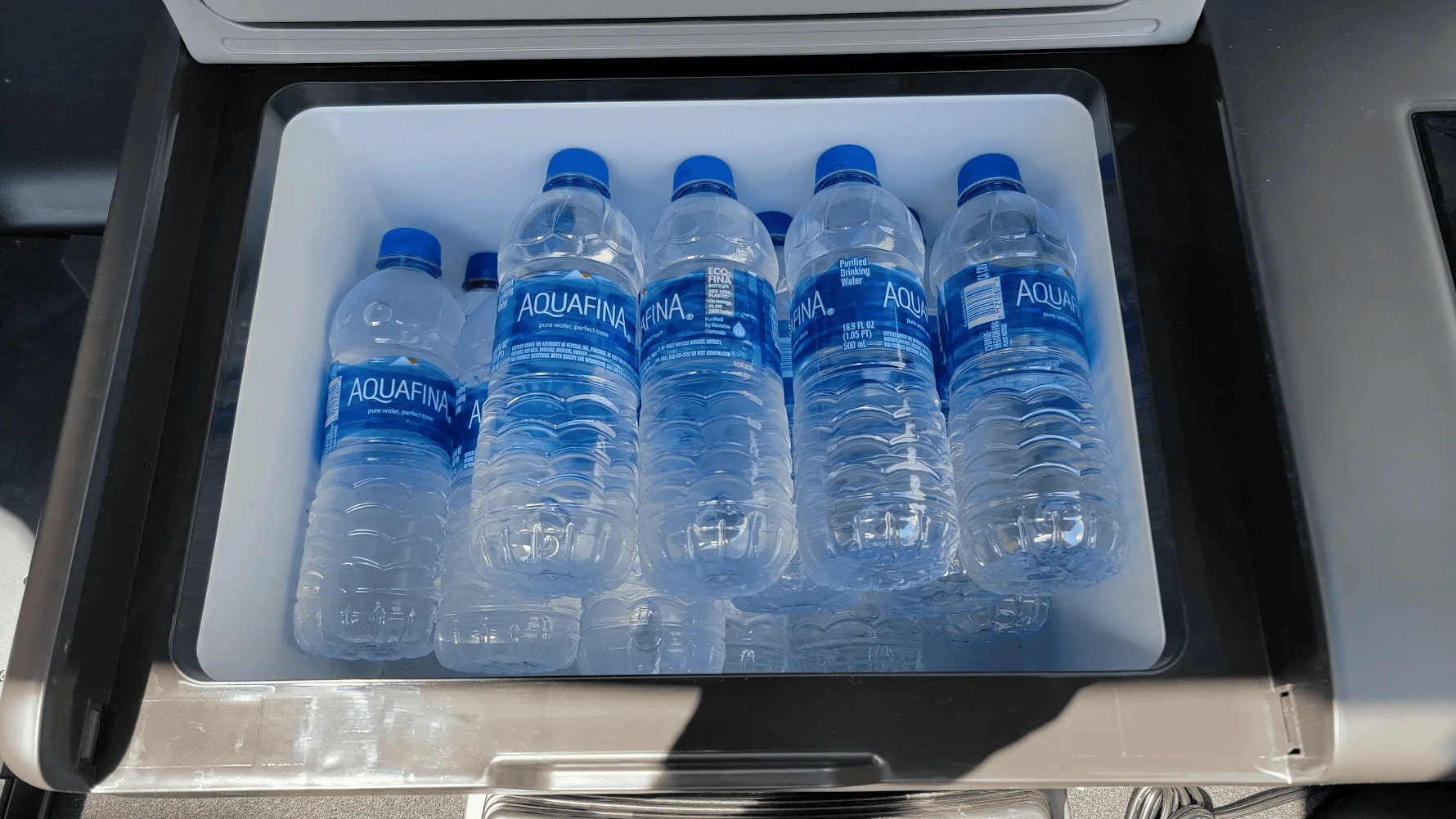

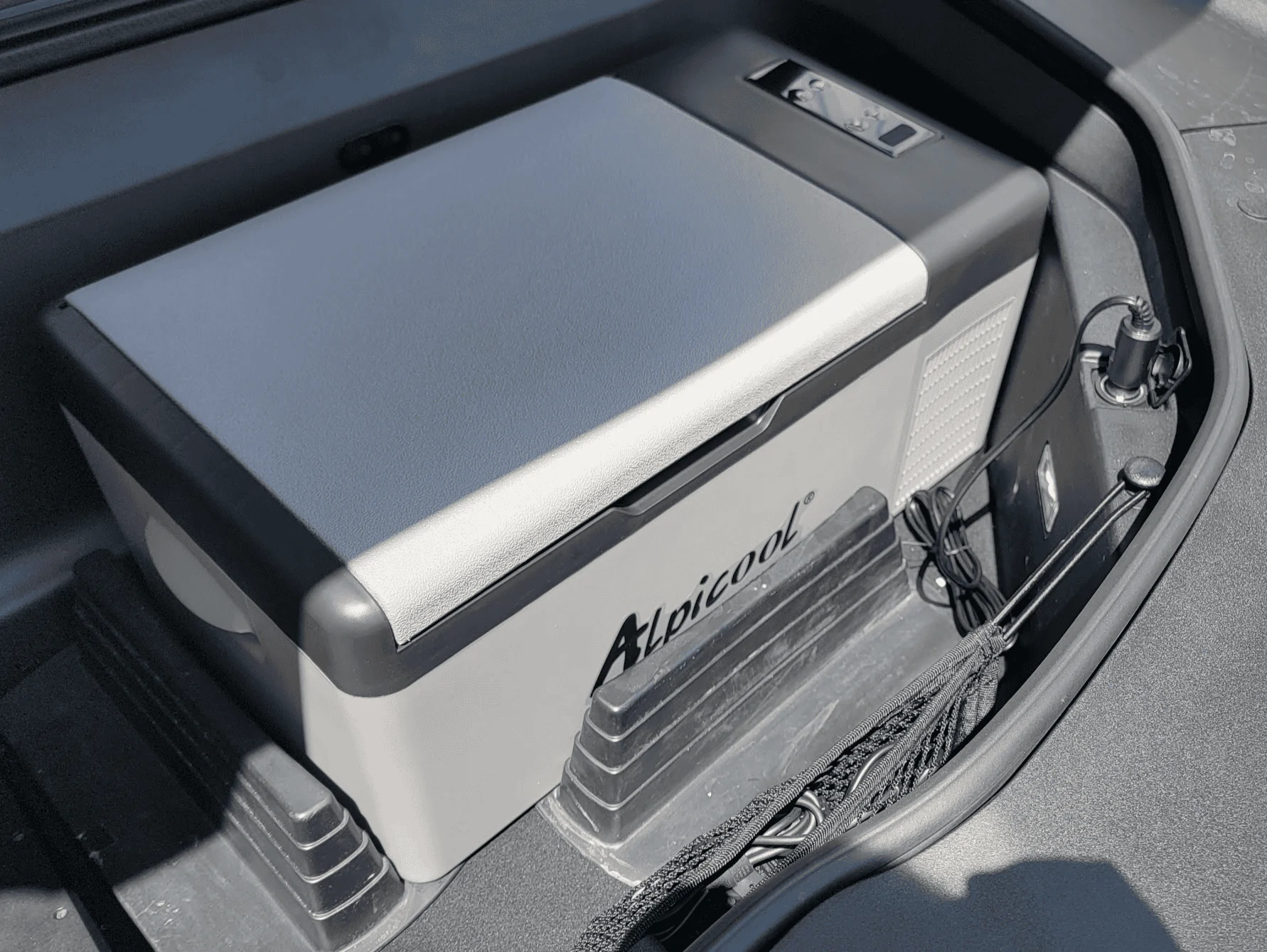

Took a bunch of measurements of the Frunk (like how "frunk" is actually recognized by spellcheck!) and looked for a compressor style electric cooler. I settled on this one and so far so good! Also these are the organizers that keep the cooler from sliding around. Just grab onto the carpet
I do recommend that you fill it up with whatever you want to cool down and leave the frunk open as it will heat it up a lot on that initial cool down. Then put the fridge in eco mode. The 12V system is constantly topped off from the main battery pack so no need to worry about killing the 12V system. I have tested this with the weather being in the high to low 80s during the day and it does get somewhat warm in the frunk but once the cooler is to temp and just maintaining its not bad. Will see how this does in the summer.
Still tinkering around with the settings a bit. I think it needs to be on the medium setting for the voltage sensitivity as the Rivian does not go to like 14 volts like a ICE vehicle does when running. Stays at a constant 12.6 to 12.7 volts from what I have seen.

Have you tested if the 12V outlet in the frunk stays on when the truck is parked/locked?
On my truck the 12V outlets are off when the vehicle is 'off'
Because of the app on my cooler I was able to test this, if the frunk is open it will always be 'on' and the 12V outlets will be powered.
If the 110V outlets are set to stay on, do the 12v sockets follow this behaviour?

Disappointingly it does seem the power to that 12 volt outlet does NOT stay on. Reallyyyyyy dumb when you have a 135kWh battery attached to the truck!
I guess that will have to be a software update. I have not confirmed this 100% but it seems to get warm when I am away for a while. I thought it was always on because I was using my truck soooo much, just assumed it was always on.
Will keep looking into this.
Also will try putting the inverter on to see if that makes a difference.
I went to try and test this and now I can’t get it to turn off in any config so I’m clueless.

I turned on the inverter and the 12v seems to stay on. The cooler was only $220.
Will keep messing with it.

We have one of those types of fridge/coolers only a Dometic. Make sure you have plenty of air availabilty to keep the compressor from frying. We tried ours in the galley of our teardrop, only problem is the galley seals so tight the cooler was not getting enough fresh air and almost fried the compressor. The frunk may be too air tight for it. We've had our for 10 years and love it. They may be expensive but no more buying ice, no more melting ice. We can set ours cold enough to act as a freezer or just as a cooler. There are different brands, with different prices that mainly have to do with the type of compressor they have and how efficient they are.
P.S. put eggs and things like lettuce at the top or they will freeze:).
