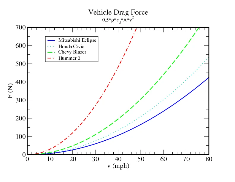

Consider some physics behind this. Looking at the blue curve (Rivian has a low Coefficient of Drag) of an aerodynamic car in this exaple chart, air drag force is under 100 Newtons from 0 to 40. Just to go from 70 to 80, it’s an additional 100 Newtons. You need 25% more energy from 70 to 80 on an aerodynamic vehicle. At 60, you need half the energy, as compared to going 80. Higher Speed has a huge impact on range.
