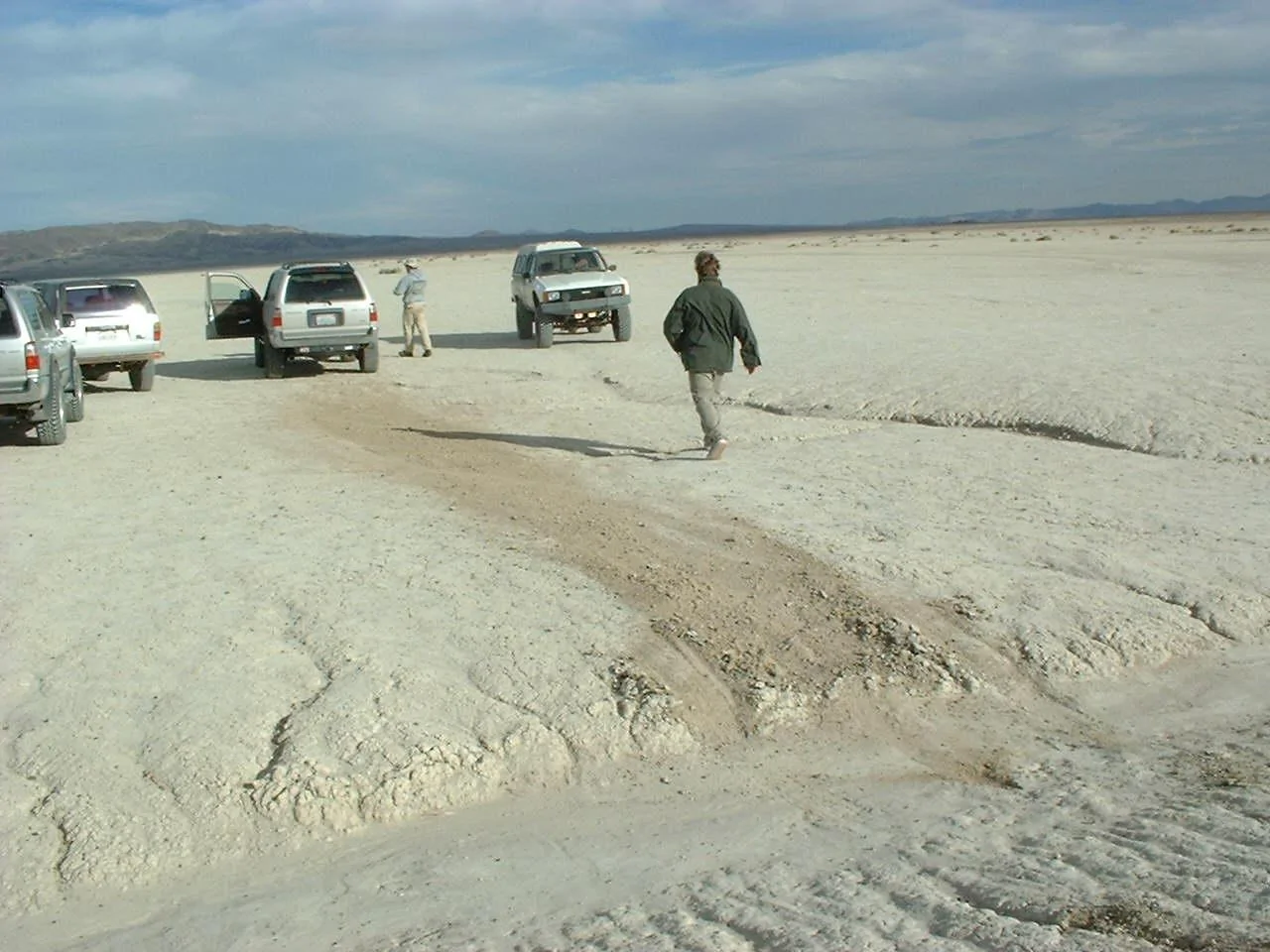

Unrelated but good to note: watch out for those wash-outs in the desert! No one was around so I couldn't offer to pull them out.
Even have to watch the small holes if you're moving along fast, like on a dry lake. I went flying over several one time and the landing angle dragged the hitch lol.
