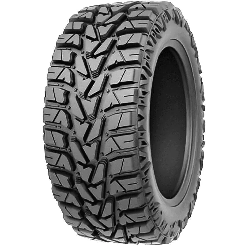

Versatyre MXT/HD LT 285/60R20 Load F 12 Ply MT M/T Mud
I think I'm swapping out the wheels and tires, so these tires might be available if you have an interest in them?. As of right now, they have less than 100 miles on them. Planning to make the swap tomorrow. So, mileage won't go up by more than another 30 miles before they get taken off. I mention it only because your profile says you're in SoCal, so could pick them up and save on tax/shipping, etc. If interested, send me a private message and we'll chat further.
And, they will fit on the stock 20" Rivian wheels, so if you just wanted the more aggressive tire look and use, would certainly be a good fit on stock wheels. With the extra 1/2 clearance due to the smaller 33 1/2 circumference, combined with the stock offset of the Rivian Wheels, these would stay tucked under the fender wells very well with absolutely no rubbing issues.

Edited post again to add that the 33" 275/60/20 inch tires do handle notably better than the stock 34" 275/65/20 inch tires as well. Notably less tire sway and floatiness. Really is a perfect tire size for this truck. Of course, in my own humble opinion!! :). Aside from extreme off-roading scenarios this tire is better in every other way that I can imagine.

Super curious as to what impact to your efficiency/range your seeing with the 60 series? I’ve been thinking same size if and when I finally get my R1T. Reducing to the 275/60/20 puts you at the same overall size as a 275/55/21. Thanks for any feedback
