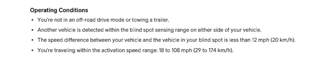

The chime seems to be tied to steering angle. Once you are "In" the turn it'll stop, but leading up to the turn it doesn't seem to be very situationally aware. I'm hoping that as the autonomy system becomes more aware of things like traffic lights, turn lanes, etc, they will implement an awareness for things like turn lanes.
Seems more like a speed correlation to me.
This is true, there is a speed correlation as well. But next time you're at turn play with it. You'll notice that as soon as your steering wheel gets beyond a certain point, the sound turns off. I've played with it lots of times and there's a very specific threshold of steering degree angle where the blind spot quits making sound.
But yes, there is a speed trigger in addition
