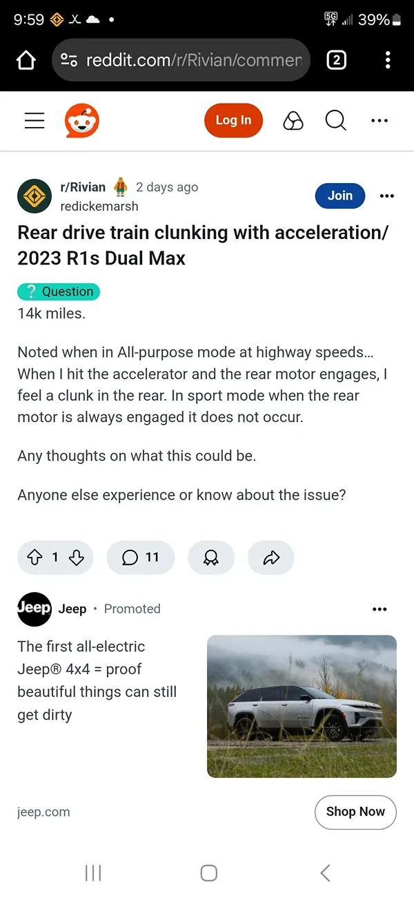

Since 2024.51.01 was released on Gen 1 Dual Motor performance, I have noticed that all purpose engages the rear Motor much more abruptly.
I'm trying to decipher whether I'm having an issue or not.
About 2 weeks ago just before the 2024.51.01 update, I had a turtle mode error and the rear Motor was disabled. I did a reset and it cleared the error and everything seemed to be OK. The update came out the next day, making it tough to pin this on software or timing.
I notice when on the highway at 60+ mph, when in all-purpose.... there is a bit of a thump when the rear Motor engages under higher throttle. I don't remember this before.
If I'm driving in all purpose and engage Snow Mode, the thump hits when the Motor engages. So it's clearly the engagement of the Motor. This all happened right around the update and that turtle mode/rear Motor disengagement.
Sound familiar to anyone else? Has anyone noticed a difference after the update? I posted a similar thread on this before but I didn't word it right or mention the Dual Motor.

I think I’m with you - not sure - but certainly when I now ease off the accelerator on freeways and then re-engage (enough to cause regenerative and then engage the rear wheels) I certainly get what feels like a “jolt” - I’m having the service center look at it just in case, but certainly noticeable now.
