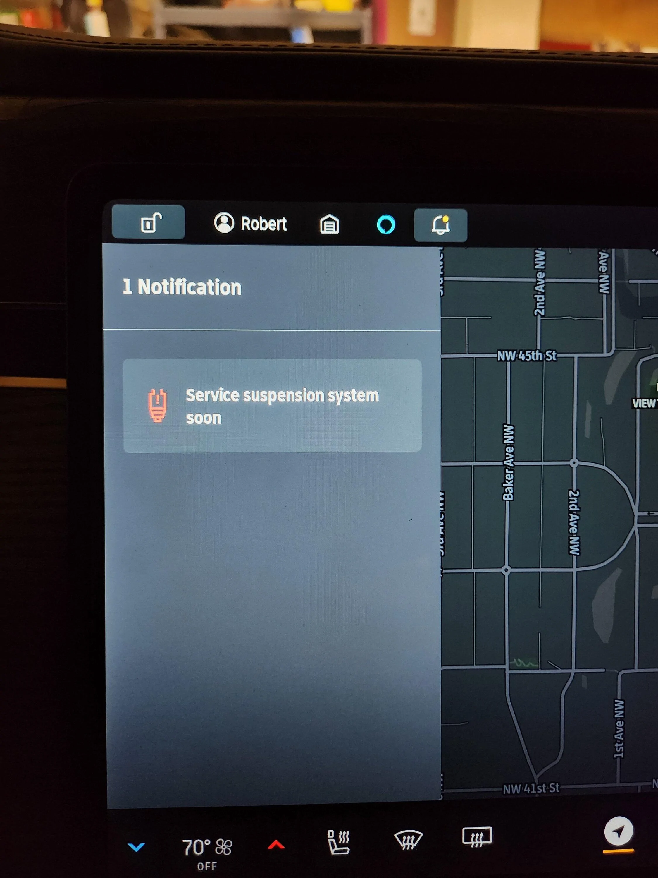

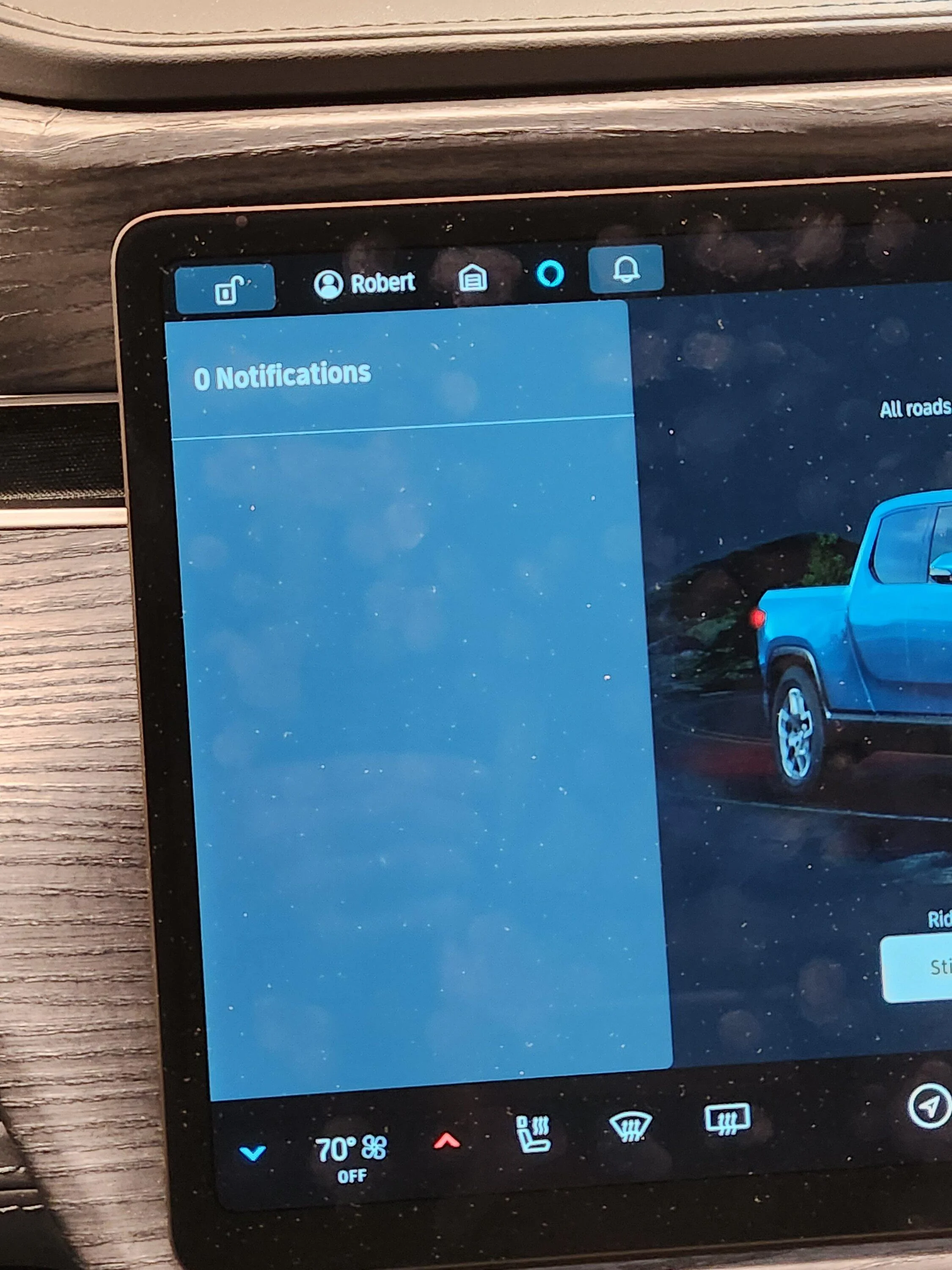

I performed a soft reboot today and the vehicle awoke with the notification that I need to service my suspension. The notification persisted after another reboot. Then upon pressing the brake pedal while in park the message just disappeared. Has anyone else seen glitches like this? Am I in for a nasty surprise in the near future?
Before:

After:
Rivian R1T R1S Dreaded 'Service Suspension Soon' warning disappeared 20221027_170049

I would check the suspension wire harness connectors and make sure they are all fully seated.

I would too if I knew how... Time to do some searching. Thanks for the tip!

This was my issue. I had a service suspension soon message that was intermittent at first and then persistent. The truck struggled to switch from soft to hard dampers and would sometimes do it randomly. Turns out there was a small connector on the harness that was broken, likely from the factory, and once that connector was replaced everything was fine.

I had this exact scenario happen today. After updating to 2022.39.1 my compressor wasn't working. I figured the infotainment reset might help, so I did the soft reset (btw did not help and yes I have read the other thread about the defects in the most recent OTA). Afterwards I received the Service Suspension s00n message. I pressed the brake pedal and it went away. I will be checking all the connectors tomorrow.

There are numerous reports of erroneous error messages. I believe Rivian is still tuning what constitutes an actual error, and these erroneous error messages are a natural artifact of this process. In general, if they go away and stay away after a sleep they are of no concern. Persistent or frequent errors should be reported.
