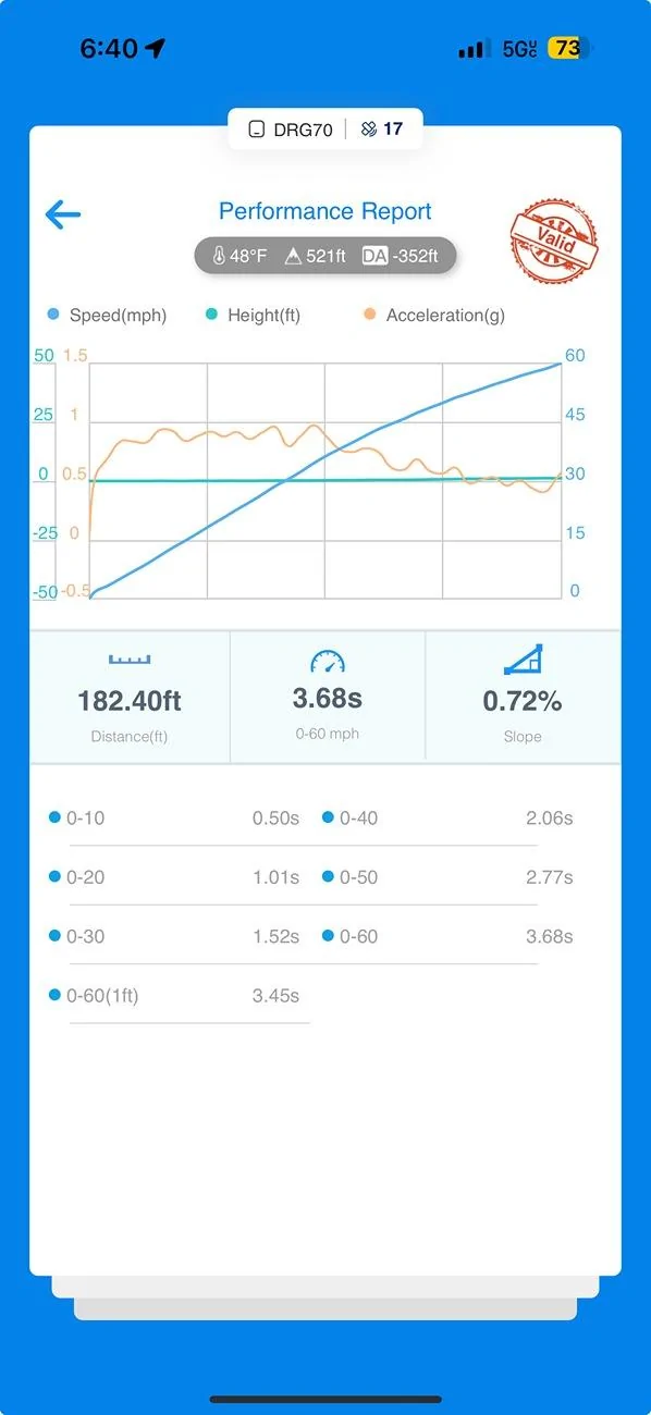

Here is the data I collected for this run: (all my runs were on the latest SW 2024.47.01).
Vehicle: 2023 R1T QM large pack
Cargo/weight: About 450 pounds, including driver
SW: 2024.47.01
Temps: 50F
Winds: <5 mph
Battery Temps: 62F
Motor Temps (Front/Rear): 72F/76F
DA: -426'
Prepped surface: No
Wheels/tires: Factory 21" with factory Pirelli Scorpion AS @ 48 PSI
State of Charge (SoC): 62%
Mode: AP
Suspension: Low
Firmness: Hard
Traction control (High/Med/Off): Med
Notes: First of several. Sort of run what you brung and sort of a worst case scenario. I have been trying different launches and sometimes it seems better to just hit the pedal without braking and sometimes it seems better to brake torque it with the throttle depressed and let off the brake. There seemed to be a bit of hesitation on this run at launch. There seemed to be some wheelspin from the front at 25-30 mph. Tires were likely cold and so was the street.
I didn't have a chance to do many 0-60 runs but focused more on 50-90 and sub-intervals of that range than launches. I'll post more runs as I have time. Basically this run is about as good as well running Model Y Performance would be or a first gen Model 3 long range with acceleration boost if they were at full charge. All in all, I don't fee bad about the run given the low SoC and street conditions.
Rivian R1T R1S Dragy and timed runs - post your data here 2023 R1T QM 62 SoC AP mode cold batteries and motor

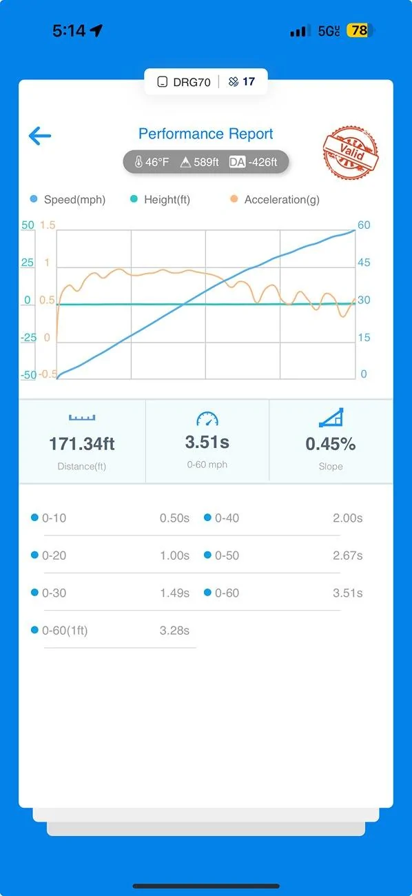

Here is the next run in the series. I basically kept everything the same and ran it in Sport mode. And before anyone says something, I KNOW IT WILL BE QUICKER AT A HIGHER SoC. Most of my driving isn't going to be at a 90%+ SoC so I want to know what it runs 95% of the time I drive it. My Plaid is still stupid fast at 40% SoC.
As you can see, not much quicker in Sport than AP even though the temps have warmed up for the battery and motors a bit. I thought it might be a bit better than it was.
This run would be a MYP but not any version of Model 3 Performance. Even on a bad day, low SoC, they are going to pull you easily. Any 2021+ Model S long range will easily beat these numbers, even with a lower SoC. A Plaid could have 20% SoC and run away from these numbers. Still a fun truck.
Temps: 50F
Winds: <5 mph
Battery Temps: 67F
Motor Temps (Front/Rear): 90F/94F
DA: -426'
Prepped surface: No
Mode: Sport
Suspension: Low
Firmness: Hard
Rivian R1T R1S Dragy and timed runs - post your data here Sport 62 SoC cold

If you have the 21's that's where your slower times come from. Those tires aren't grippy enough.
That is part of it, but I'm not getting massive wheel spin either. Might be more of a factor at higher SoC. I am basically baselining the truck right now. I know the temps and conditions aren't ideal, but I am not looking for ideal as 99% of the time, I won't be on the track and I want to know how it will perform in every day conditions. So far good, but not amazing. I am really trying to understand the impact of the different drive modes and how much the impact acceleration.
Erik+
Erik
Sep 2, 2024
193
231
Long press TC to turn it completely off. Your second effort did not specify TC.

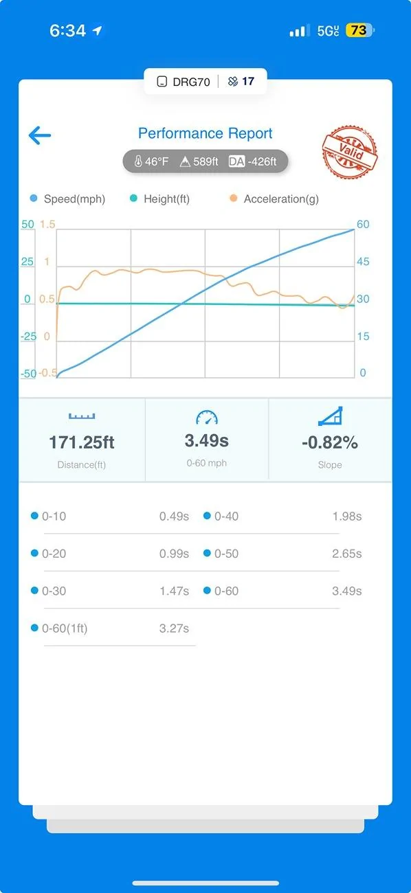

I ran a bunch of runs back to back to back in Sport mode. SoC was falling as temps were coming up. I posted the specs for the fastest run. I had 4 almost identical runs in a row; 3.51, 3.51, 3.49 & 3.51. This truck is nothing if not consistent. I had one run that I think might have been a bit quicker, but for some reason, Dragy didn't capture it.
Temps: 46F
Winds: <5 mph
Battery Temps: 77F
Motor Temps (Front/Rear): 130F/144F
DA: -426'
Prepped surface: No
State of Charge (SoC): 57-58%
Mode: Sport
Suspension: Low
Firmness: Hard
Rivian R1T R1S Dragy and timed runs - post your data here Sport 57 SoC warm

Here was my last 0-60 AP run that was valid. Things were warmed up. The time is identical to what it ran when it was totally cold. Winds picked up a tiny bit.
Overall, what has been impressive is how consistent it has been as the SoC has dropped. I just wish it was quicker while doing it. It is very solid for maintaining its quickness at least 0-60. I did one last Sport run but I accidentally cleared it while in the middle of the run. I was at a high 40's SoC. It had shown a 3.52 for that.

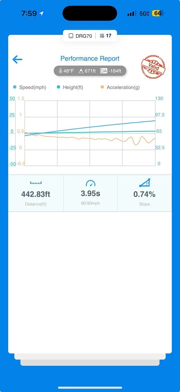

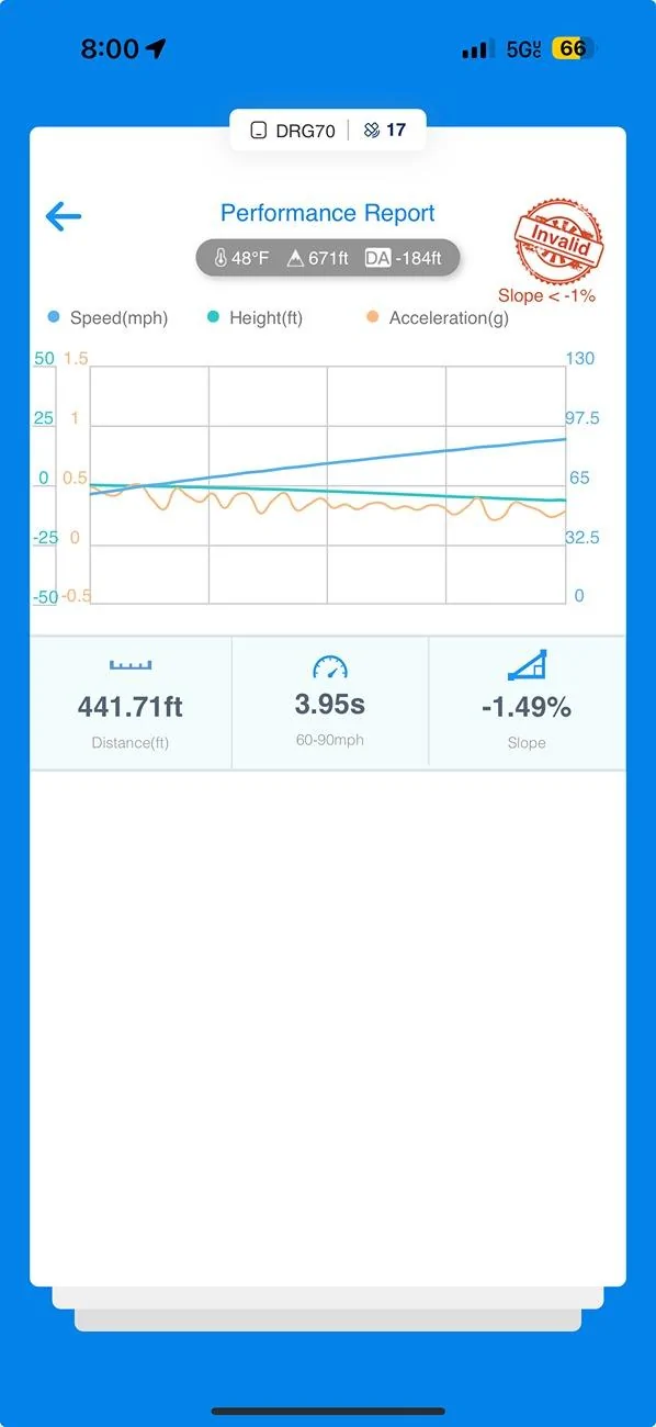

I ran some 60-90 Runs. Actually I started at 50 but I am posting the 60-90. First will be AP mode and second will be Sport mode. Keep in mind the 0-60 runs weren't linear with the faster ones. They were intermixed so the battery levels may be high or lower depending on when they were run.
For reference the 50-90 mph times were identical for both at 4.82 seconds. I'll have to get the nod slight to the Sport mode as a tie breaker as the ground favored the AP mode a bit. It wasn't a huge difference and the Sport mode had the warmer battery and batteries but just a tiny little bit less charge.
Just a thing to note. My SoC was about 10% less than when I made runs yesterday. It has impacted the times for sure. My 50-70 times today were anywhere from .1 to .2 seconds slower. Yesterday AP was definitely faster 50-70, today at the lower SoC they were tied and the power gauge wouldn't go above about 7/8ths no matter which mode.
An interesting factoid of comparison, I looked up some of my runs for my 2022 Model S long range. typically ran 50-70 in 1.2 seconds and just over 107' to do it. My best R1T run so far was 1.8 seconds and 164'. My Model 3 LR with boost does typically in 1.75 & 155'. For both Teslas that was on a warmer day and with about 70% SoC. My Plaid runs are on another fun and I think the 50-70 runs were about .8 seconds.
So my lessons learned so far are don't run any Teslas that are a performance model as they will take you to Gapplebees. You likely will beat a MYP but you better be at a high SoC and don't run over 100 mph in Mexico. If you see an M3 LR, if they don't have boost, you'll be quicker (but not faster), if they have boost and anything over 50% SoC, they are taking you to Gapplebees as well.
My M3 LR w/boost is a great daily driver. It isn't insanely quick like the Plaid but does have a high fun to drive factor. The R1T mirrors it in a lot of ways considering it weighs about 60% more. Honestly, if the Gen 3 is only a little bit quicker than my Gen 1, it won't be worth upgrading unless they do some amazing stuff. I still wish it was a bit quicker from 50-80 as my initial perception that it lays down at about 50-60 were spot on. It pretty much mirrors my 1st Gen M3. My 2nd gen 3 performance will just run away and hide.
Still love my truck and will make some more runs at a higher SoC when I can more easily run the energy down. There is no way this truck is hitting anywhere near 3 seconds flat 0-60. It just isn't happening. I could put drag slicks on it, have the SoC at 99% with a warm pack and motors and it might run a 3.15-3.2. Which would be good but not what they claimed. Traction is a bit of an issue with my current runs but it isn't costing me a lot.
SW: 2024.47.01
Temps: 48F
Winds: 4-7 mph
Battery Temps: 67F
Motor Temps (Front/Rear): 135F/158F
DA: -184'
Prepped surface: No
State of Charge (SoC): 57%
Mode: AP
Suspension: Low
Firmness: Med
Rivian R1T R1S Dragy and timed runs - post your data here AP 60-90 warm
SW: 2024.47.01
Temps: 48F
Winds: 4-7 mph
Battery Temps: 70F
Motor Temps (Front/Rear): 140F/163F
DA: -426'
Prepped surface: No
State of Charge (SoC): 56%
Mode: Sport
Suspension: Low
Firmness: Med
Rivian R1T R1S Dragy and timed runs - post your data here Sport 60-90 warm

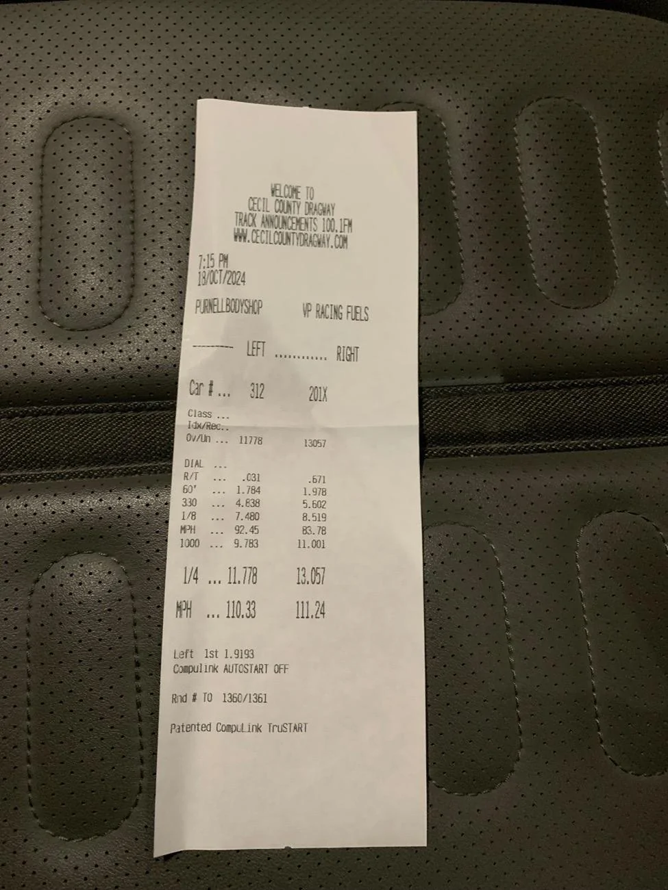

I had my ā€˜22 R1T on OEM 21s at Cecil County Dragway MD a couple months back. Itā€™s a Quad motor with 34k miles on it and it was about 55 deg F outside and at around 100ā€™ above sea level. The truck was at 74% SOC when I arrived at the track. The frunk and gear tunnel were full of IT computer gear (as they always are; itā€™s my work truck); Iā€™d estimate about 350 ish lbs of gear plus I weigh 175 lbs. my truck is equipped with the full size spare option too. I was in Sport Mode and stability control off. No brake boosting - I floored it when the last yellow turned off and I jumped out of the hole with mild wheel spin then immediate hook up. Hereā€™s my first pass (Iā€™m car #312 on the left):
Rivian R1T R1S Dragy and timed runs - post your data here IMG_7304
They do a ā€˜street nightā€™ a few times a month for $25 race all you want. It was crowded and I only made two passes just to see what it would do. My second pass was nearly identical to the first (it was 0.01 sec slower). My guess is that Iā€™d probably have gone two or so tenths faster if Iā€™d have been at 100% SOC and had removed all my gear plus the spare tire. This is a fast machine.

Those are impressive times considering. SOC and the fact that he is running the 21s. 3.5 sec 0-60 is damn fast for that setup at that SOC.
even at 90% Iā€™d want to see that battery toasty at like 85F to ensure max power is available but like OP said looking for real world numbers and the real world numbers are impressive if you ask me.
