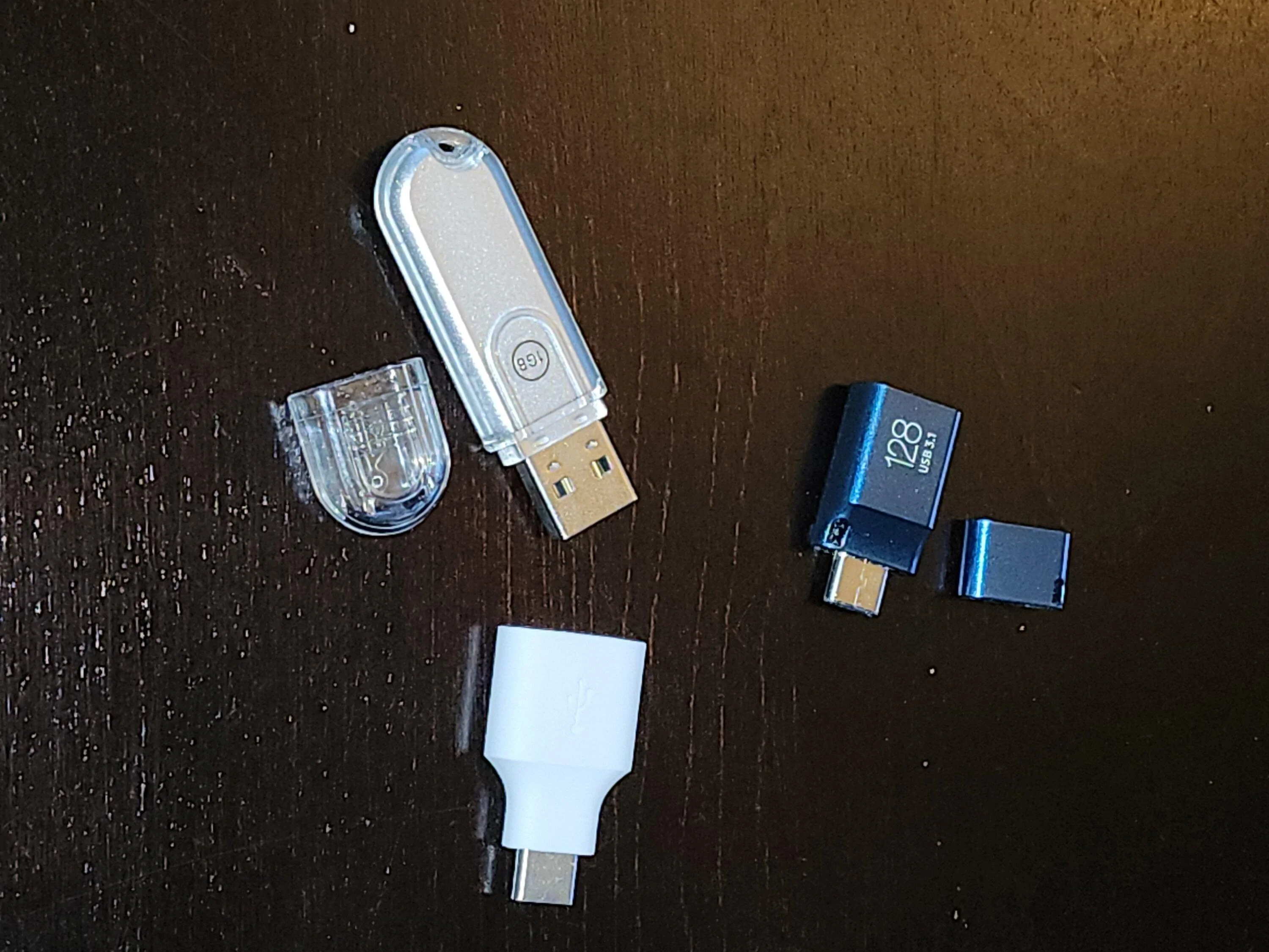

PSA: You can use old USB-A style thumb drives with a USB-A female to USB-C male adapter. I successfully downloaded a gear guard video to an old 1 GB thumb drive.
Rivian R1T R1S downloading Gearguard video to USB C 20221121_075540
I have tons of USB A style drives lying around, so a cheap adapter frees me up from worrying about leaving an expensive thumb drive with the truck at all times. As a bonus I hope Rivian eventually supports playing mp3s from the thumb drive. Maybe I'll have a dedicated USB A thumb drive for each genre of music I like. I hope I can plug them all in at once, and press a button on the screen to cycle through them. Just assign a number 1-6 to each port. 😉

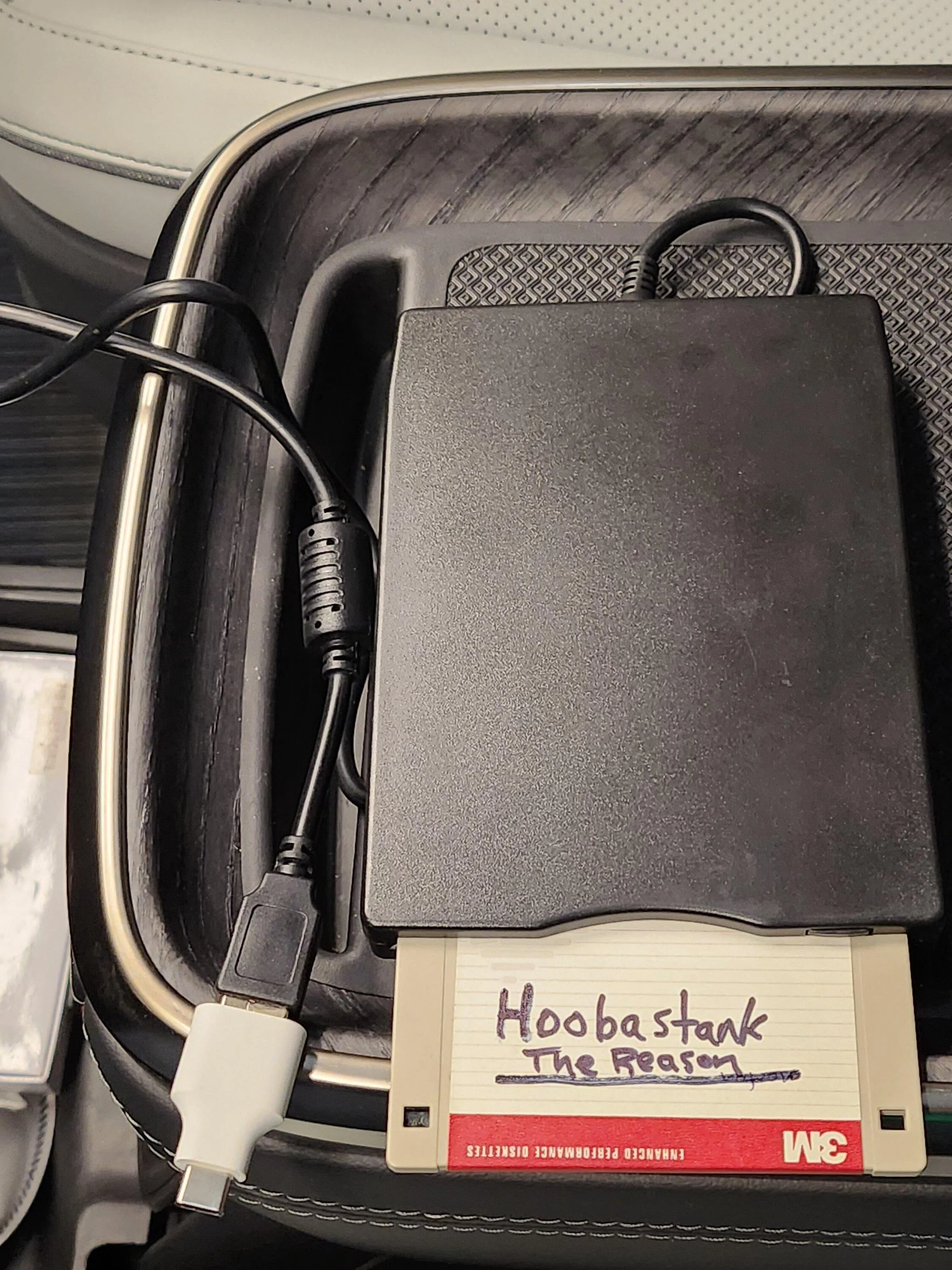

So, a full drive of each of the following:
  • Spin Doctors
  • Insane Clown Posse
  • Smashmouth
  • Nickleback
  • 30 Odd Foot of Grunts
  • Hoobastank
Rivian R1T R1S downloading Gearguard video to USB C 20221121_163738
