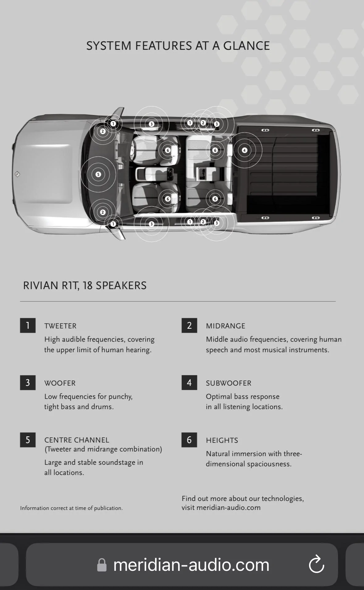

As others have noted the door speaker in the front only has a woofer for bass tones. No midrange or tweeter. The rear door has all three. The front doors don’t require tweeters or midrange drivers as there’s several facing you from the front dash and a-pillars. If you’re not listening to a bassy track or just listening to a podcast or news you likely won’t hear much out of the front door speaker.
Meridian schematics attached
Rivian R1T R1S Door speakers not putting out much sound... normal? IMG_2485

So help me out the speakers labeled as “Heights” they do what?
