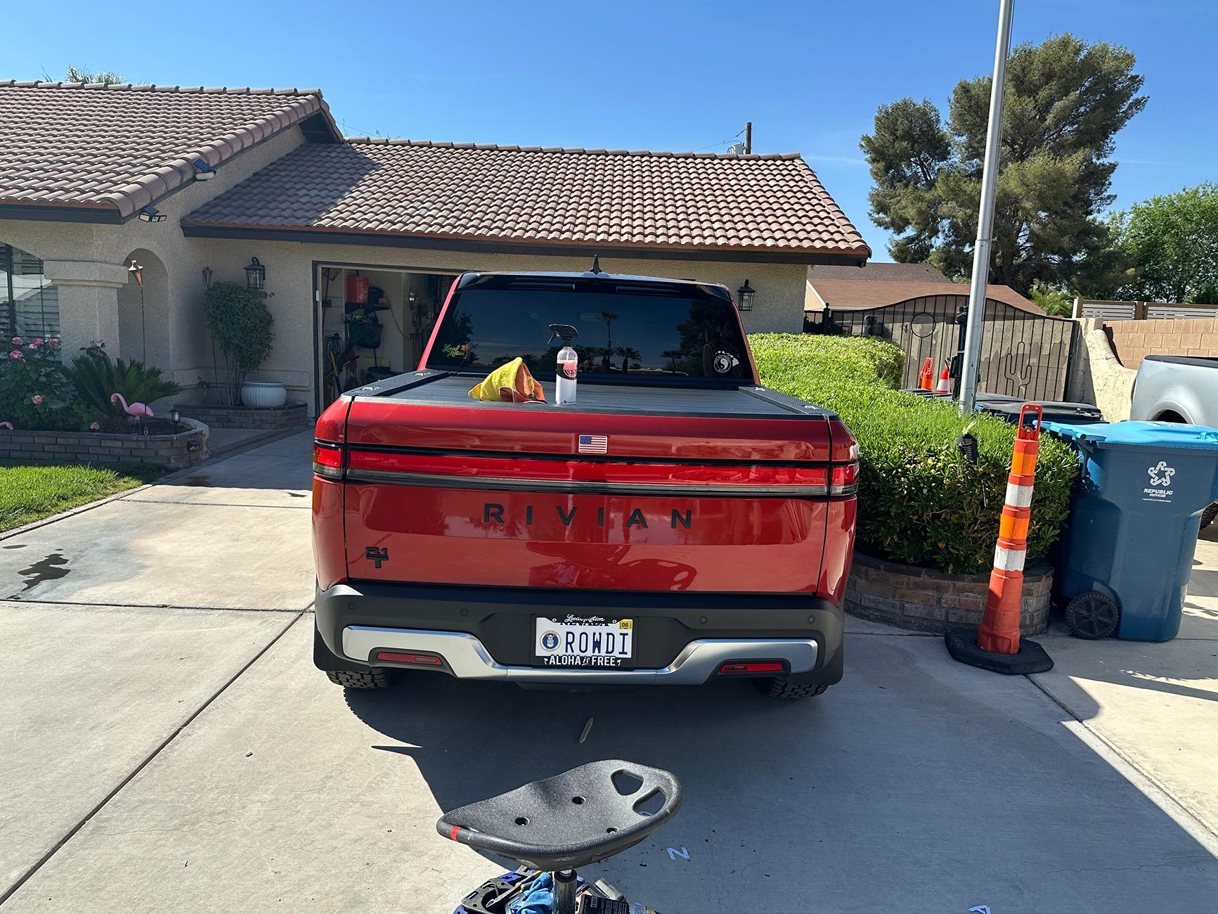

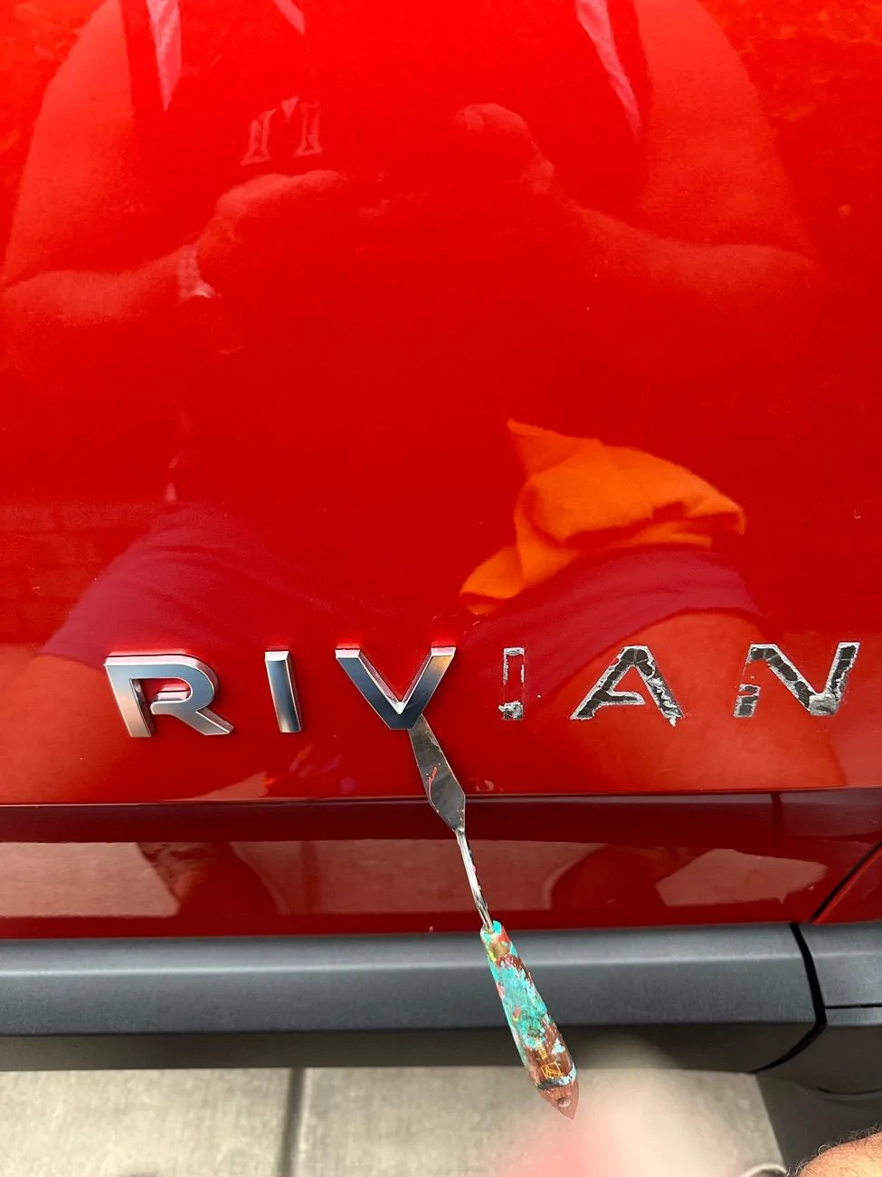

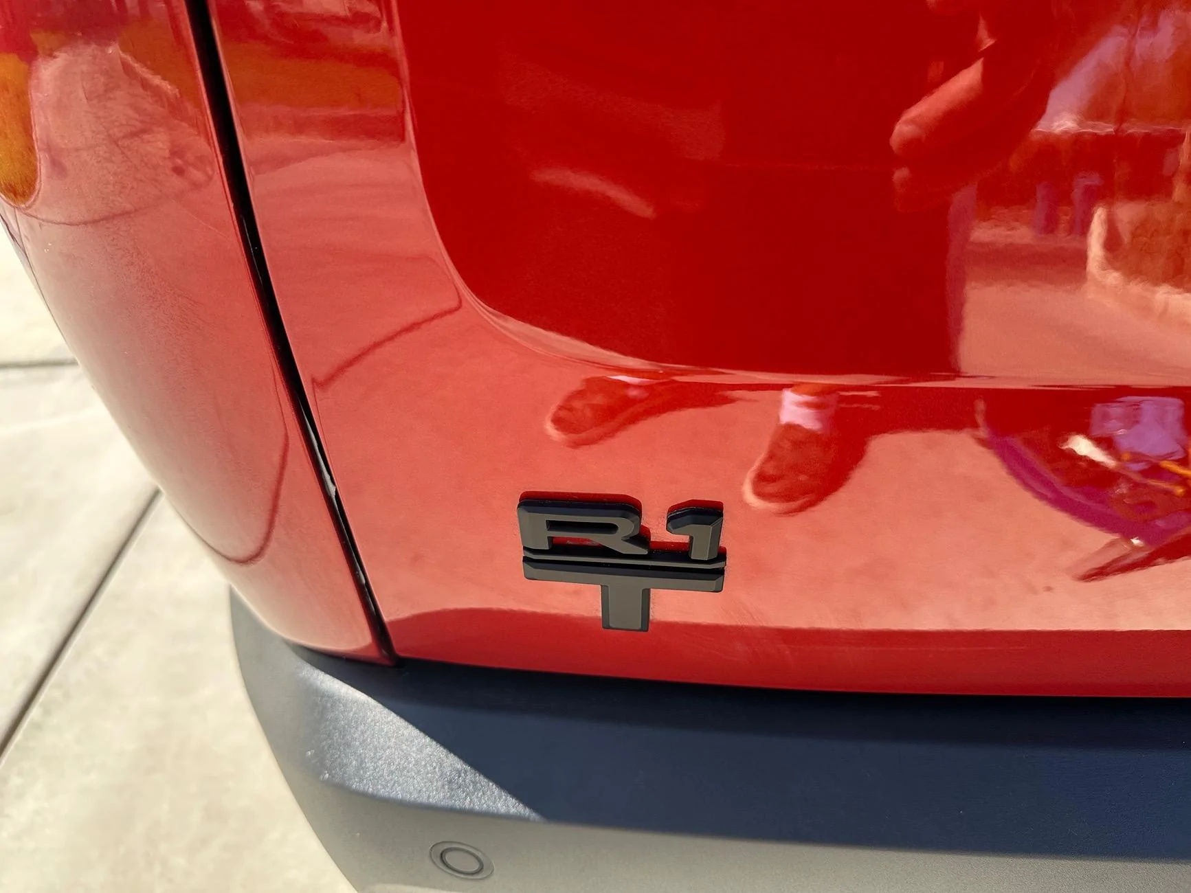

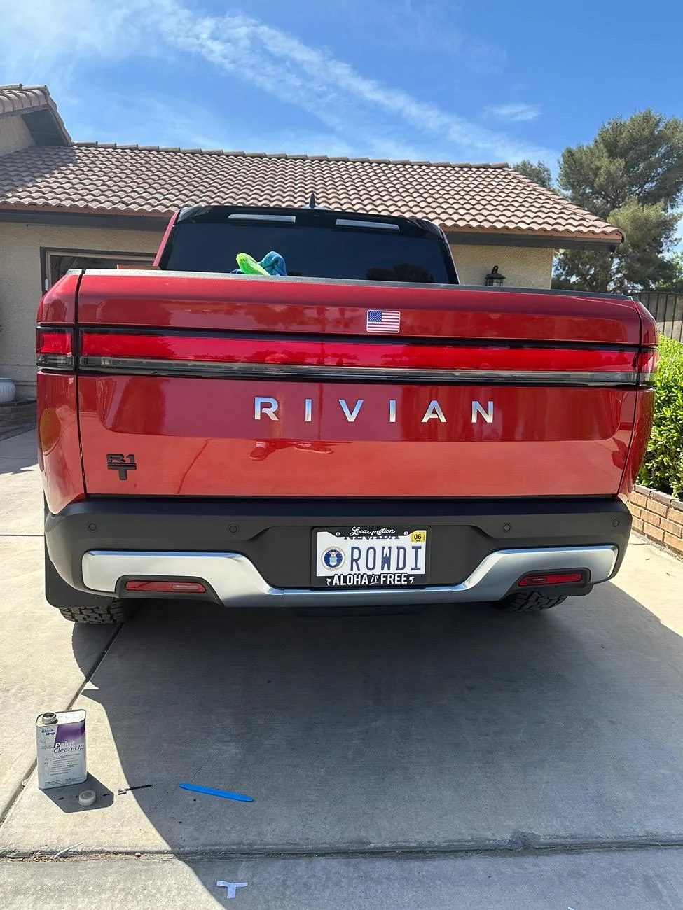

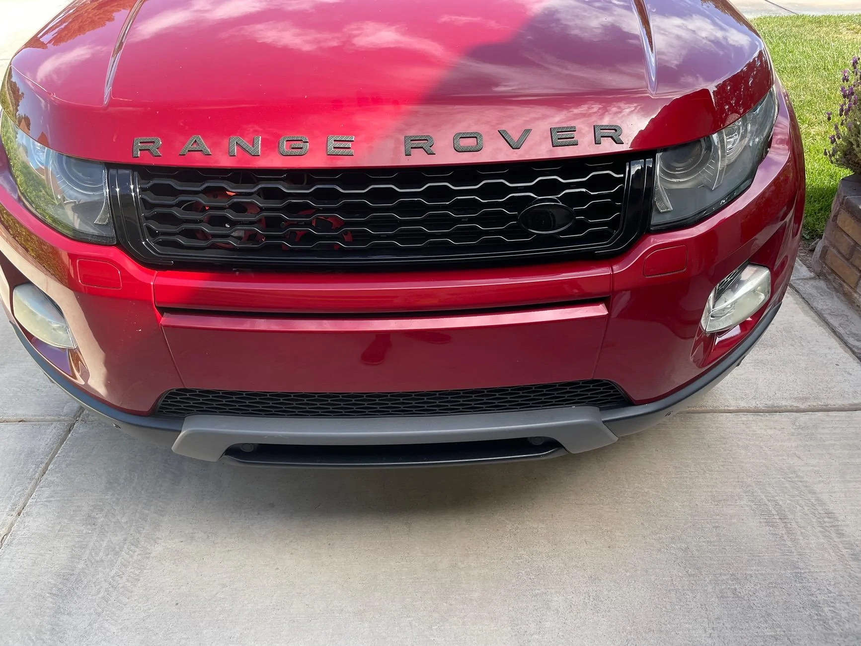

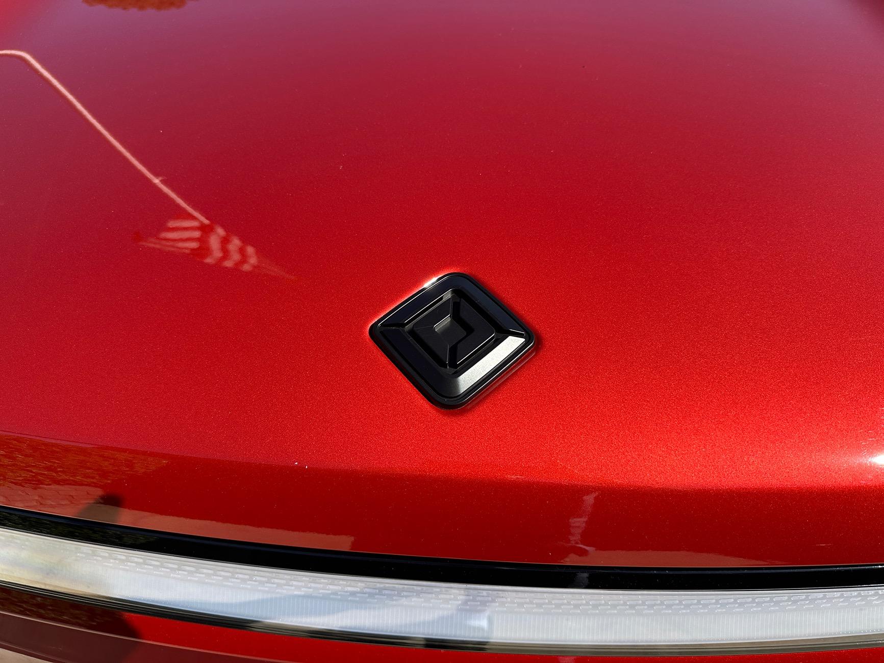

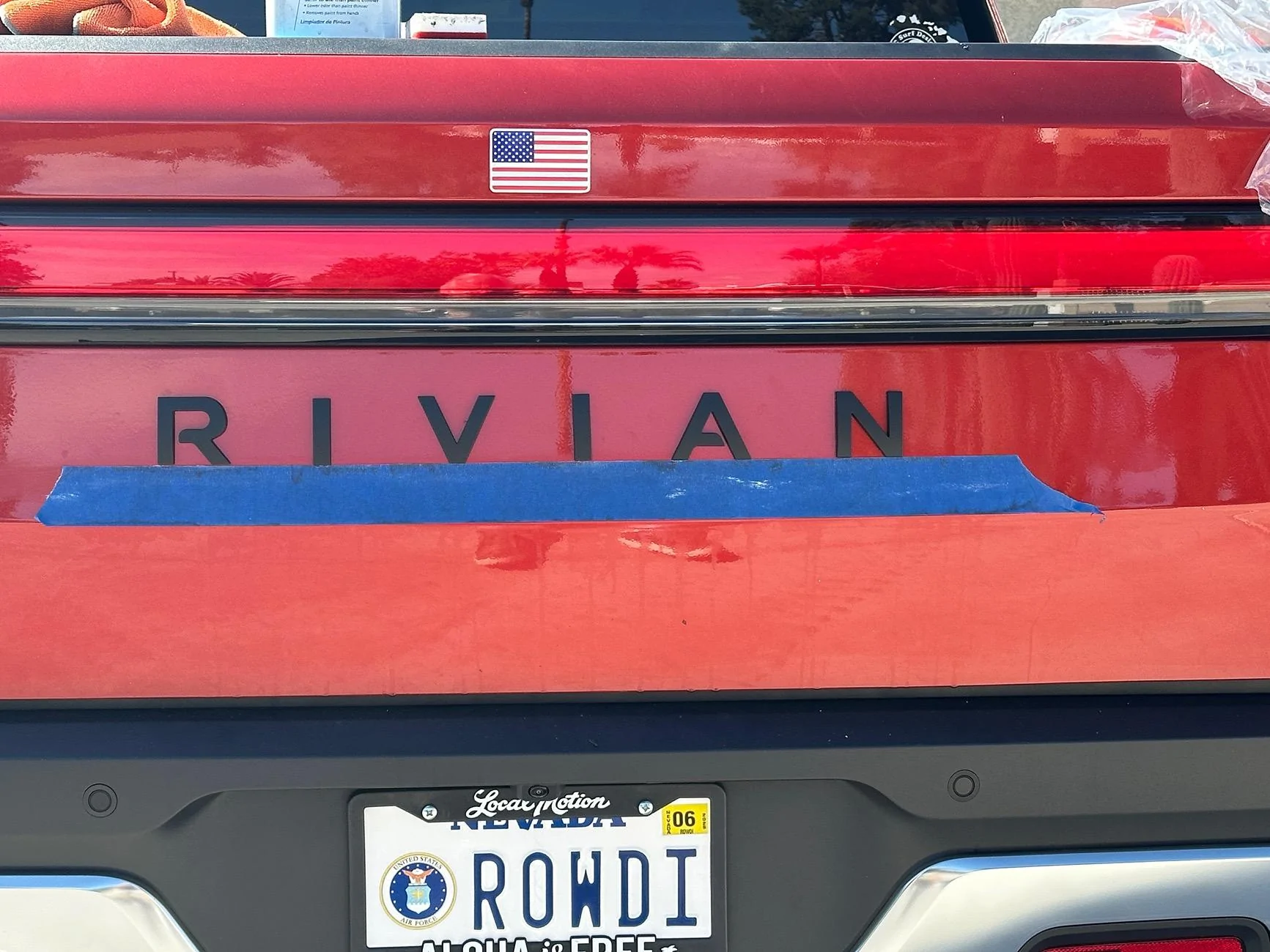

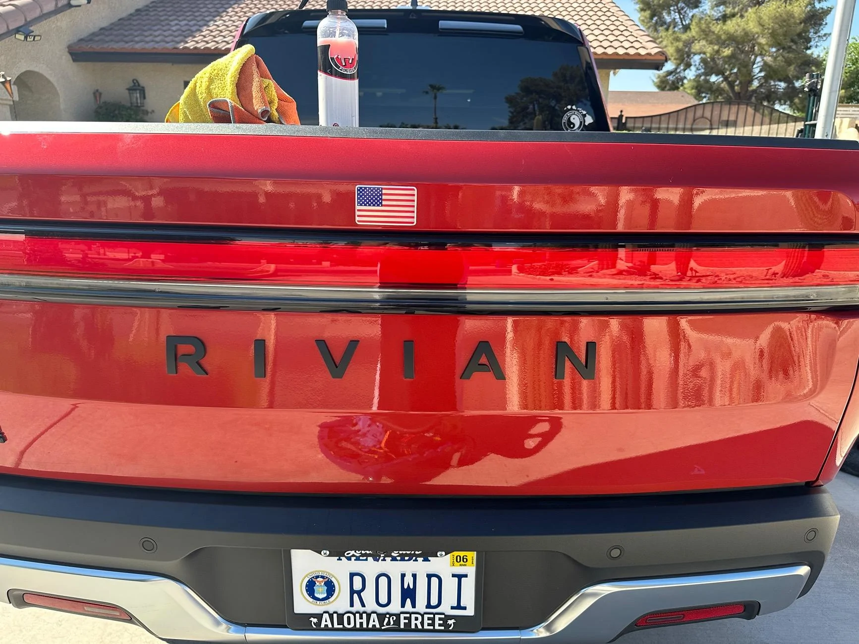

I know. But it's what I had and I've done this before on my range roverscarbon fibre so far all damage free. All I got left is the rear Tuesdays job. Lol

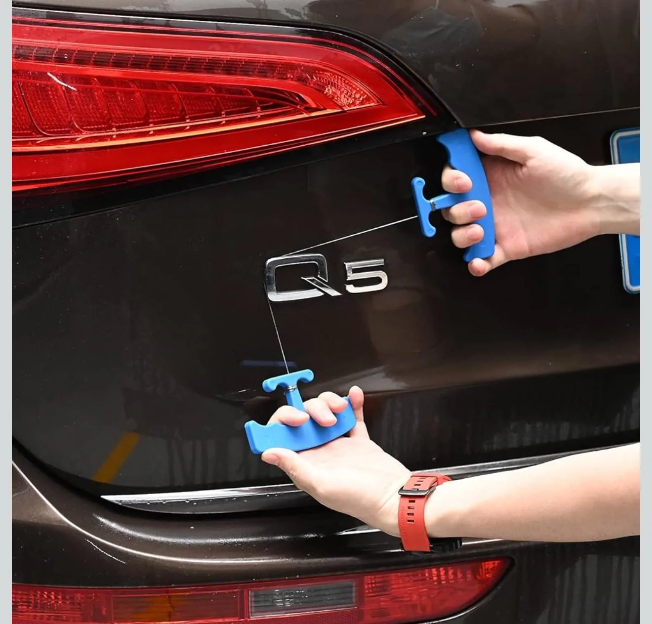

They make adhesive remover and thin filaments to get those off easier without the trowel you're using to pry them off.

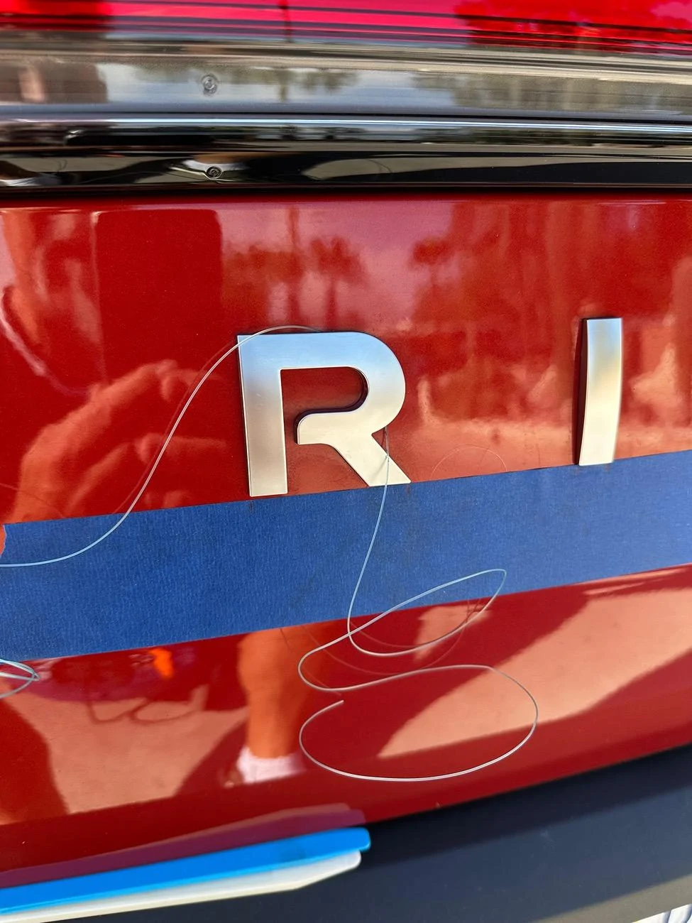

Agreed. That’s just the absolute worst way to do this. Spring for the $10 decal removal wire. Much safer and would probably cut removal time in half.
Rivian Doing a thing. {filename}
this ☝ or finishing line.

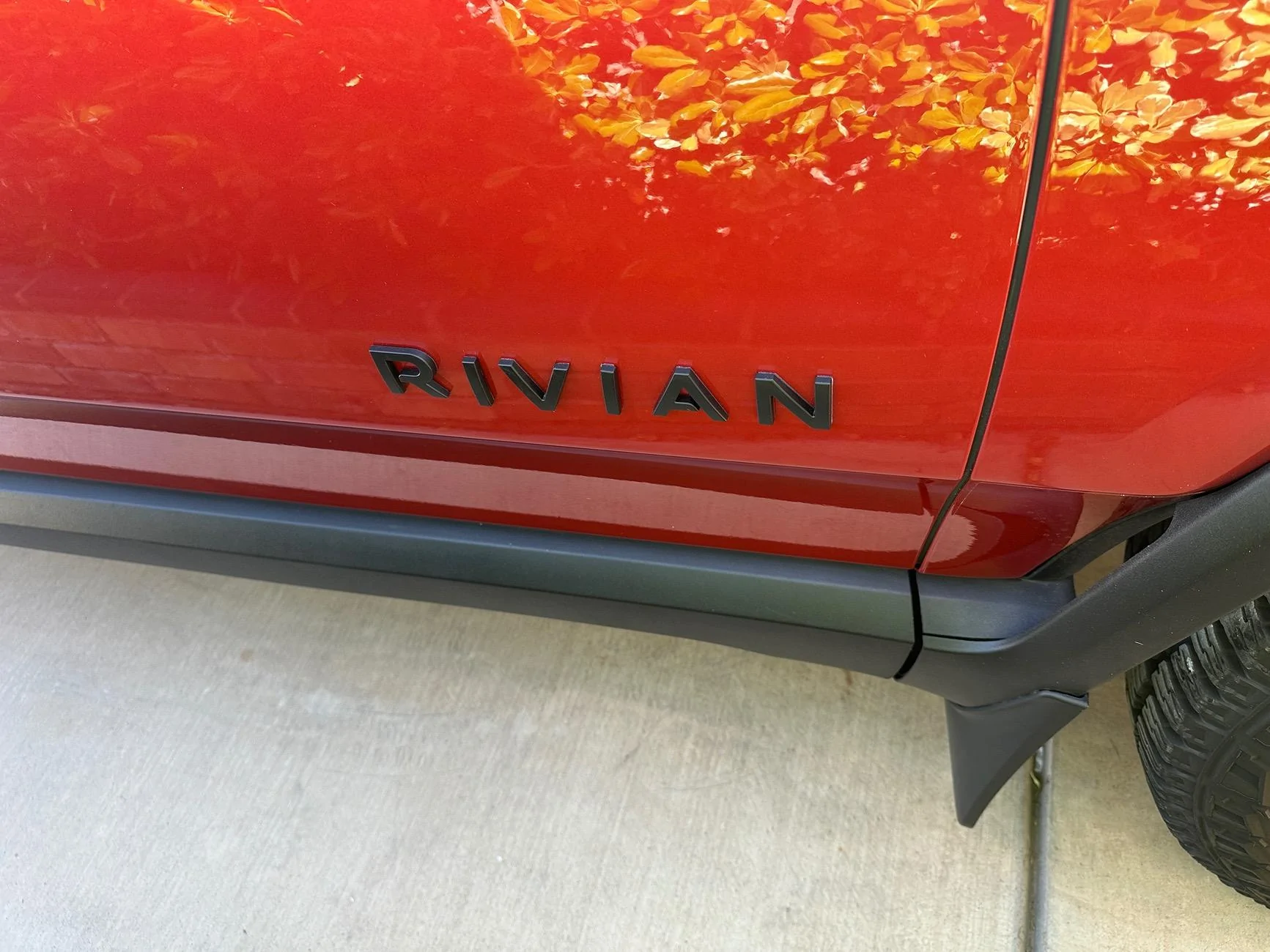

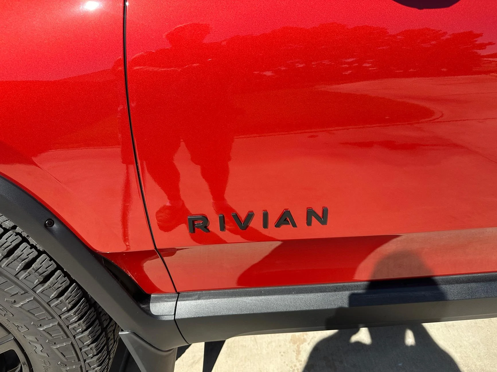

Or even good ole fashioned floss.

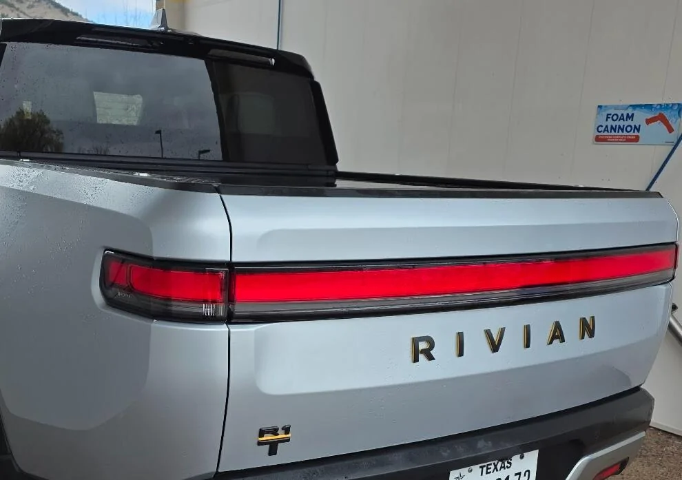

But, OP, the black emblems on the red look great! I blacked out my LA Silver.

Yikes! If you're going to pry it off, use a plastic tool. But fishing line-either braided or mono will do a better job and it can't scratch the paint.
it comes with the AO kit lol
