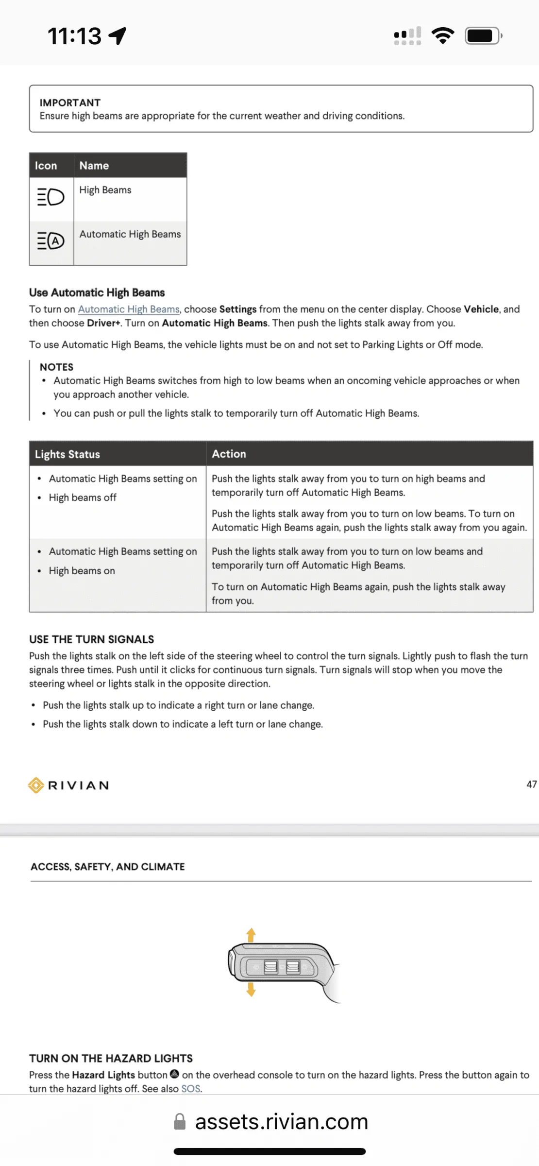

I don’t. The manual says to go to Settings —>Vehicle—>Driver+ and enable it there - but no such option appears on my truck.
That is on the newest software, which hasn't been pushed. On the older software, you still have it. Push the left stalk forward and hold it for a few seconds while going above the activation speed.

I think the change in the most recent version is to have an option for them to be "always auto".
We definitely have auto high beams on 2022.11.2. You press and hold the stalk forward until the dash indicator shows the highbeam icon with an A in it.

Ah, OK - I haven’t received the .15 update yet. Although I did get the 2022.11.2 update again this afternoon (I was already on 2022.11.2).
