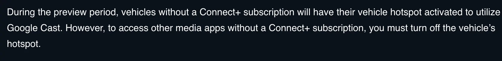

As a side note - I don't yet have the update but based on the wording, it appears that the restriction only applies to casting. It seems as if Rivian WILL allow the built in Youtube app to work on external hotspots. Which, as far as I can see, would have no valid reason to be restricted.
Rivian R1T R1S Discussion - Why Can't I Use Chromecast With a Hotspot? Screenshot 2024-12-18 at 1.46.31 PM

No connect+, no built-in media apps like spotify. Not media apps on your phone. They are allowing chromecast to use data but won't allow the other built-ins without a connect+ sub.

Interesting. Is that second sentence a roundabout way of saying that non-Connect+ access to media apps requires that the car be connected to Wifi for its internet connectivity, and in that case it can't be a hotspot since it can't be both client and AP at the same time?
Exactly! It would likely be very easy for them to enable Chromecast over external Wi-Fi network. But the problems that come with doing that far outweigh any potential benefit. (Sketchy public Wi-Fi, signal strength, randos being able to cast to your screen, varying firewall rules on public Wi-Fi, etc)
And yes, exactly! That has been well publicized that all of the music streaming apps can work without a subscription if you use your phone as a hot spot. And it seems that the native YouTube app will also be in that category? But yes, Chromecast runs into issues because it requires both a locally connected Network and internet at the same time
