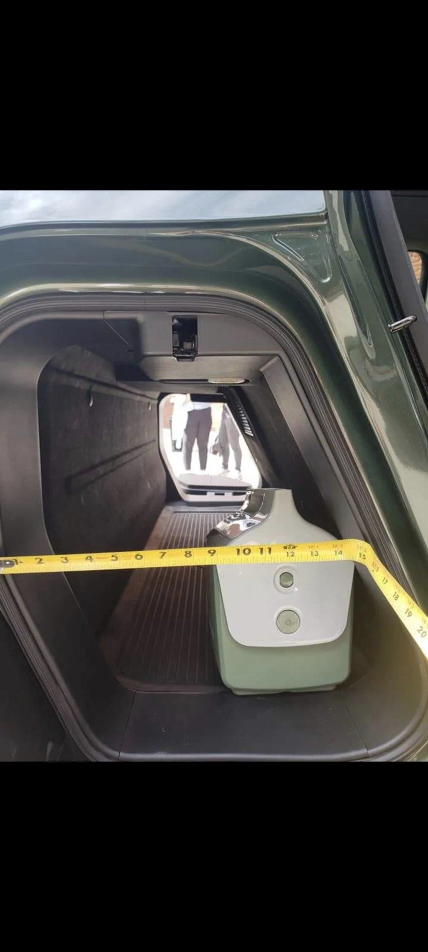

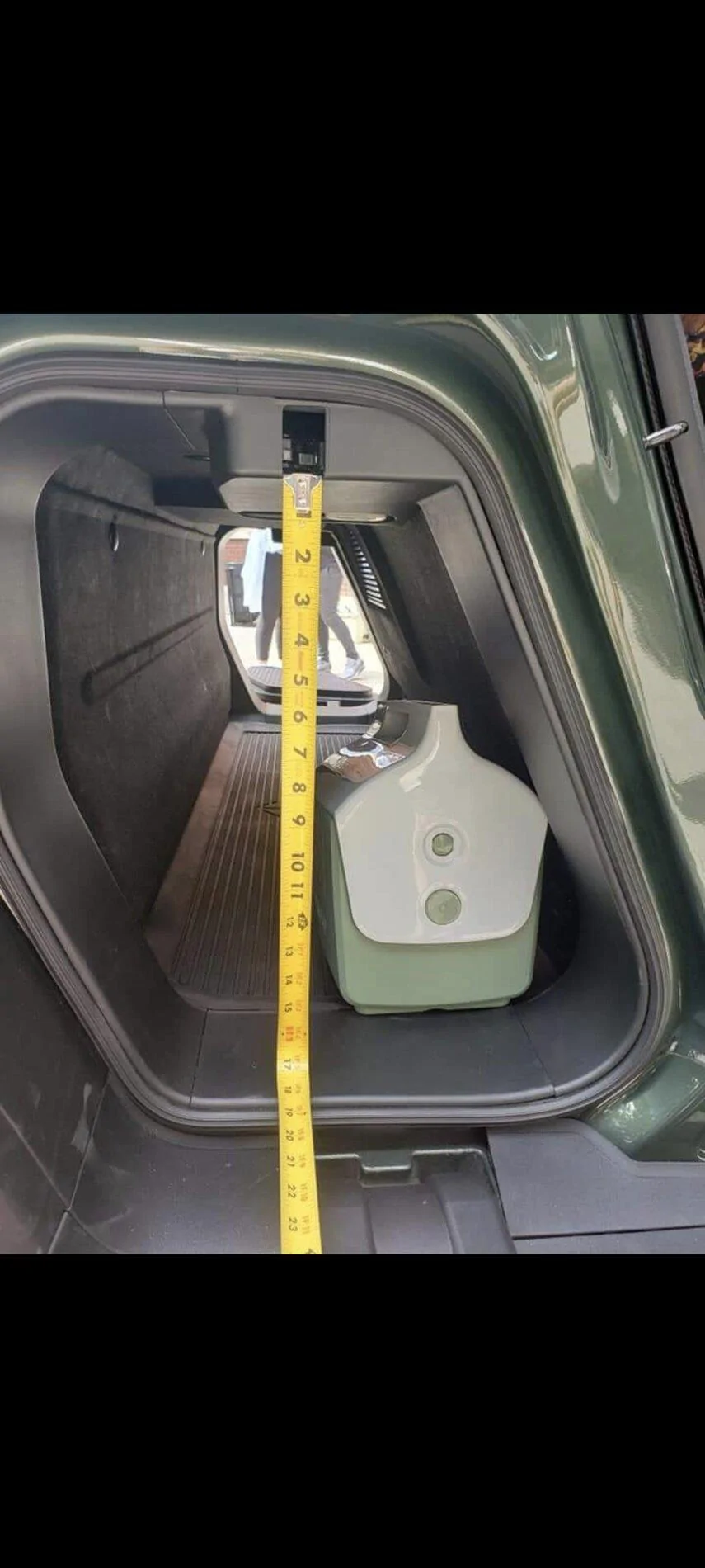

@Babbuino that awesome think you! If you still have access to that truck can you do the same for the floor tray in front of the front seat?
Sorry, it wasn't my measurement, but from a Facebook post. I'll keep an eye out if I see any. I'm in FL, so it'll be a while before I get to measure anything ?

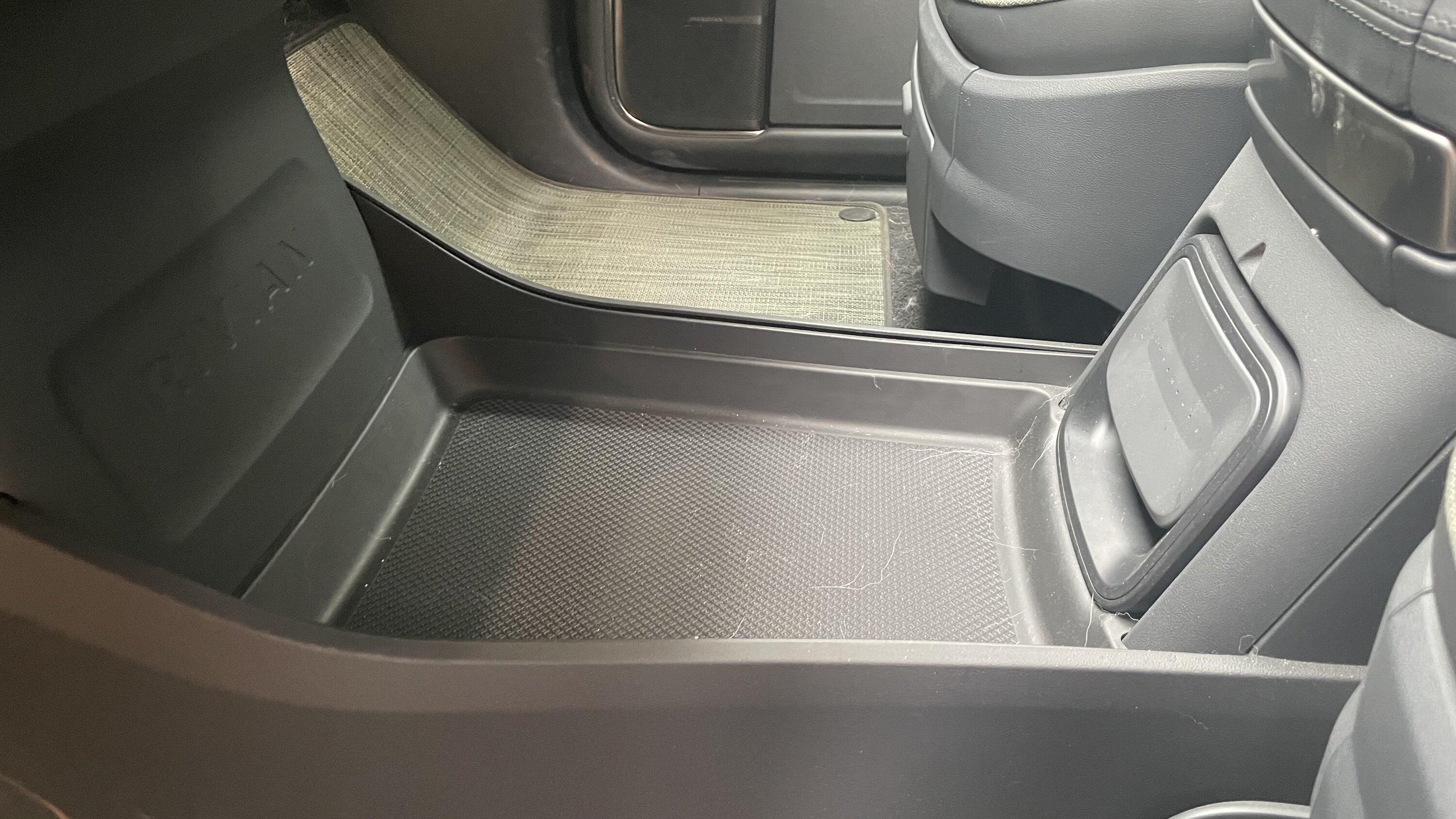

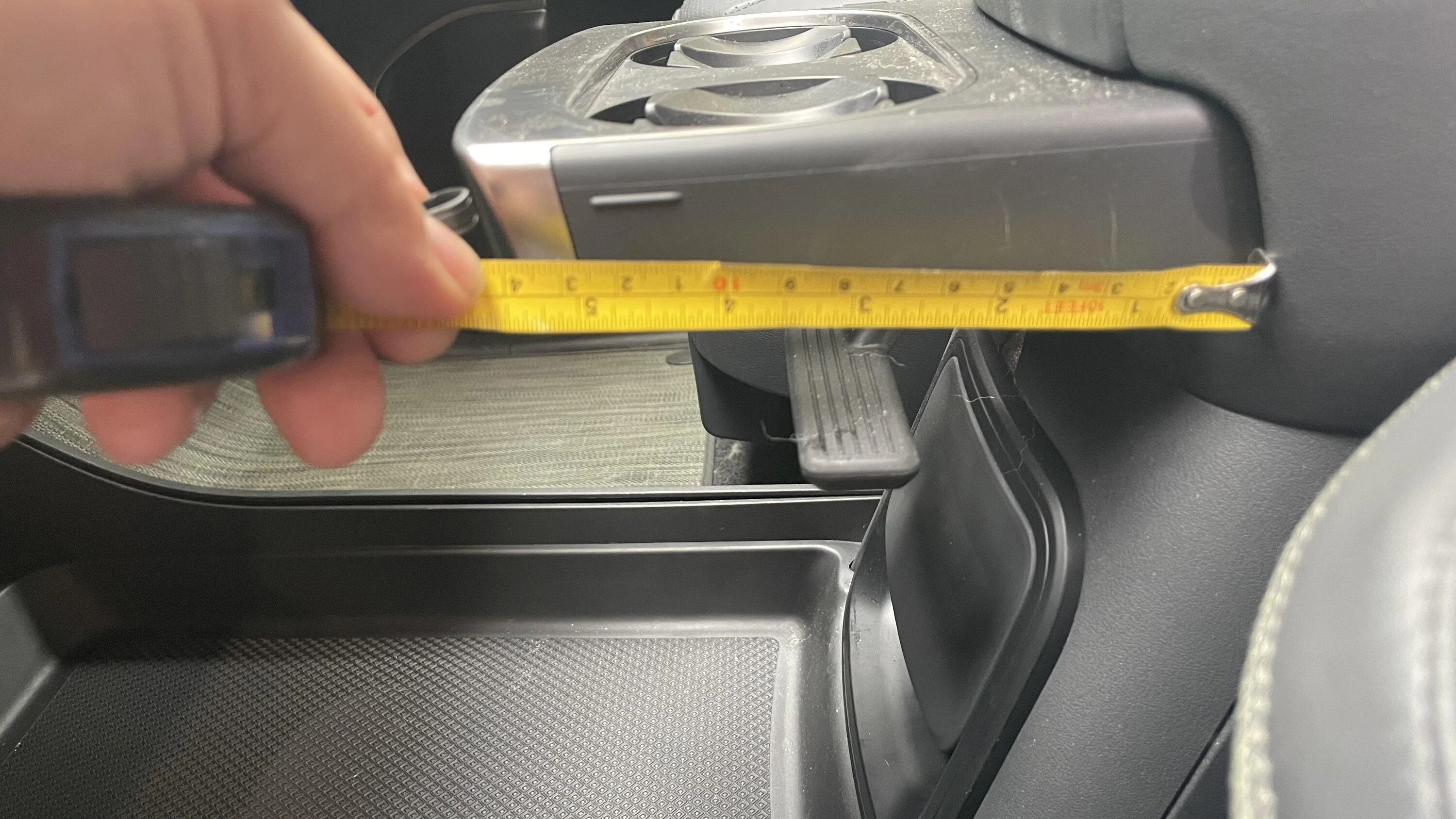

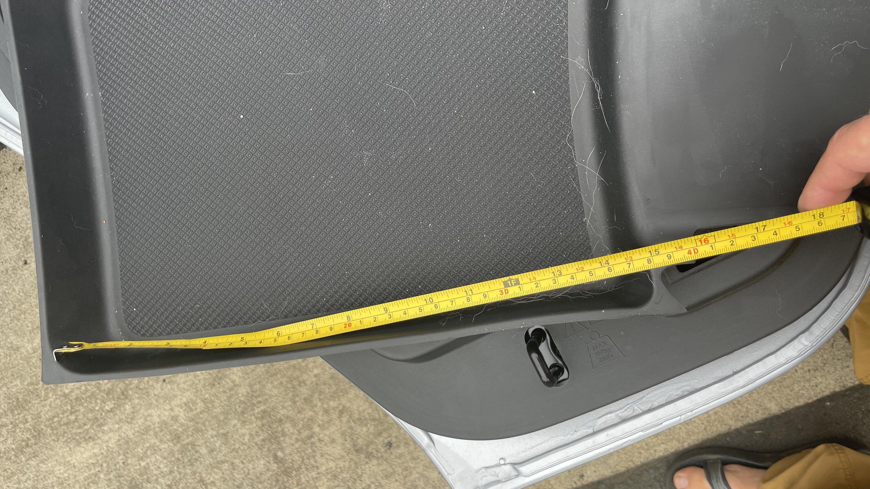

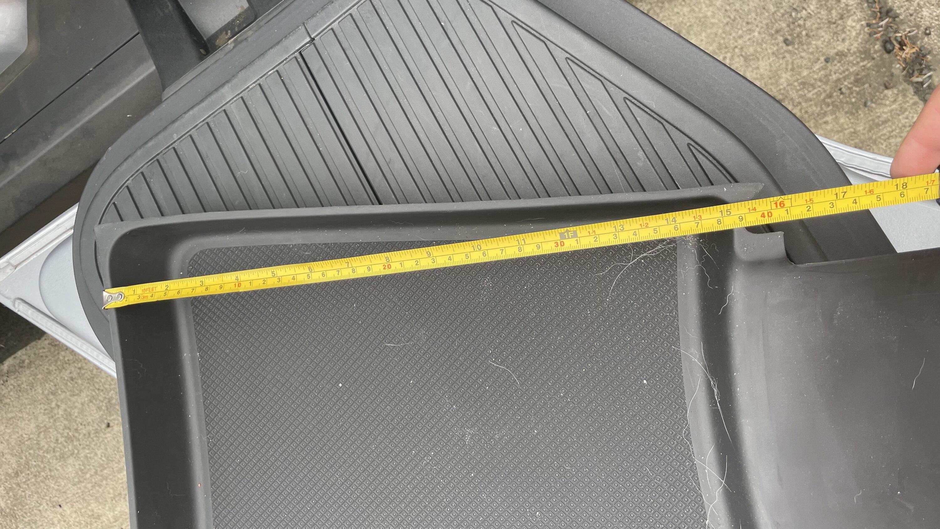

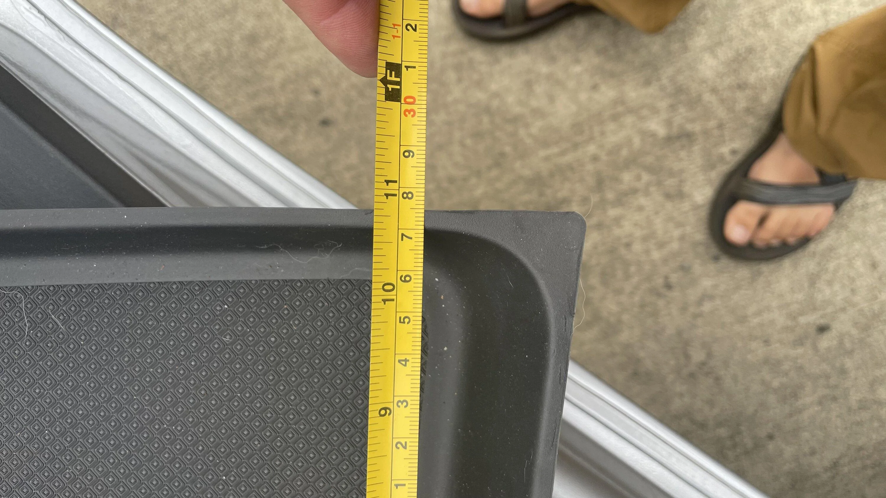

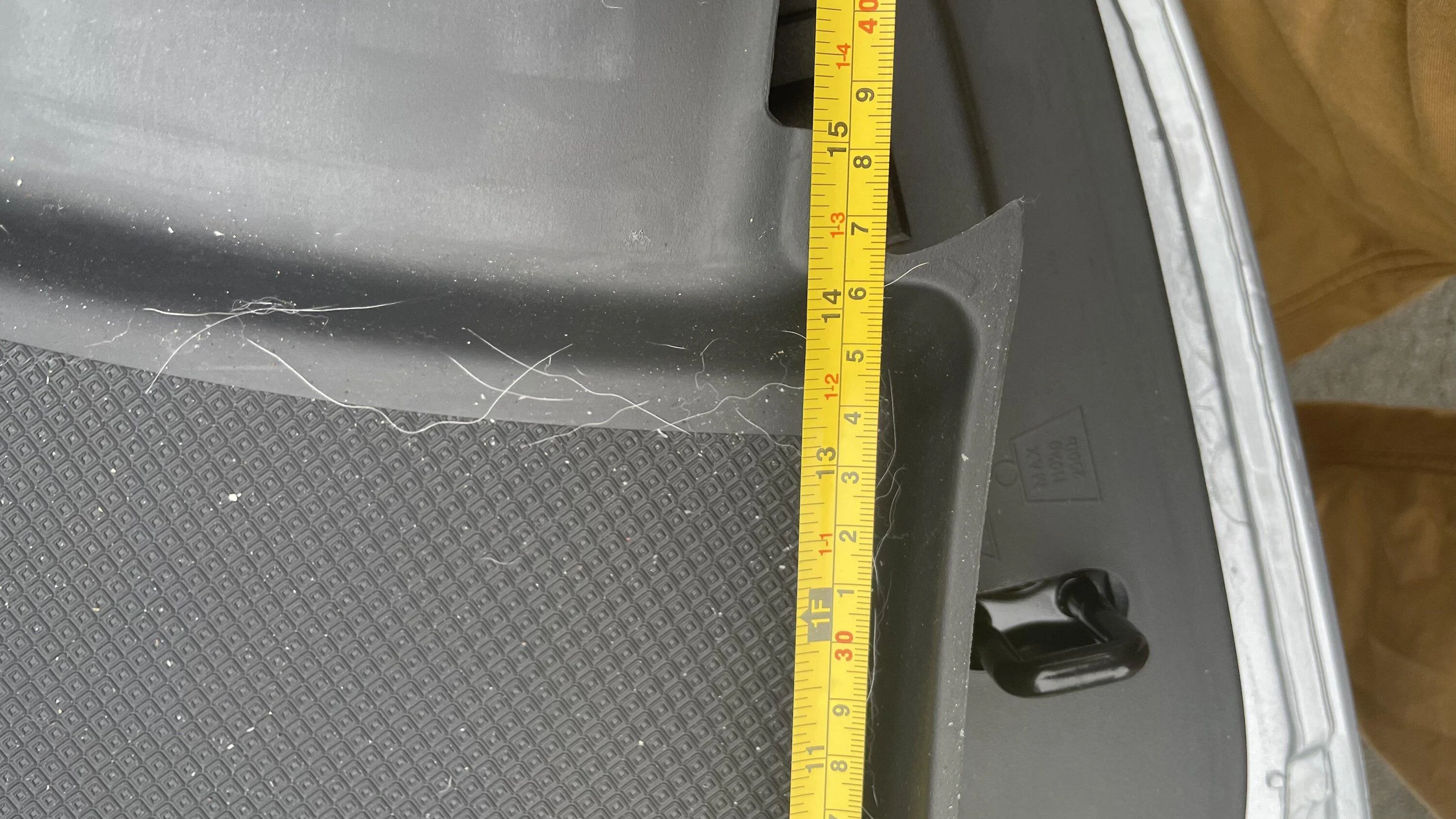

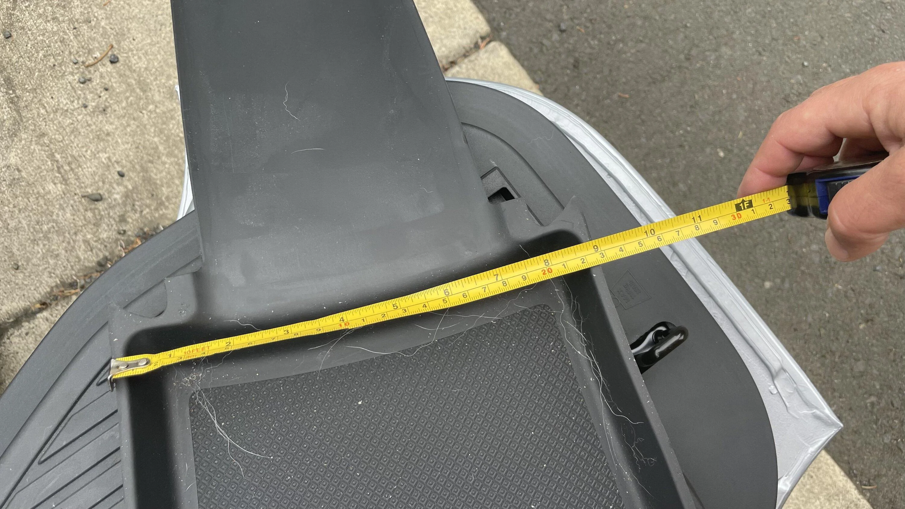

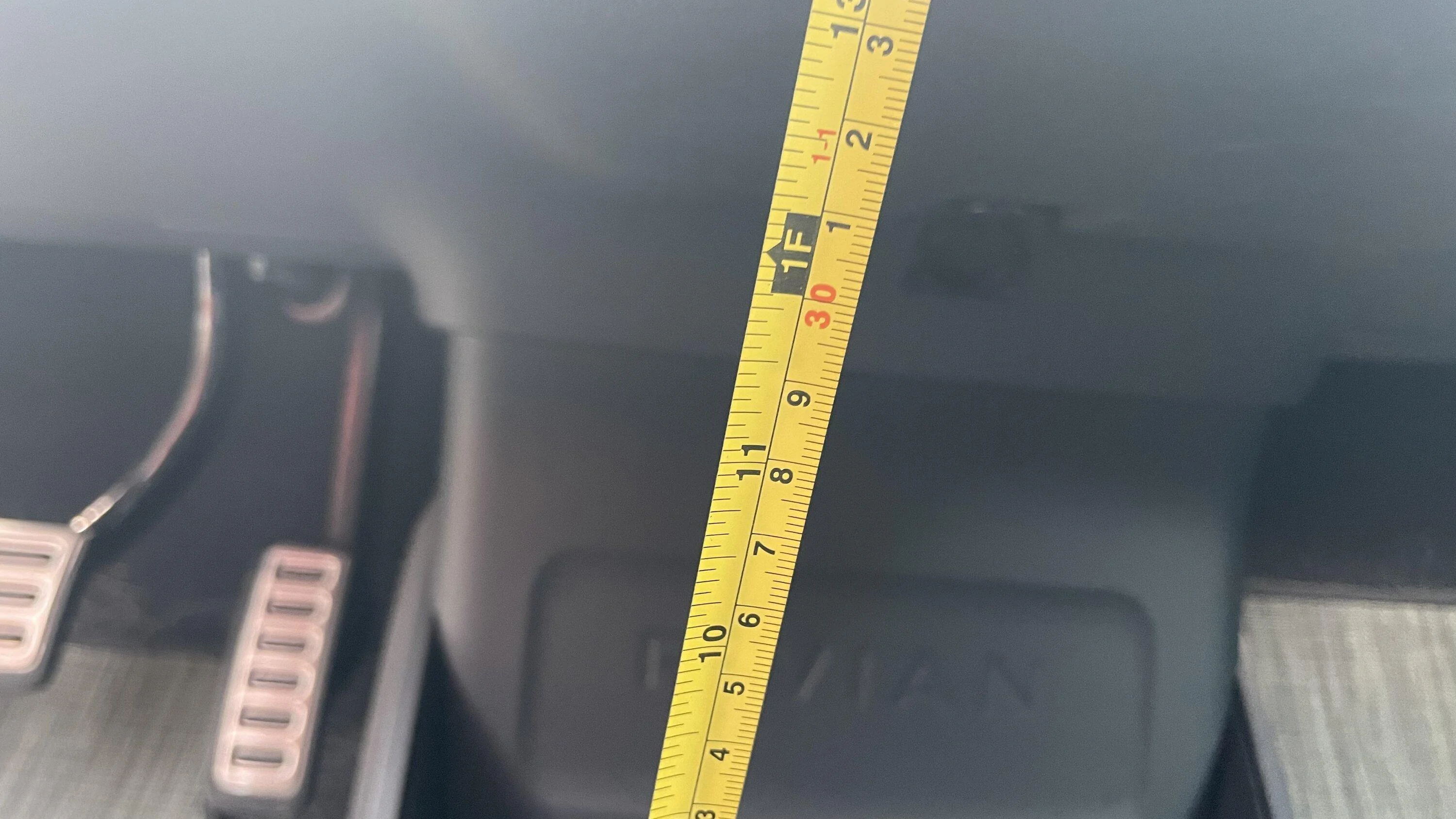

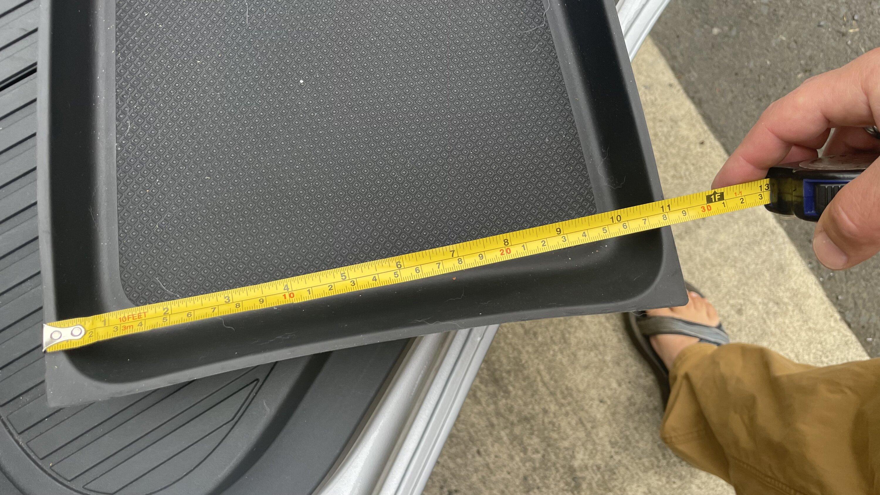

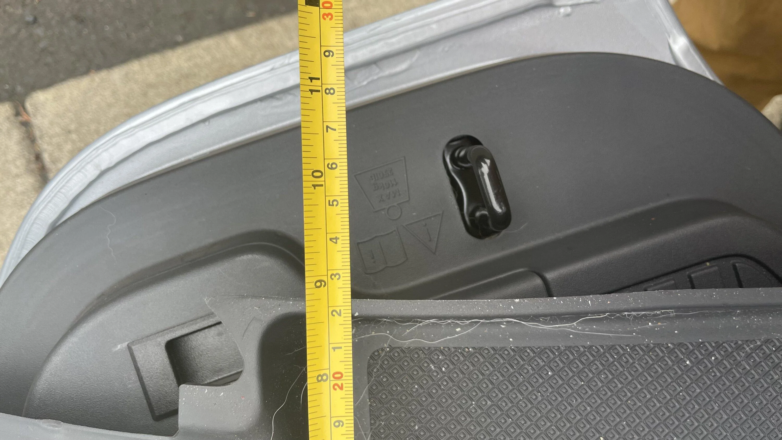

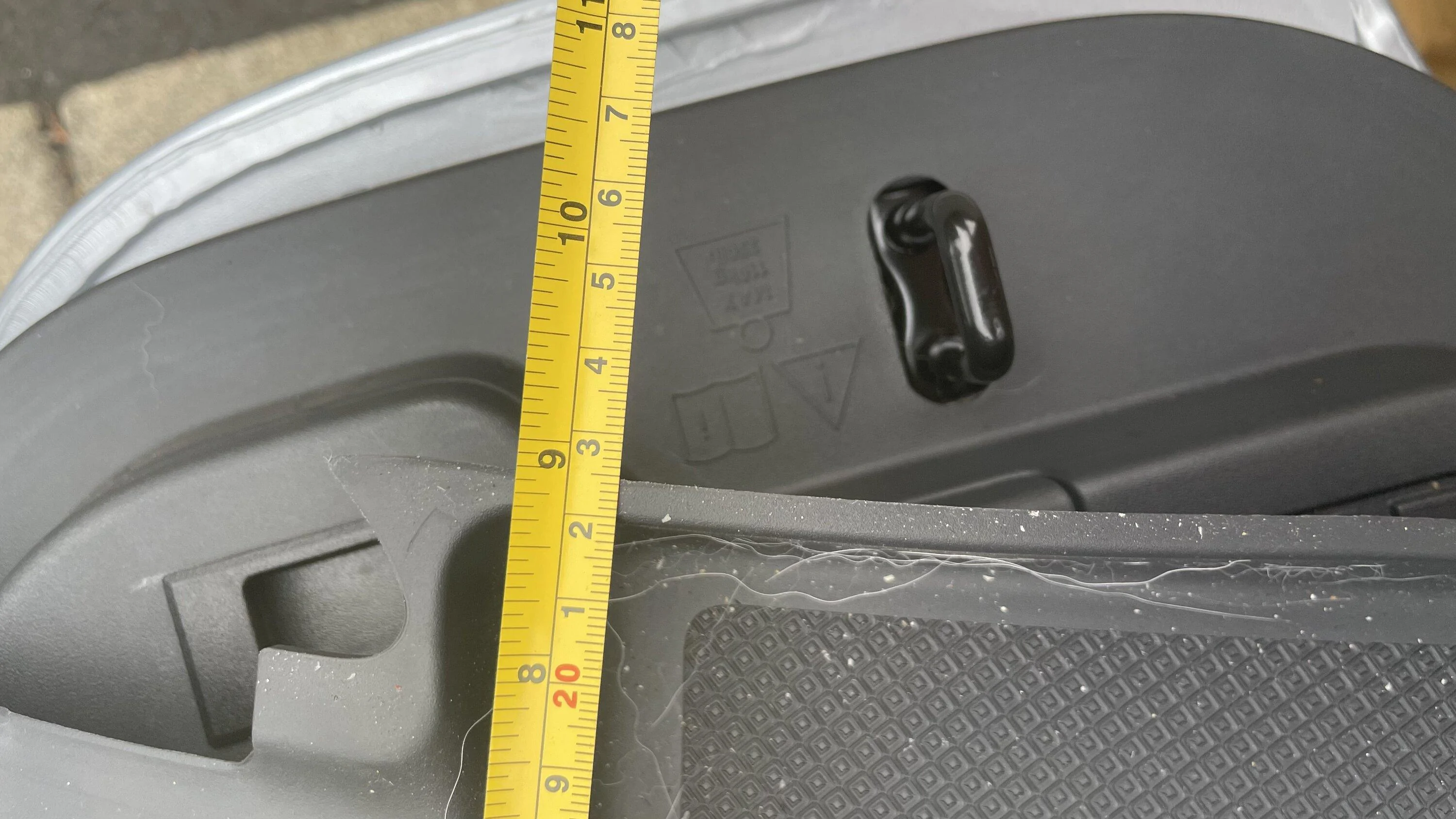

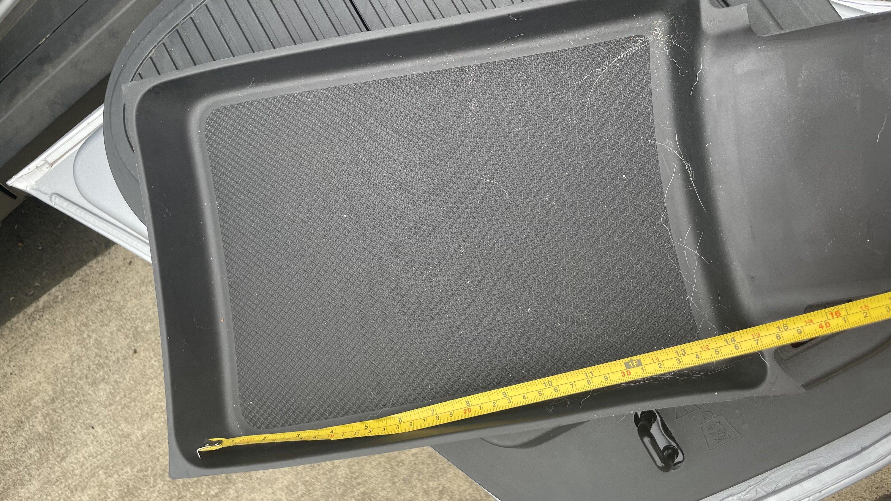

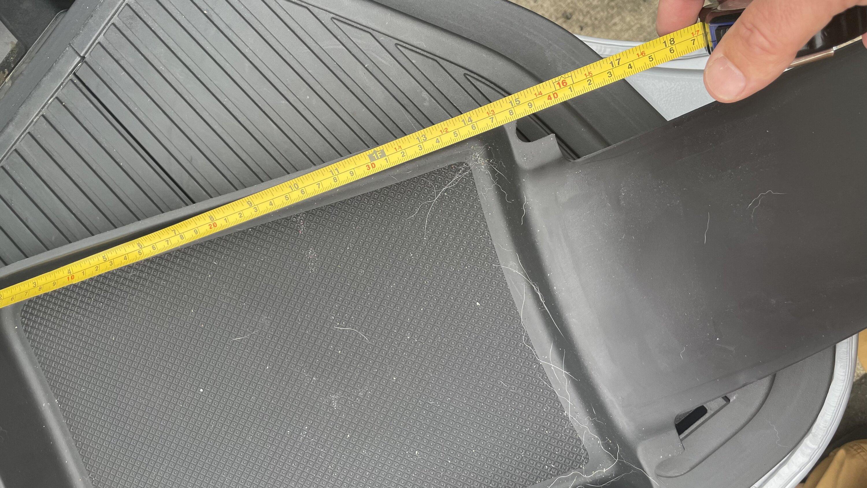

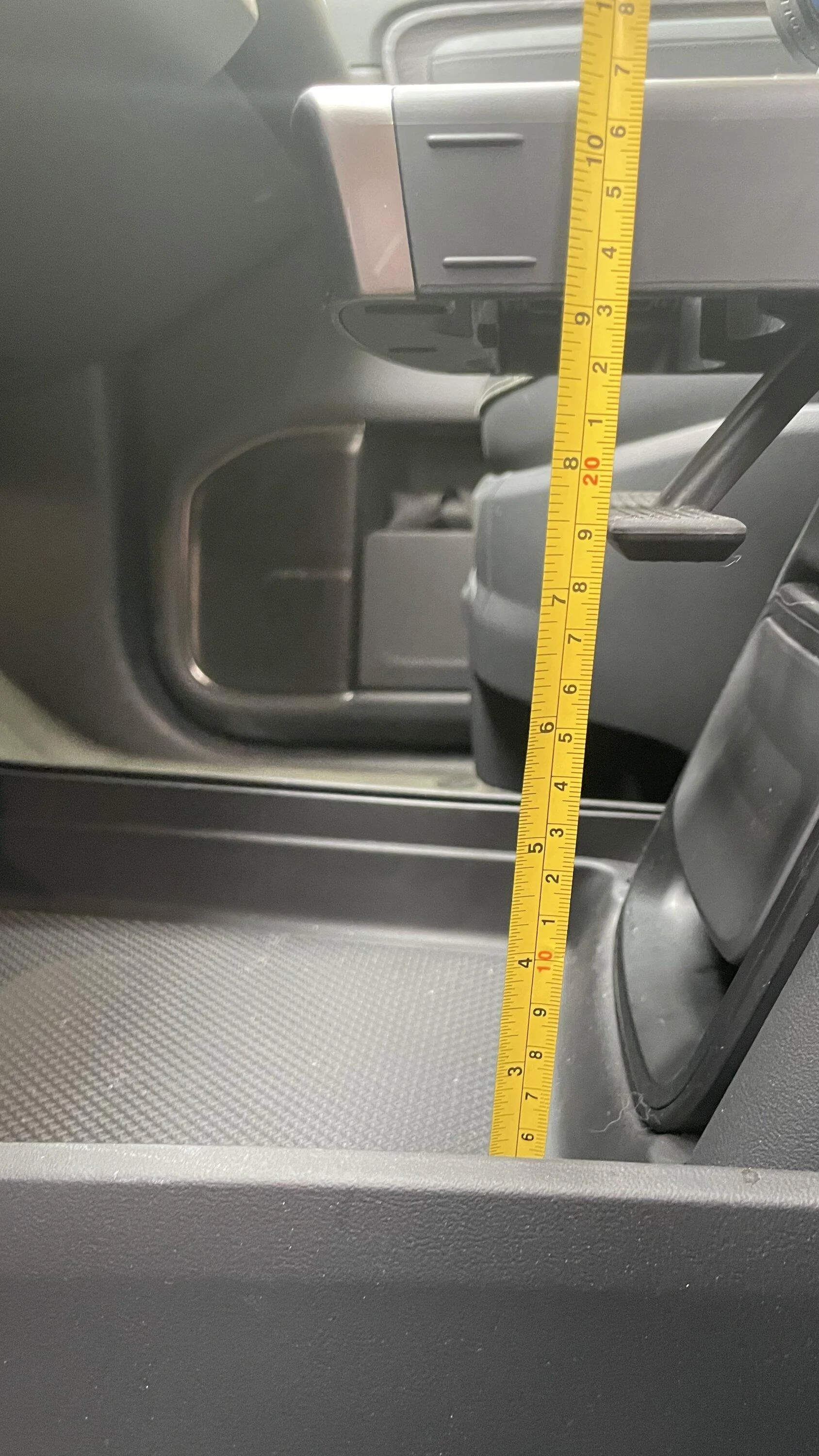

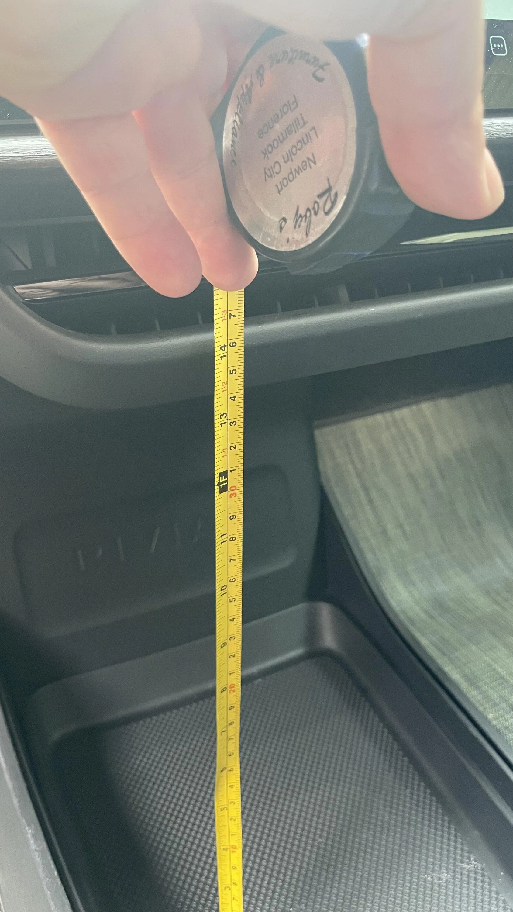

I was interesting in a small electric cooler to go there so I just took some measurements. THe area is a trapezoid so that may complicate things depending on if you want it to fit snuggly.
Tray 27 cm wide end, 21.5 cm short end, 36 cm long
Clearance: 30 cm under the dash, 18 under the cup holder bar and 23 cm to the bottom of the cup holder above the cup bar (see pics)
Cup holder is 14 cm long when deployed.
These are approximate and I have a husky.
