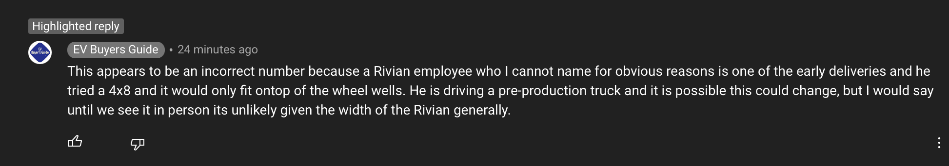

Can someone that has access to one actually measure it? Alex on autos claim this number is incorrect:
I can't imagine a truck, that wants to be a proper truck, not having enough bed width for a 4x8 sheet to lay flat - that's like, truck bed 101. Here's hoping!
I am not sure if R1T is trying to be a proper truck with a 4 foot bed.
Well, fair. I guess I would expect (hope) a mid-size truck to fit stuff with the tailgate down for those occasional trips to home improvement stores, etc. I'm not expecting Ford Super Duty levels of utility, but something more than my Subaru would be nice. I can't even fit a half sheet inside my car - I've certainly looked a fool trying!
I am waiting for R1S hoping I can skip buying a truck because R1S is wide enough for plywood but if R1T can not fit it, R1S is likely to be out too.
