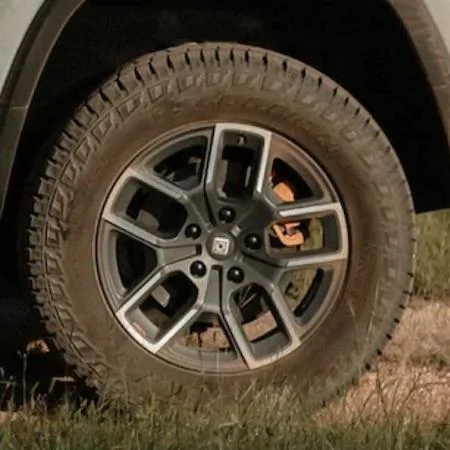

Actually I did run to the configurator and change to the 21" wheels when I read that! Now I've given it more thought and will likely change back to the 20" ATs. Here's why...
As I understand it, the reason the ATs reduce your efficiency is the added rolling resistance (and possibly a bit of wind resistance as well) created by the aggressive "knobby" tread.
I also recall seeing somewhere that in general, smaller "wheels" with bigger sidewall tires generally provide a more efficient profile.
Therefore, I would think getting the 20" wheel and retrofitting a good road tire like the Scorpion Verde All Season Plus II tire in 275/60R20 previously mentioned would actually improve your performance over the 21" wheel that was tested (albeit only by a percentage point or two.)
Somebody smarter than me tell me if I am wrong on either of those two points.
Anyway, I intend to change back to the 20's and buy a set of "road" tires to retrofit if I am unsatisfied with the performance. I can always keep the ATs for future use.

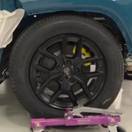

The 20's are a less aerodynamic shape (they are more spokey and lack the plastic inserts) than the 21's so I don't think there is much chance of being better range than the 21's, but the losses should be quite minimal. On the Tesla 3/Y removing the plastic hubcaps will reduce your range by 3-5%.
