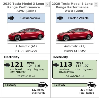

I always had the 21's configured, because the Rivian is going to be our road trip vehicle. However I live in snow-tire territory, so I will also end up with a set of 20's (with snow tires, not AT tires) unless someone comes out with snow tires that fit the 21's.
The rage reduction from the less efficient wheel/tire options really shouldn't have been a surprise to anyone.
According to EPA numbers, the Tesla model 3 looses nearly 10% of its range when "upgrading" from efficient wheels/tires to the max performance sport road wheels/tires. All Terrain tires seem like they would be way worse than sport tires so I was actually surprised that it was only 15%. I was expecting >20%. I suspect that the Rivian's AT tires are rather mild and if you replace them with more aggressive AT tires the hit will be even bigger.
