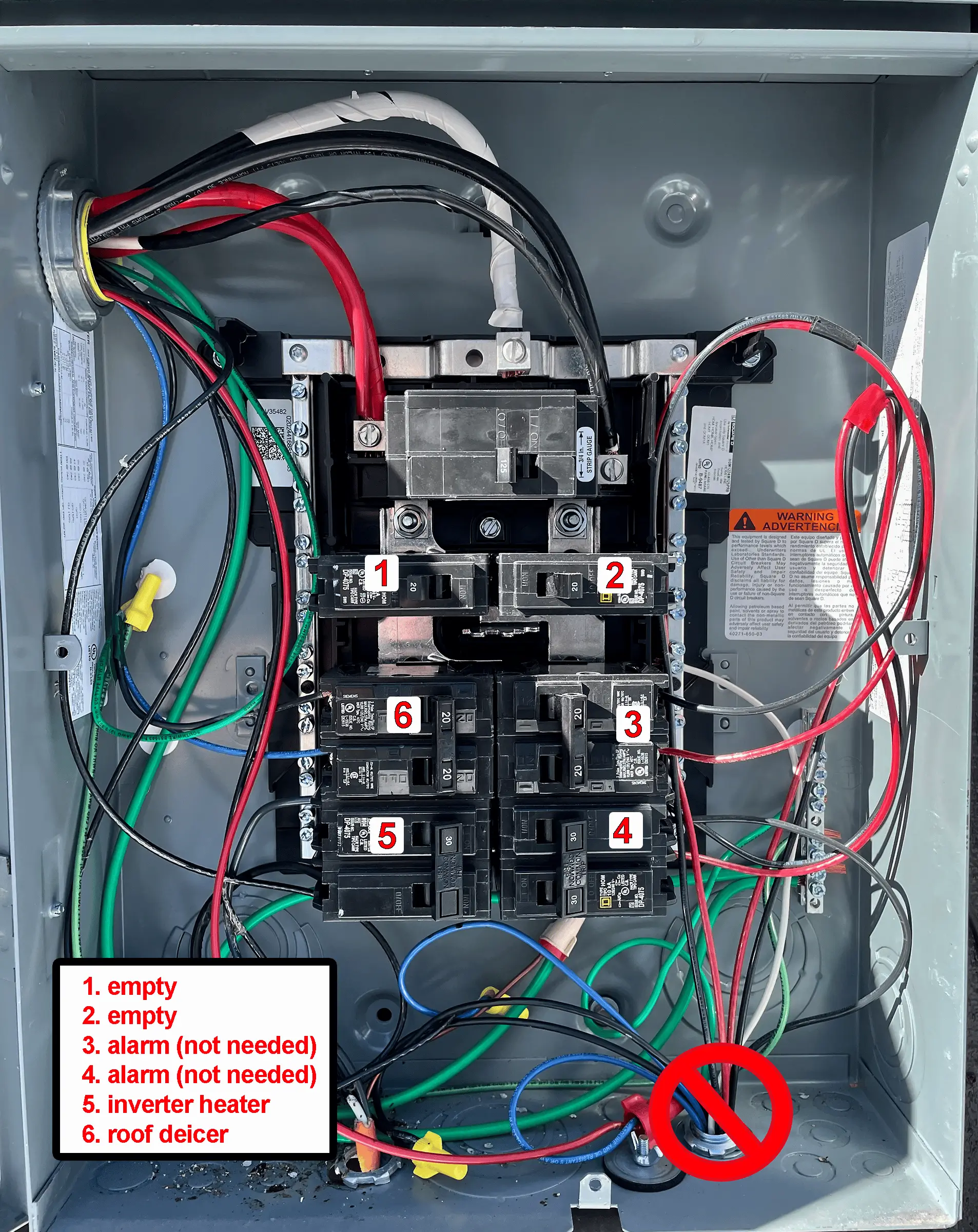

Thanks all I'm very grateful for the advice! I'm admittedly unsure about a few things...
1. So if I have 4/0 wire going underground to my main breaker from the road, then unless I have that 4/0 replaced, I can only go with 250-amps. If I want 400amps, I'd need to have the 4/0 wire replaced with 400-kcmil Copper Wire or 600-kcmil Aluminum Wire?
2. There's no such thing as a 250-amp main combo breaker box? If so, does that mean I'd have to use a 200-amp box and lose the extra 50-amps available or purchase an expensive 400-amp box that can handle 250-amp but not be able to utilize 400-amps unless a new 600-kcmil wire is pulled?
3. How would (2) 200amp tandem boxes work? Wouldn't I need two wires coming from the road, or do I have to daisy chain them? Isn't that what was overloading that busbar to begin with?

You want to avoid this if at all possible (and I think it is possible, see below). It is costly and it isn't sure that your conduit would support thicker wires.
But they do make 225A combo boxes. Click here to see the Eaton catalog pages (they make a 225A combo 20/40). And that should work fine for you.

And by the way, two 200A panels doesn't work. At some point in the chain, you need a breaker that protects the total load of the wires coming from the meter. In practice, that means a 225A breaker is needed somewhere along the way, so see my above post.

So the inverters only pull 12 amps and they would not normally run 100% of the time together. Your electrician can quickly run a calculation using the many online worksheets that assign lighting and outlet amperage loads based on house sq footage and then you
add any special large loads such as inverters , dryer, hot tub and EV. I would be surprised if you will need more than a 200 amp service. A 400 amp service is pretty costly as many utility’s will charge you for new service cables to the house and possibly a new transformer as well. Out here that can easily be in excess of $10k
again I would be surprised if you will need more than 200 amp service. I have a 200 amp service in my 2300 sq ft home and the only time it works hard is when my EV’s are charging. Both car and truck will pull 90 amps continuous when they are both charging together but even then plenty of capacity left to run 4ton AC and other loads. I would start with the load calculation and see what you’ll really need before you spend a lot of money needlessly
just cleaning up the wiring on your home as discussed the last few days and modernizing with a newer load center ( breaker panel) may be all that is required
