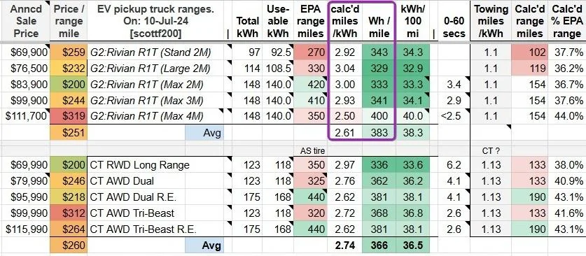

Unless there's some voodoo going on with the drag coefficient despite it's SUV brick-ness, it doesn't seem like the math would work on anything less than the current KWH.
There was some voodoo with the R1T tho...
Rivian has good motor efficiency even compared to Tesla which does (Lucid seems to be better)
Rivian R1T R1S [Debunked by ABRP] Rivian R2 / R3 / R3X Range Figures & Powertrains qL2vu04
