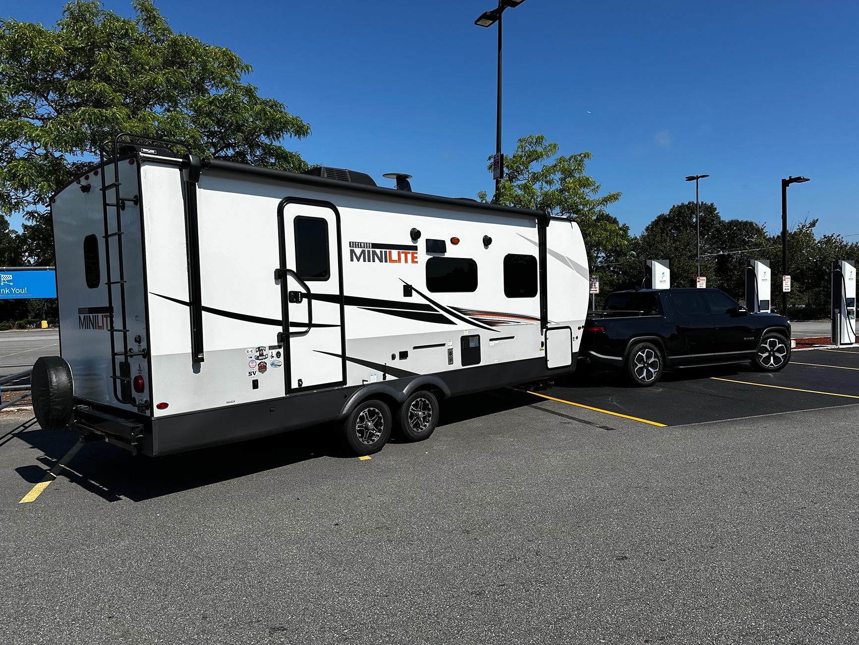

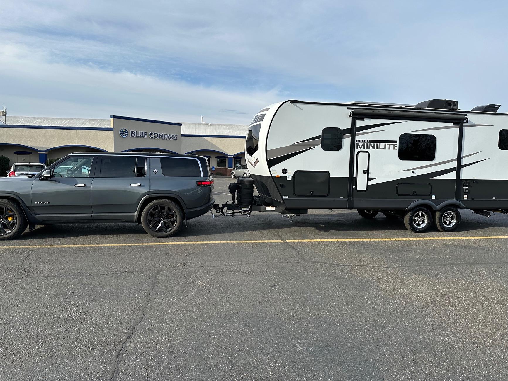

Rockwood minilite.
Rivian R1T R1S Current Travel Trailers / RVs you're towing - Reviews and Recommendations! IMG_0335

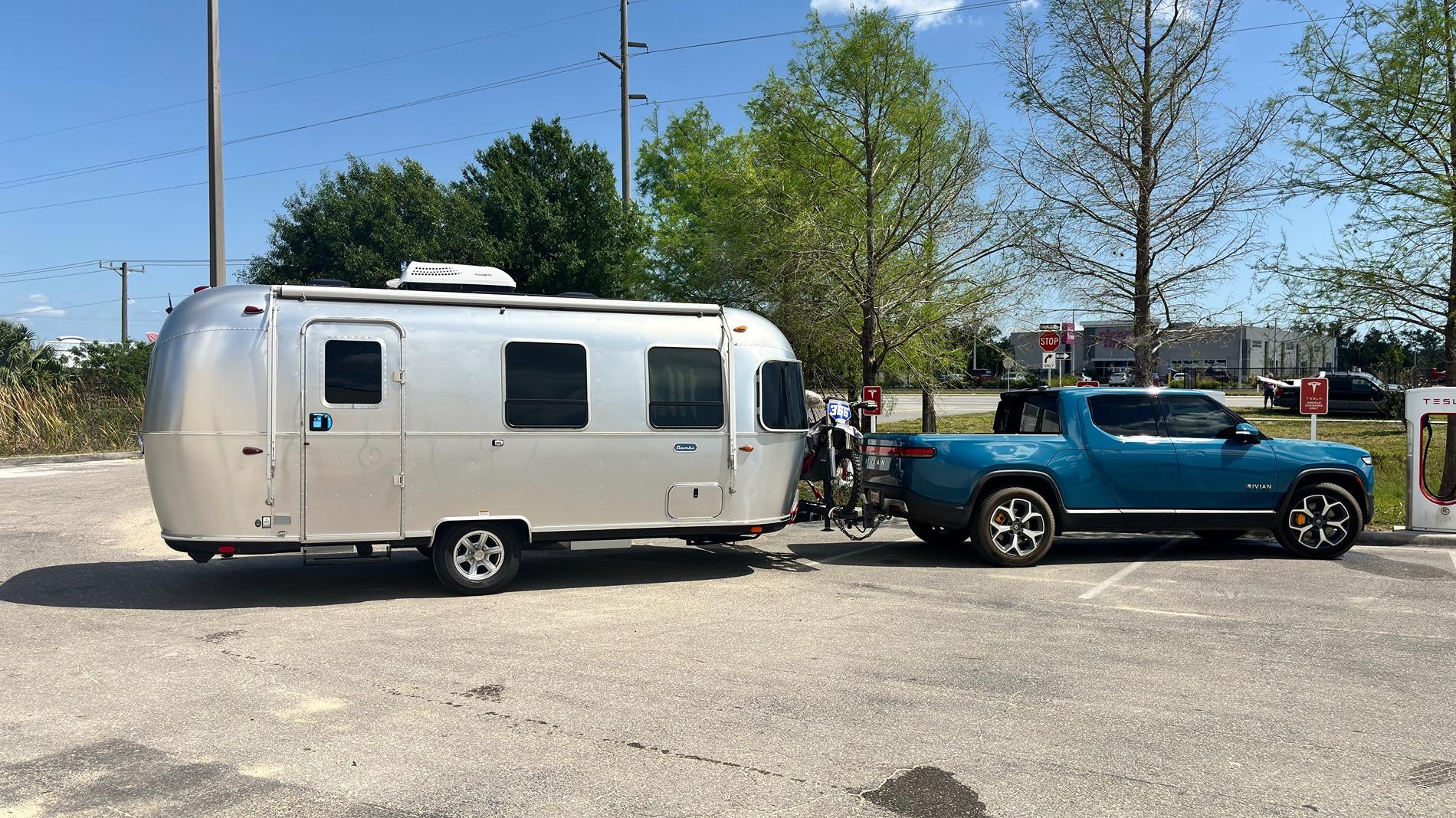

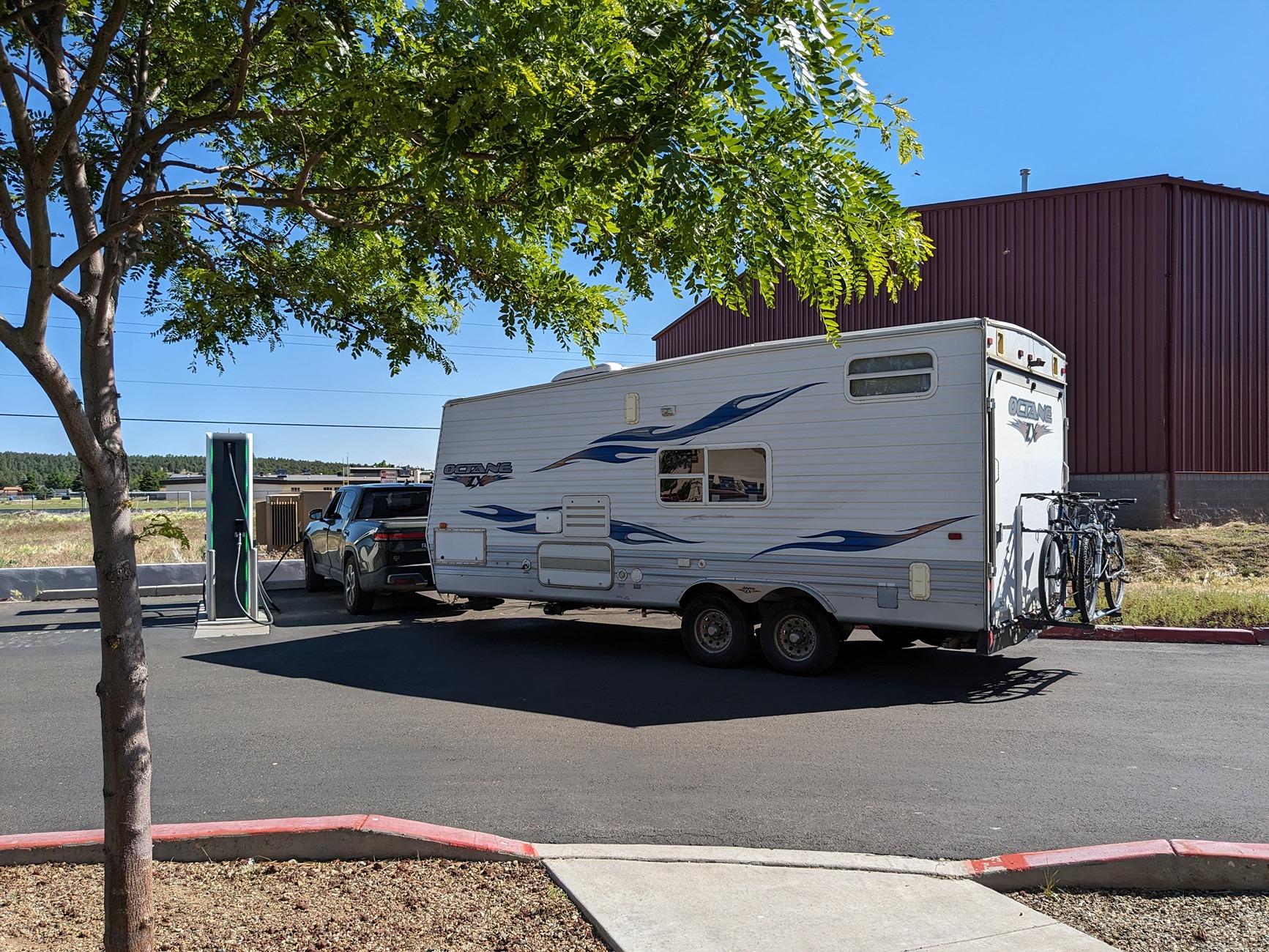

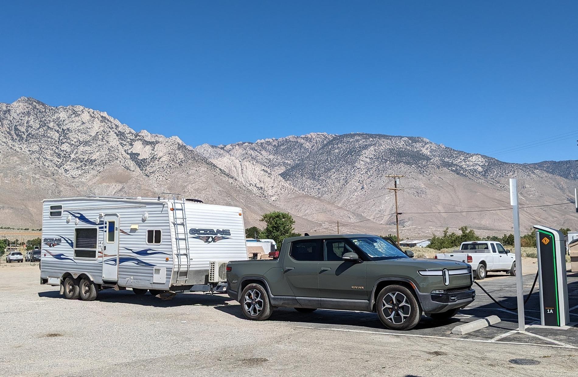

Love all of these! It's awesome to see so many people towing with their Rivians!

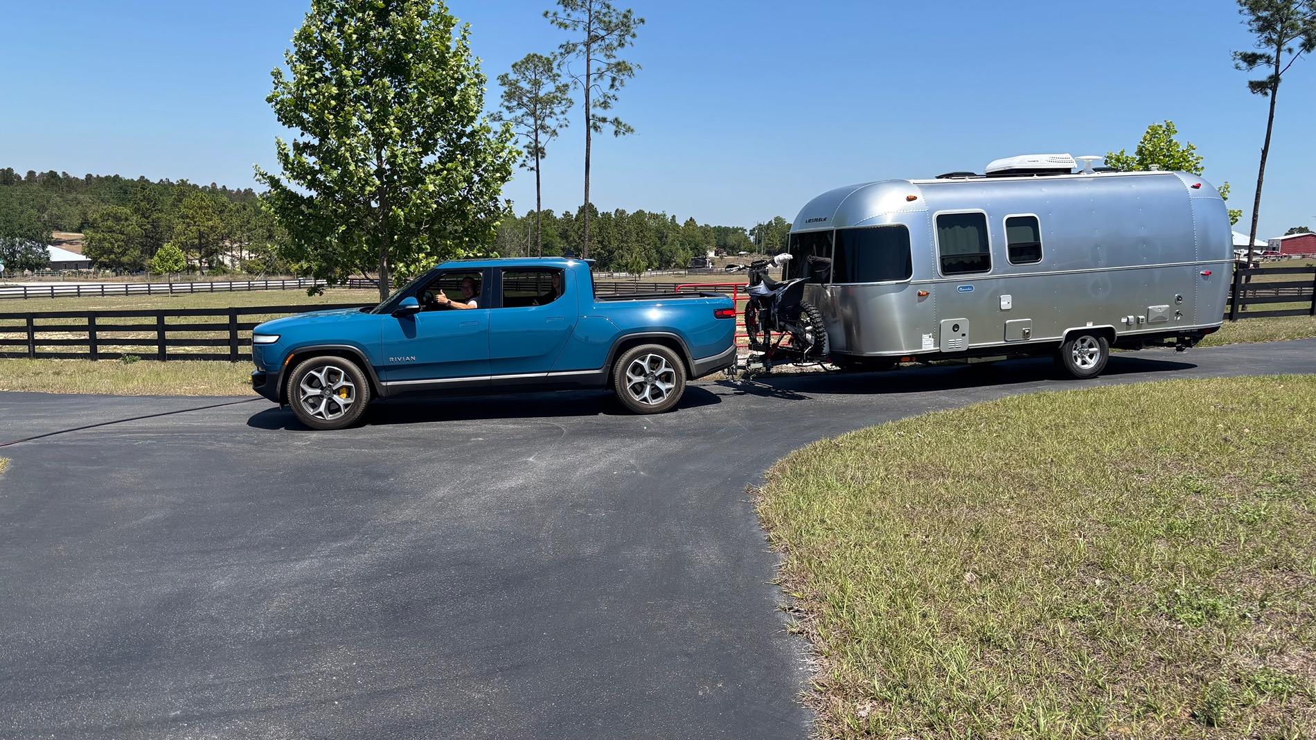

We've been towing Howie (our house on wheels) with Tug-E (the truck) for almost 3 years now. I'd echo all the comments about ease of towing and things that affect efficiency and the benefit of charging at campgrounds.
Our travel trailer is a large, heavy box, at least compared to what most of all y'all are doing, so our range is a challenge. Average efficiency of 1.1 and we tend to take local roads and drive slower. Our summer tours take some planning but it's worth it.

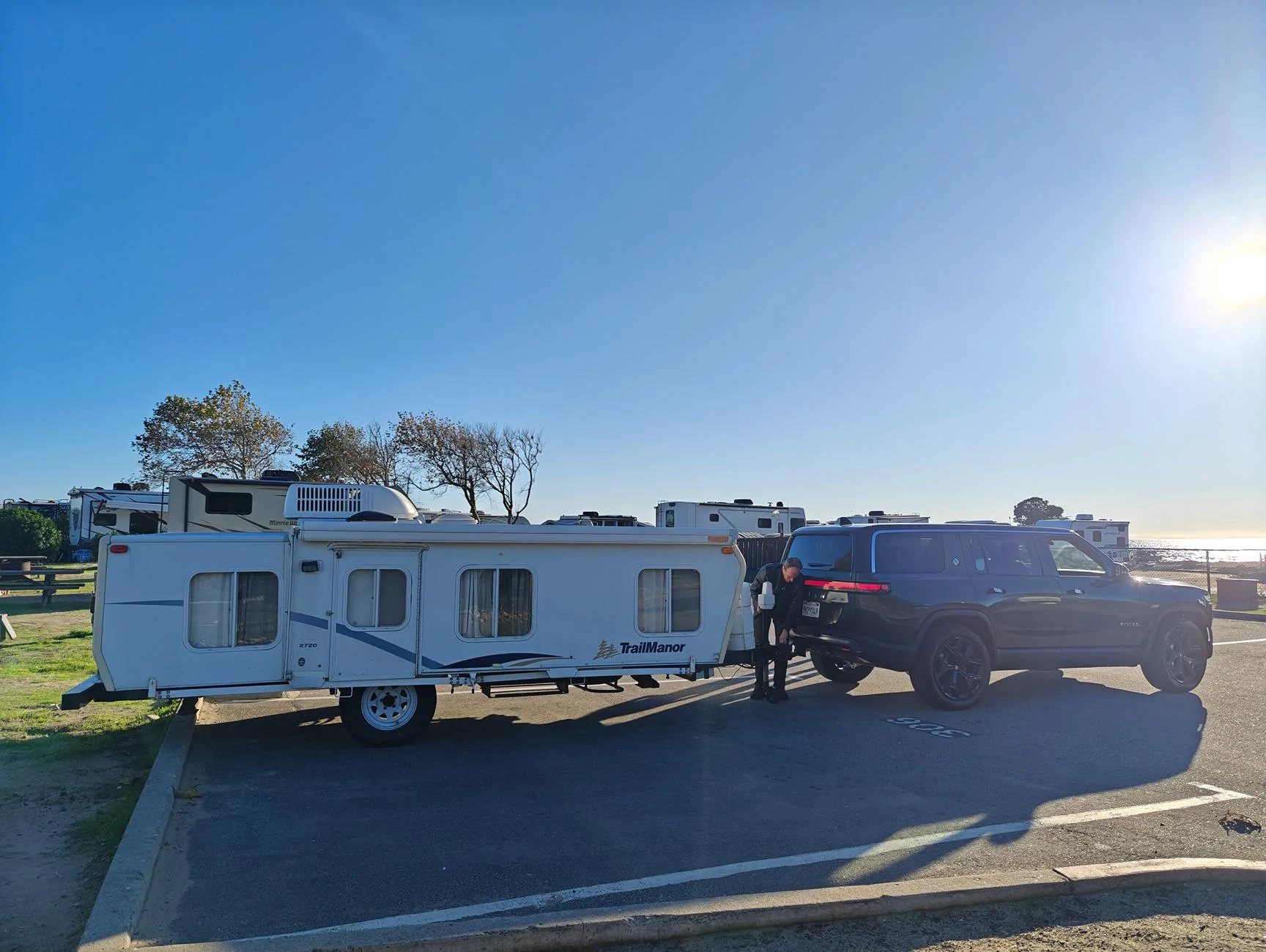

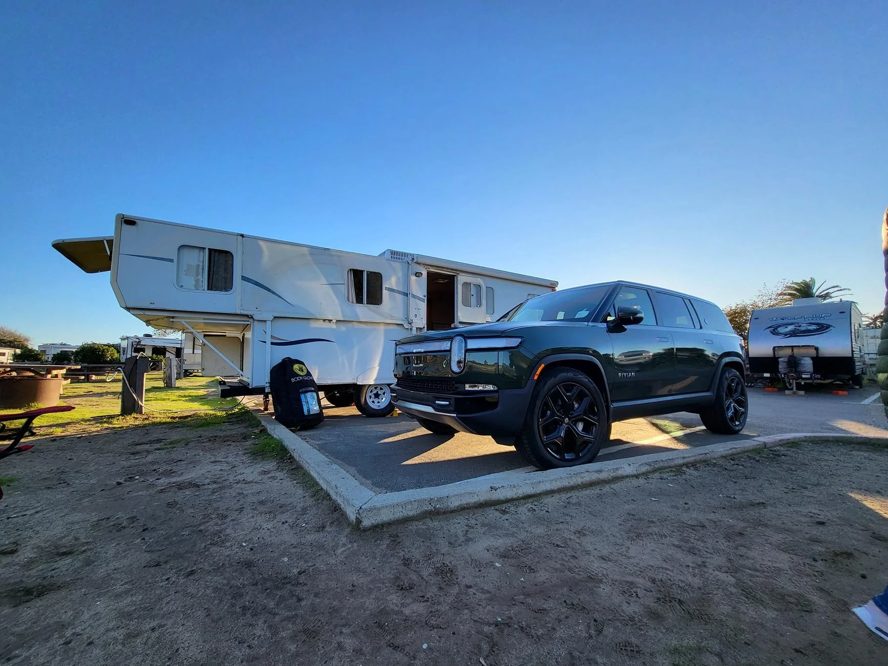

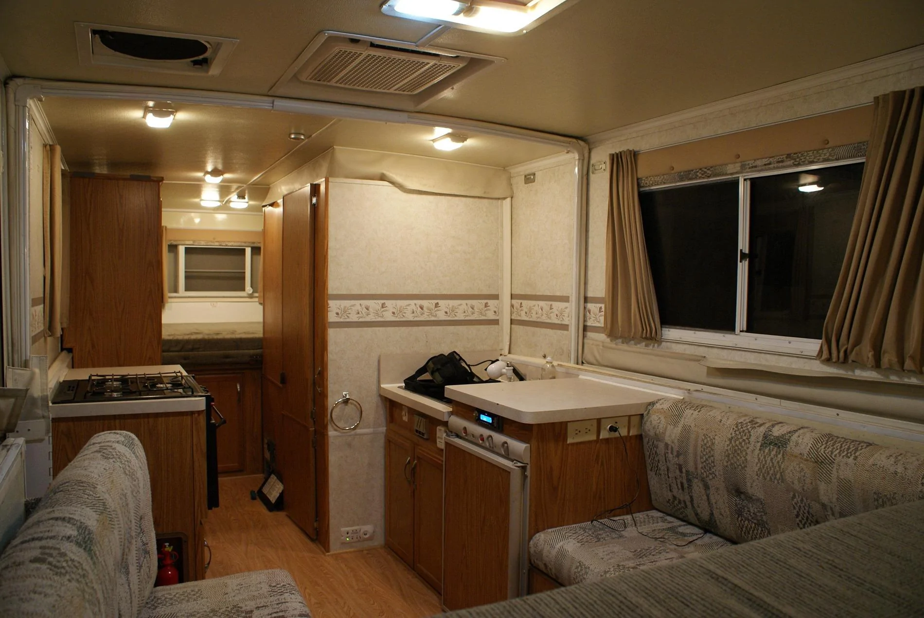

You could consider it the Trail Manor. We have two adult kids as well and sometimes a GF with. With a queen and two full sized beds, it sleeps plenty. 1.6 mpkwh in leisure mode.

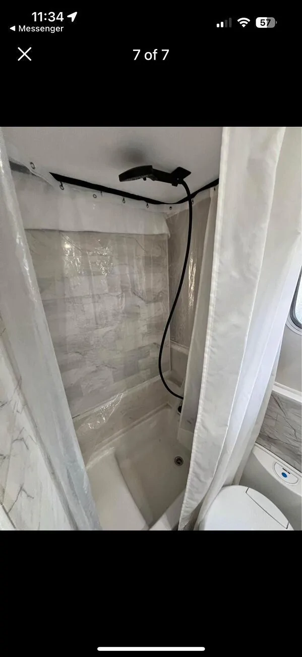

How well does the shower work? That is one thing I would be worried about.
I have a TrailManor too. The shower works good. I can mount mine onto the ceiling. It has an on/off switch too. One time I wasn't paying attention and the shower curtain directed the water to the floor between the tub and toilet. Earlier this month we were camping at Carpinteria Campground and found out that tokens for their showers were $2 for 2 minutes. We decided to use our shower the rest of our stay since each site has 30-amp power, water, and sewer hookups. It is a bit cramped in the shower (I'm 5'6") but its doable.
