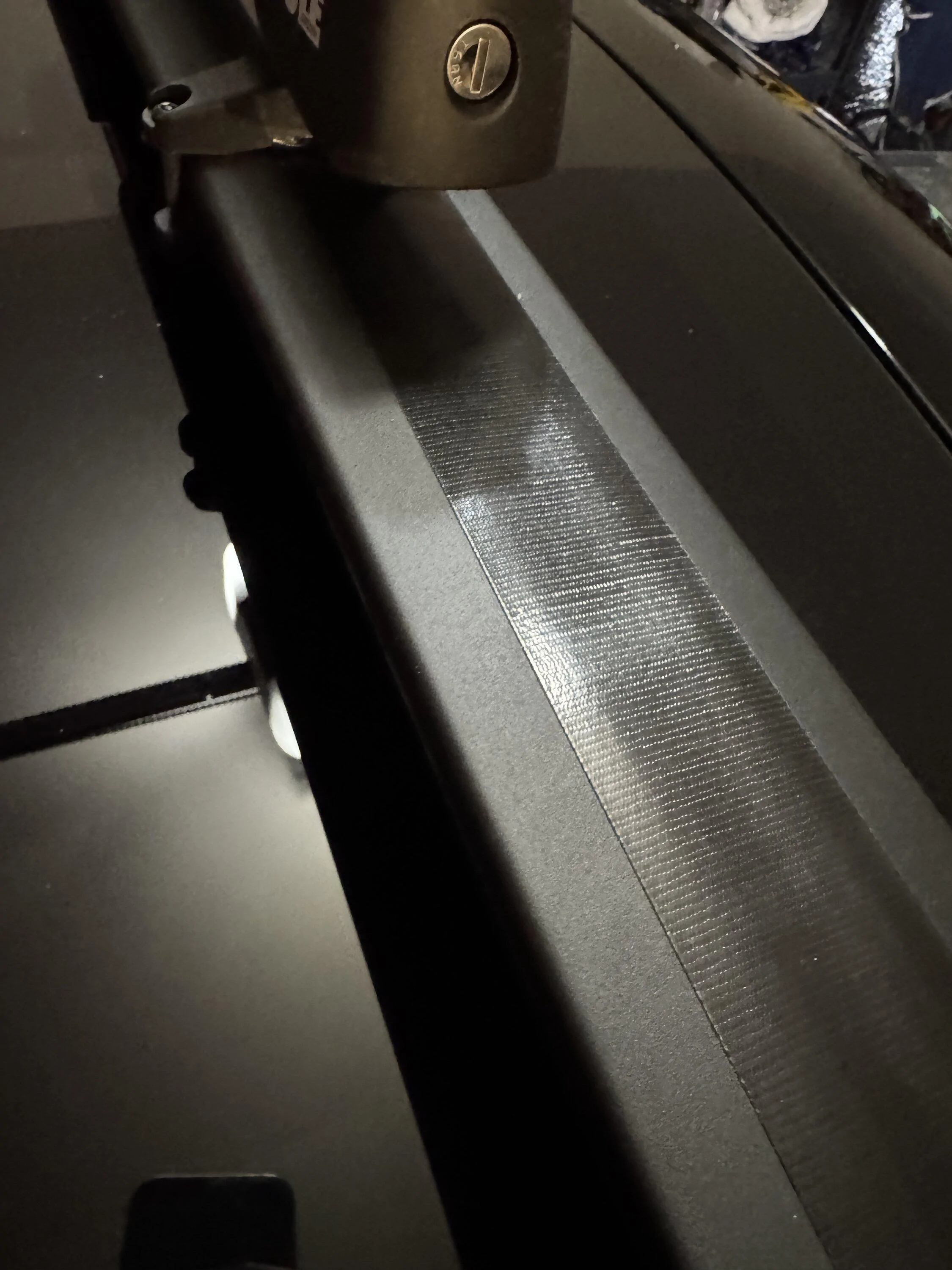

having noise from cross bars?
I have a 911 I put cross bars on to carry skis. They made a loud noise. Porsche gave me these rubber strip that went in the bar. This gave me an idea. I didn’t have rubber strips, so I just put black duct tape along the slot. Noise gone. I will now do a better job and make look nice, but putting tape over the bar slot will get rid of the noise from cross bars.
Rivian R1T R1S Cross Bars are Noisy Solution IMG_9203
HTH

Mine make a slight whistling sound but I have to listen for it so it doesn't bother me.

I might be wrong, but I think someone posted a 3D printed filler strip a while ago?

Is the noise when they are located on the roof only? I just ordered a set for the R1T, though I planned on putting them over the bed.
Yes, R1S.

The Rivian crossbars are so quick and easy to remove, just take them off when not needed. Improved range efficiency as well when removed. Drive well.
I ski pretty much daily.
