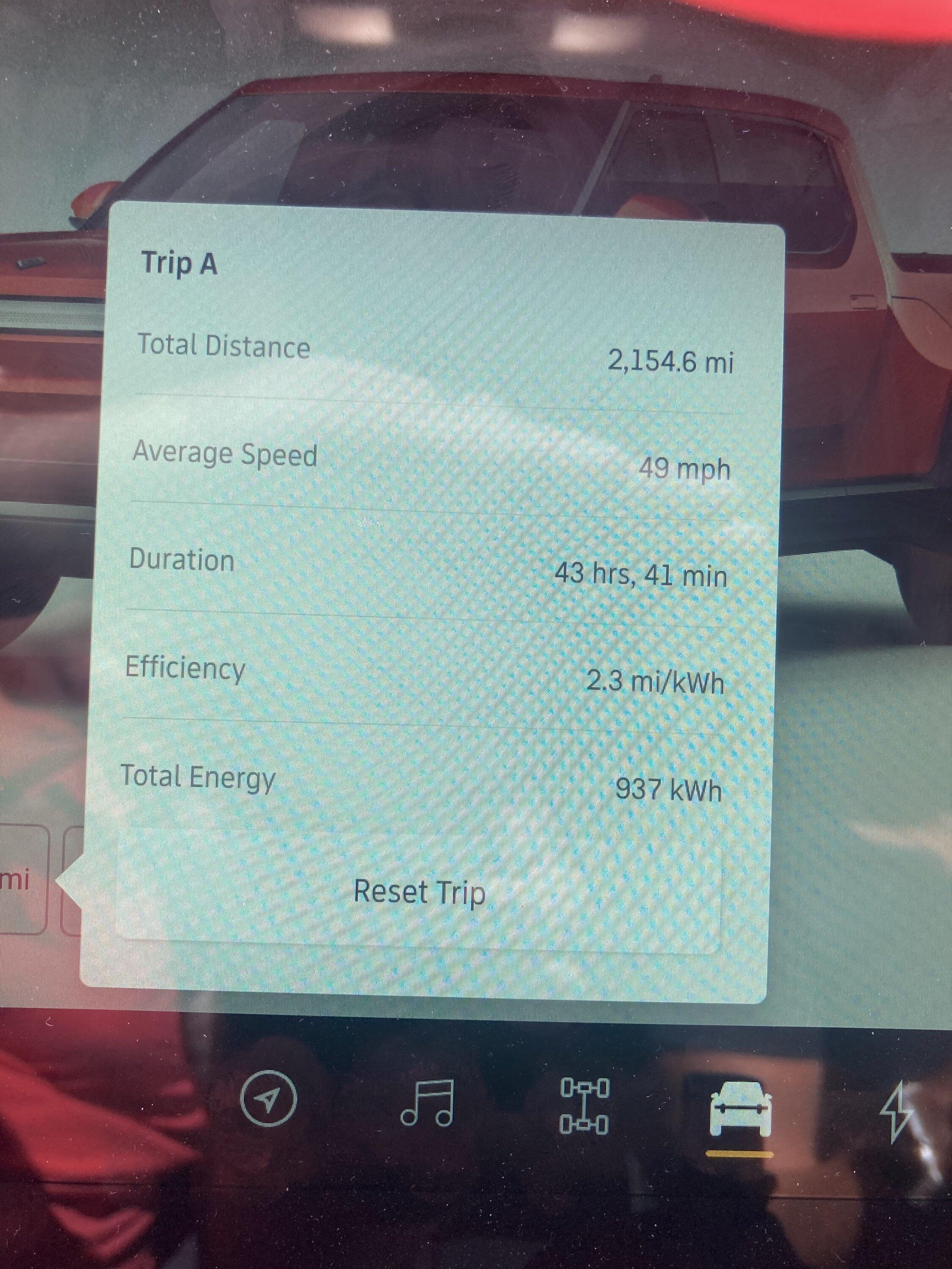

Here’s my trip from SF Bay Area to Vancouver and back..21” wheels, conserve mode on highways driving up to 80mph
Rivian R1T R1S Conserve Mode Efficiency Improved? Rivian R1T real world range on a 900 plus mile trip averaged 2.7+ miles/kWh 4B5E836F-3593-4588-85E9-B60187310C4B
