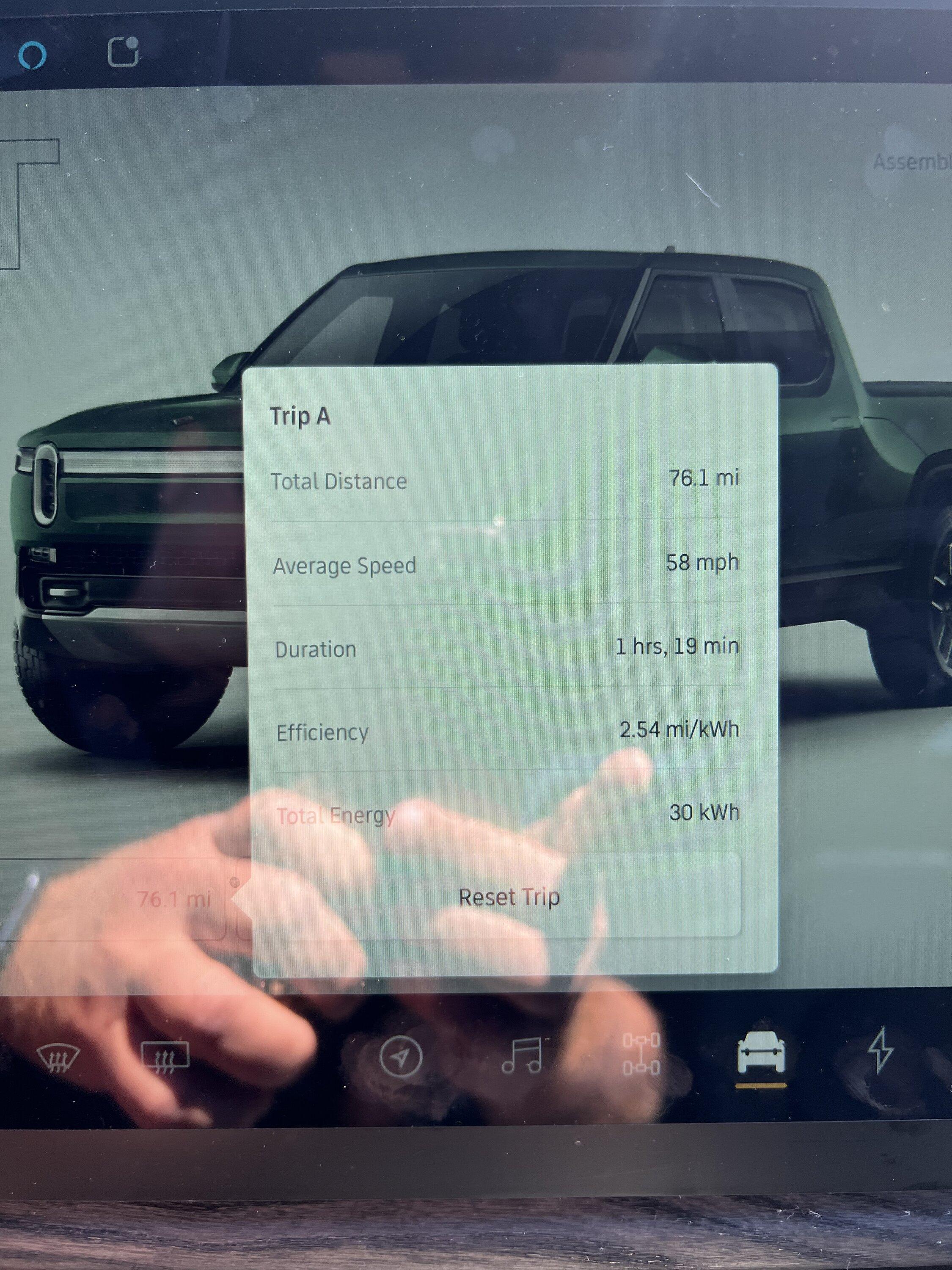

Milwaukee to Oshkosh for the EAA Airventure Airshow.
Flat Midwest highway in conserve mode on a warm moderate wind day.
76 Miles
58 MPH Average
1 hour, 19 min
2.5 Mi/kWh
30 kWh total consumption
20" Wheels with standard AT tires
Sorry about the crap photo
Rivian R1T R1S Conserve Mode Efficiency Improved? Rivian R1T real world range on a 900 plus mile trip averaged 2.7+ miles/kWh IMG_8554
