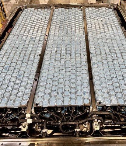

It should have decent range (when not towing)... in a recent thread about the R2 battery, RJ confirmed the battery will have 768 cells each with about 119wH of energy. That will give you a pack rating of about 91kWh before they take a few kWh out for top and bottom buffer. So if we get 88kWh usable and the R2 efficiency is around 3.5mi/kWh that gives the R2 an estimated range of 308 miles. That's not too shabby for a mid-size SUV.

Not much you can do about that, it's a smaller vehicle with less room for batteries underneath. By the look of that battery pack RJ posted photos of... it was filled with cells from side to side and end to end already.
