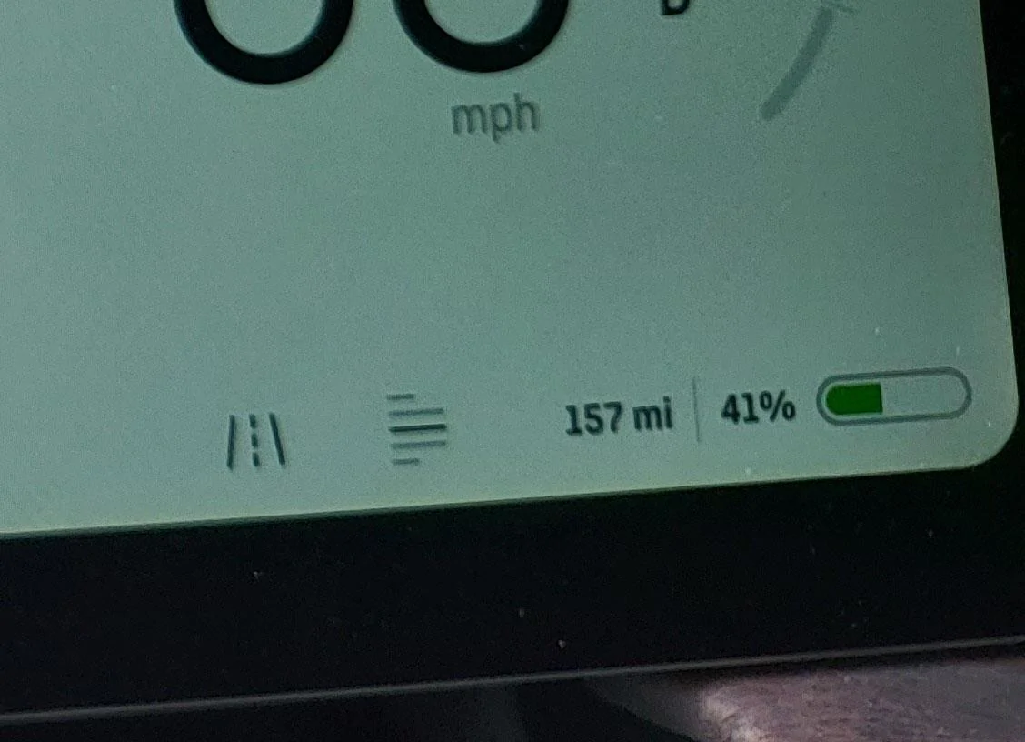

So three drive mode heights? Normally in offroad you have access to Standard, High (45mph), and Highest (15mph) height. All Purpose usually has access to Low, Standard and High. How many indicator lines are present on the center display?
Rivian R1T R1S Confirmed: AWD upgrade to Performance Dual Motor available via software update later this year a2023-12-22 12.53.48
Tow mode and Snow mode should also make the rear motor always active.
