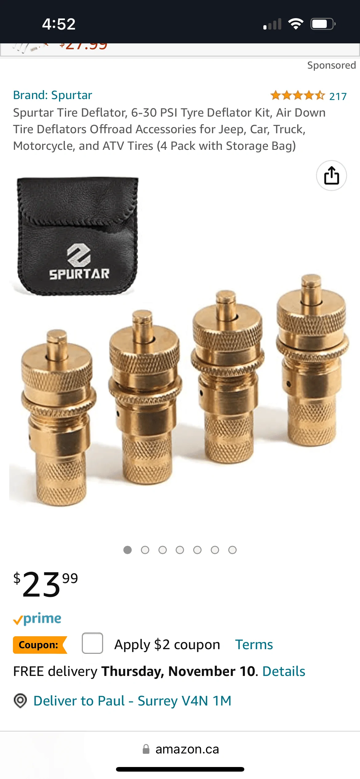

There are tire deflators that you can set to a specific psi that will deflate and stop at a preset psi. They come in a set of 4. I seen them on a rivian review video but have no experience with them.
here’s a set of them. I don’t how high of setting you can get. These ones max out at 30 psi
