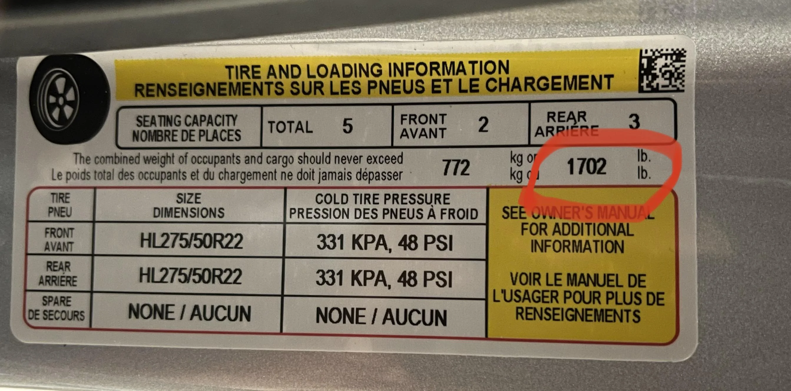

I can confirm the tonneau makes no difference in the ratings. I have a 21” quad / large, no spare / skid plate / tonneau and it’s the exact same as the other already listed but with tonneau.

LE 22", On-road underbody, NO spare, NO cover. :rock:
Thanks for the update! Closest yet I have seen to the mythical 1,760 lbs payload rating :)

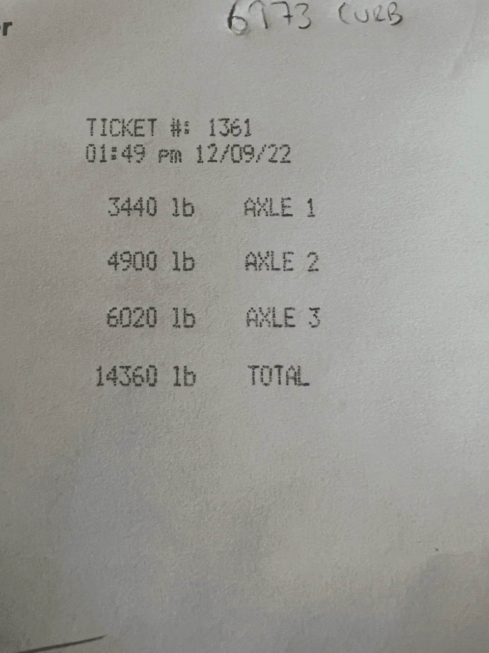

If you have a scale nearby, it would be interesting to see what your truck weighs (but you'd have to remove any misc stuff you might have in there, like tools, and subtract out your weight) as the 'curb' weight, and we could compare that to what it calculates out to be, GVWR - payload rating = curb weight

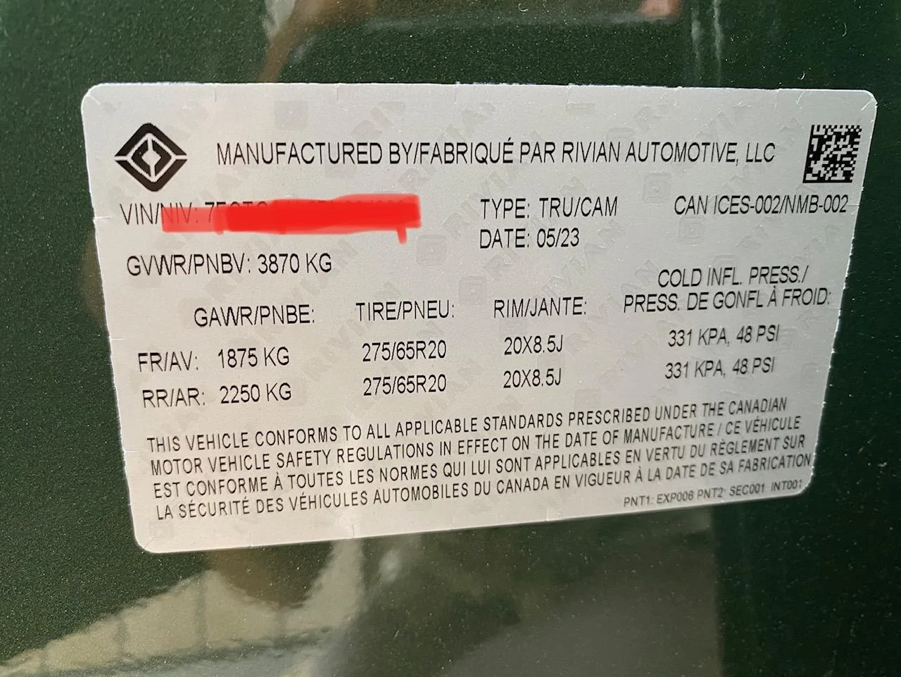

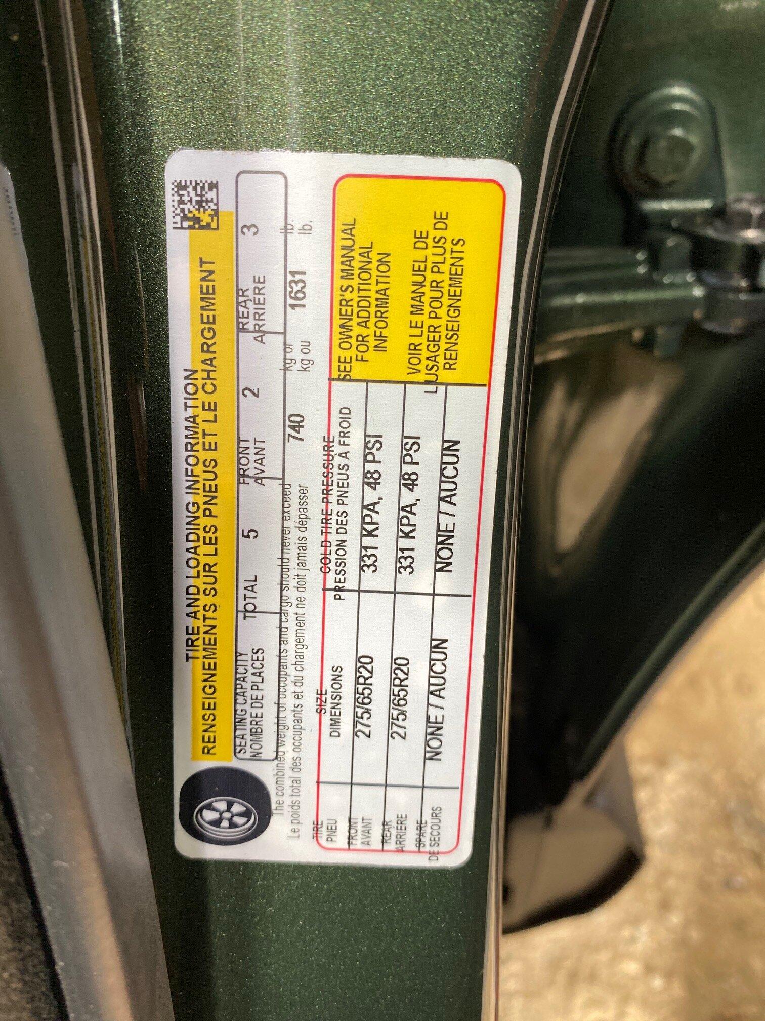

I picked up my Quad Large last weekend and thought I'd update with a May 2023 build sticker. I have 20" AT wheels/tires, no tonneau (but do have rails), no spare, and no underbody skid plate protection. Payload of 1631 lbs, which is the highest I've seen for 20" AT so far.
Interestingly, calculating two ways against other 20" AT trucks I find the powered tonneau to be 72 lbs (vs the earlier calculation against the 22" wheel truck). Close enough not to matter at this point though whether 72 or 90lbs. The other data point I should add is that I am pretty sure I have the Rivian audio system (I don't see the word Meridian anywhere). The other oddity is that my GVWR is shown on the sticker only in kg, and when converting using 2.2 lbs/kg, it works out to 8514 lbs vs the US stickers showing 8532 lbs (Edit: as pointed out on the next page, I wasn't using the direct conversion; the GVWR does match, updated in 1st page table). I'm heading to a weigh-scale today, so stand-by for actual curb weight.
