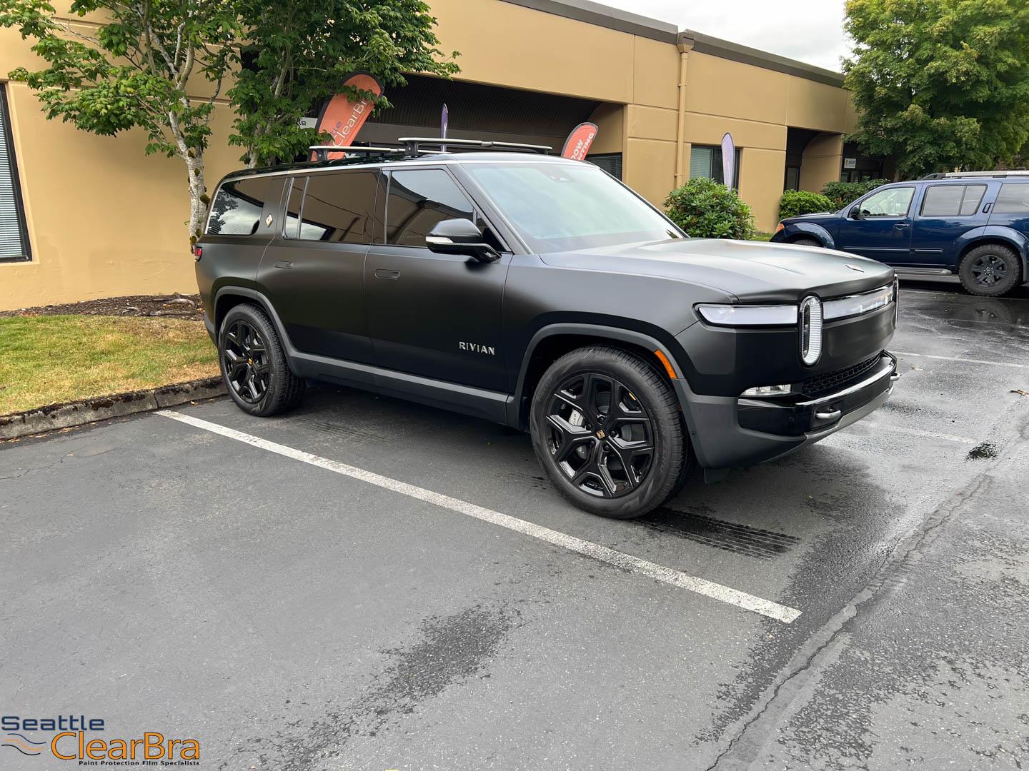

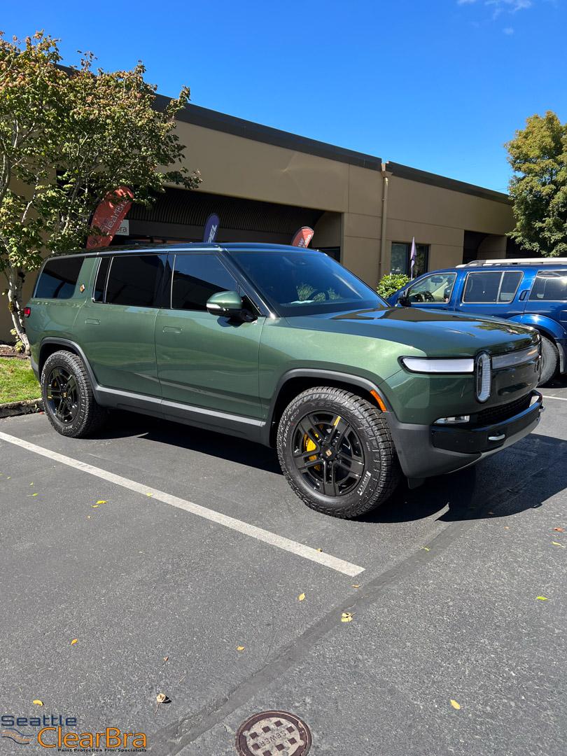

Another common questions we get is what kind of tint and what % of tint are other Rivian owners getting. While like a lot of things, it comes down to personal preference, there are some common trends we see. Choosing which level of tint usually comes down to how much the heat bothers the client, if their skin is sensitive to the sun, if they are driving around children and price.
While the options and brands vary at shops in the area, we use XPEL Tint and we offer 3 different levels of film to choose from.
Color Stable - more commonly called CS - Carbon tint - rejects 99% of UV and has some glare reduction.
This is typically your cheapest tint and most people will get it for privacy or aesthetic. People who get this tint usually get it in a 20% or 30% on their front two windows, so that the windows match the back better. 20% means that 20% of the light is still coming through the windows. If their back windows do not have a factory dyed glass, then they typically get it on the back side windows and rear window as well.
XR Black - Nano Ceramic tint - Single layer tint - rejects 99% of UV and 78% of IR - has more glare reduction then CS.
This is one of the more common tint option for our Rivian clients, is provides a good amount of heat rejection. One of our more common requests is 70% on the windshield, 20% or 30% on the front two side windows, 70% on the back side windows, rear windows and sunroof.
XR Plus - Nano Ceramic tint - muti layer tint - rejects 99% of UV and 96% of IR - has the most glare reduction.
This will be the most expensive tint and best for those who have kids, have sensitive skin and wants the most protection.

Rivian R1T R1S Common Tinting Practices Seattle-clearbra-redmond-tint-nano-ceramic-xr-black-xpel-6
Rivian R1T R1S Common Tinting Practices Seattle-clearbra-redmond-tint-nano-ceramic-xr-black-xpel-24
