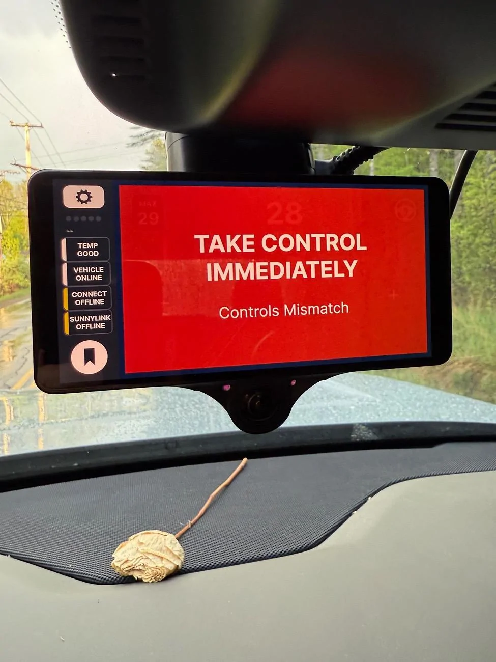

Have you seen this error? I have tried to uninstall and reinstall, but keep getting this error message on the road and it just quits while the speed is frozen at whatever speed it was at when it stalled.

Hmmm. I think I may have found it? I am getting an error message, then have to both reinstall and hard reset, but it continually comes back. Is this what you are referring to?
