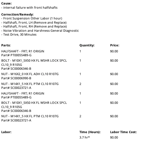

I dropped off my '23 R1S (18k) to address the tocking issue this morning, and got my vehicle back in the afternoon. Attached is what they did.
For me, the tocking sound would easily happen at low speeds, when going from acceleration to deceleration, and vice versa. I was able to reproduce it for the service rep about a dozen times just going around the block at the service center. During the drive, the service rep had me worried when he said sounds from backlash are normal.
I thought the sound was coming from the rear, but I could be wrong. They replaced the front halfshaft and the tocking sound is gone. Fingers crossed that it doesn't come back, and that I don't have the same issue with the rear halfshaft over time.
Rivian R1T R1S Clicking noise from rear at low speed Screenshot 2025-04-14 at 2.20.41 PM
