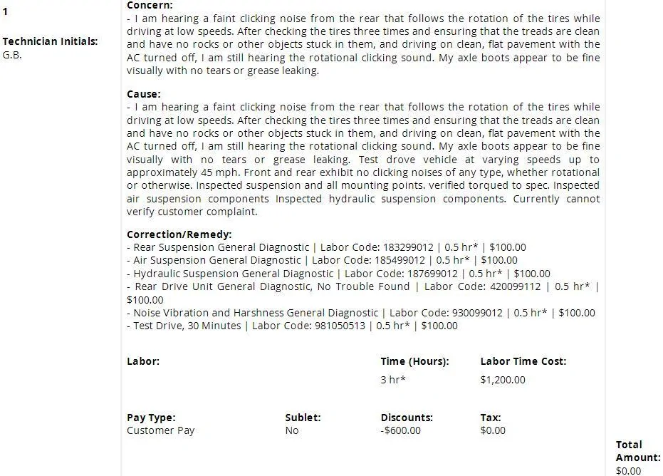

I dropped mine off at the SC on Friday of last week for this exact same issue at 15.5k miles. Been hearing it faintly clicking for nearly a month and after checking all the tires multiple times for rocks, nails or debris, the noise persisted and obviously follows the rotation of the tires. It requires the windows up and AC to be off to hear it clearly, but it sounds inboard around the right rear axle. It's persistently audible below 25mph as well, above that speed I can't hear it anymore, presumably clicking fast enough to blend in with the road noise.
Could be a hurt half-shaft, or a glittered motor at worst. Either way, I'll try to remember to share what the SC finds here.

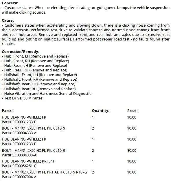

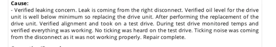

I had this a while back, faint clicking sound from rear. Changed with speed as described. Finally noticed a small oil leak on rear passages side. Ended up being damaged rear drive unit. They ended up replacing it and it resolved the clicking noise also. Take it in to service. Added picture of service notes.

Update as promised.
Rivian R1T R1S Clicking noise from rear at low speed Screenshot 2024-10-01 141324
At drop off, a courier rode with me and confirmed they heard it. After sitting on the lot for 3+ weeks, they called me last Thursday and said they couldn't hear it and I assured them it was audible with the windows up and AC off.
At pickup today, I still heard it and had a technician ride with me and they confirmed they heard it from the inside, but not from outside. The said they could keep it and continue with more advanced diagnostics, but I declined. I want to get as far away from that Wrangler 4xE rental as possible.

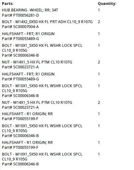

Anyway, they initially said they would just replace some spacers or washers... it's the "ting washers", I think. However, when they called me to tell me the work was done, they said they replaced everyting (sorry, I couldn't resist). Here's a screenshot from my work order:
Rivian R1T R1S Clicking noise from rear at low speed Screenshot 2024-11-11 at 12.32.30 PM
Rivian R1T R1S Clicking noise from rear at low speed Screenshot 2024-11-11 at 12.32.57 PM
I hope that helps!
