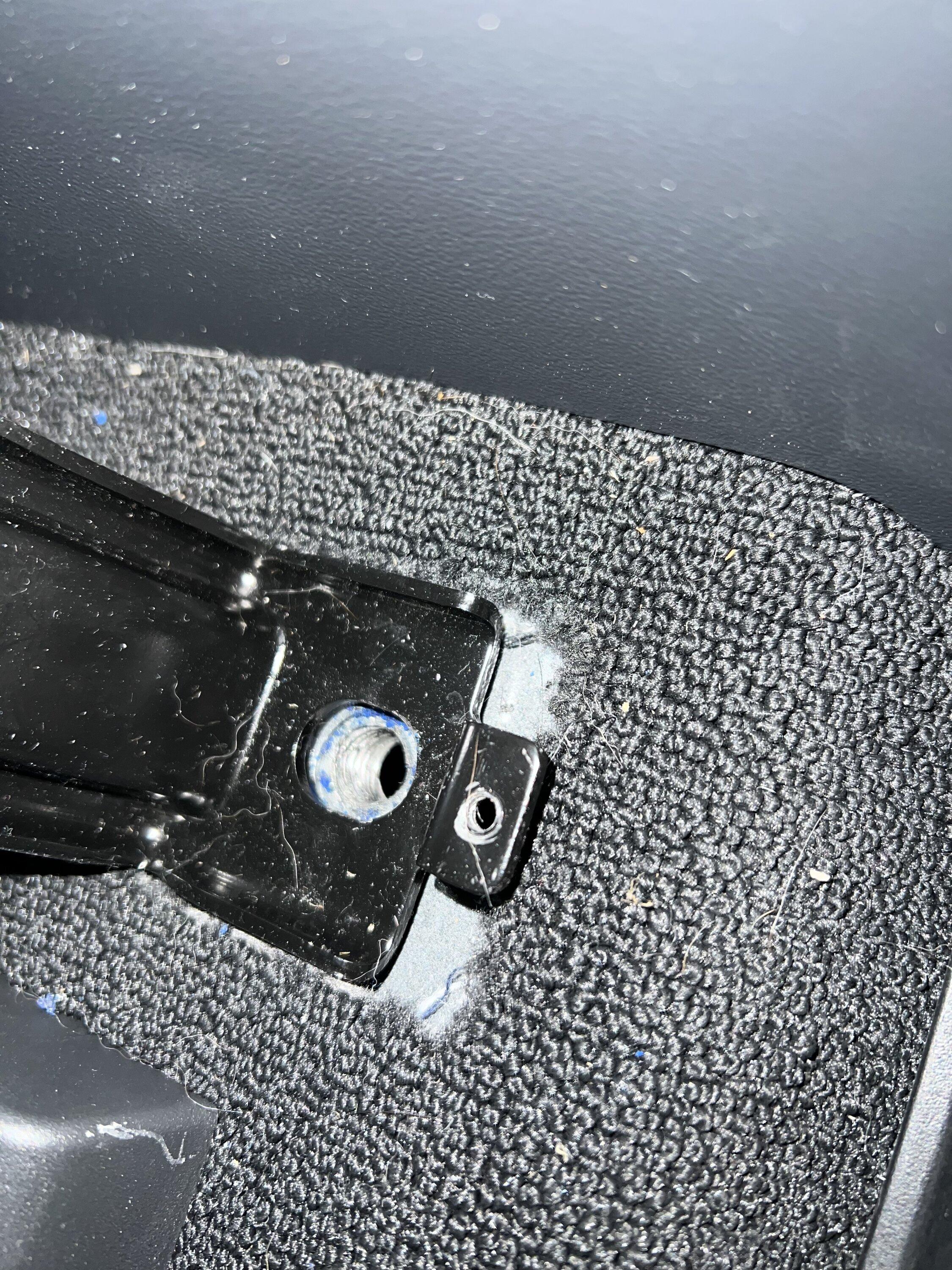

I have had some strange movement when leaning certain directions in my front passenger seat for as long as I’ve owned the truck, which normally doesn’t bother me because I’m not a passenger usually. This time after my dad rode in the truck and commented on it, I went hunting.
It didn’t take long to see the problem.
Posting in case it helps others find similar issues. I’m getting a service ticket created for this asap.

Man.. too many of these screws missing bolts loose. QC is a mess. If we were talking hundreds of thousands of vehicles being delivered and singular instances ok.. but with these low volumes, seriously concerning.

Is the blue stuff loctite?

Unless poppa Smurf been plugging the holes

There was one a few months ago with a vin in the 4000's with two missing seat bolts.

Monday build date?

Yes, sure seem like it. Abd why are there dried loctitie pieces on the carpet. What's going on here?
OP took the bolt out for the photo

I'm going to guess that vehicle is one of those where they had to replace the front passenger seat because of the sensor issue earlier this year.
That is my guess too. I am thinking alot of stuff we see on the internet isn't actually assembly line random variation, but rather botched post assembly line repair, rework, etc... But just a guess....

Just an update to this: Around the same time I posted the thread I also submitted the picture and info to Rivian service. Today I was contacted and asked to schedule a pickup for tomorrow. They seem to be treating this seriously, which is appreciated. Unfortunately the closest service center is Atlanta still, and i'm in the Nashville area. They're also going to knock out a few of my other less pressing service tickets while they have it.
