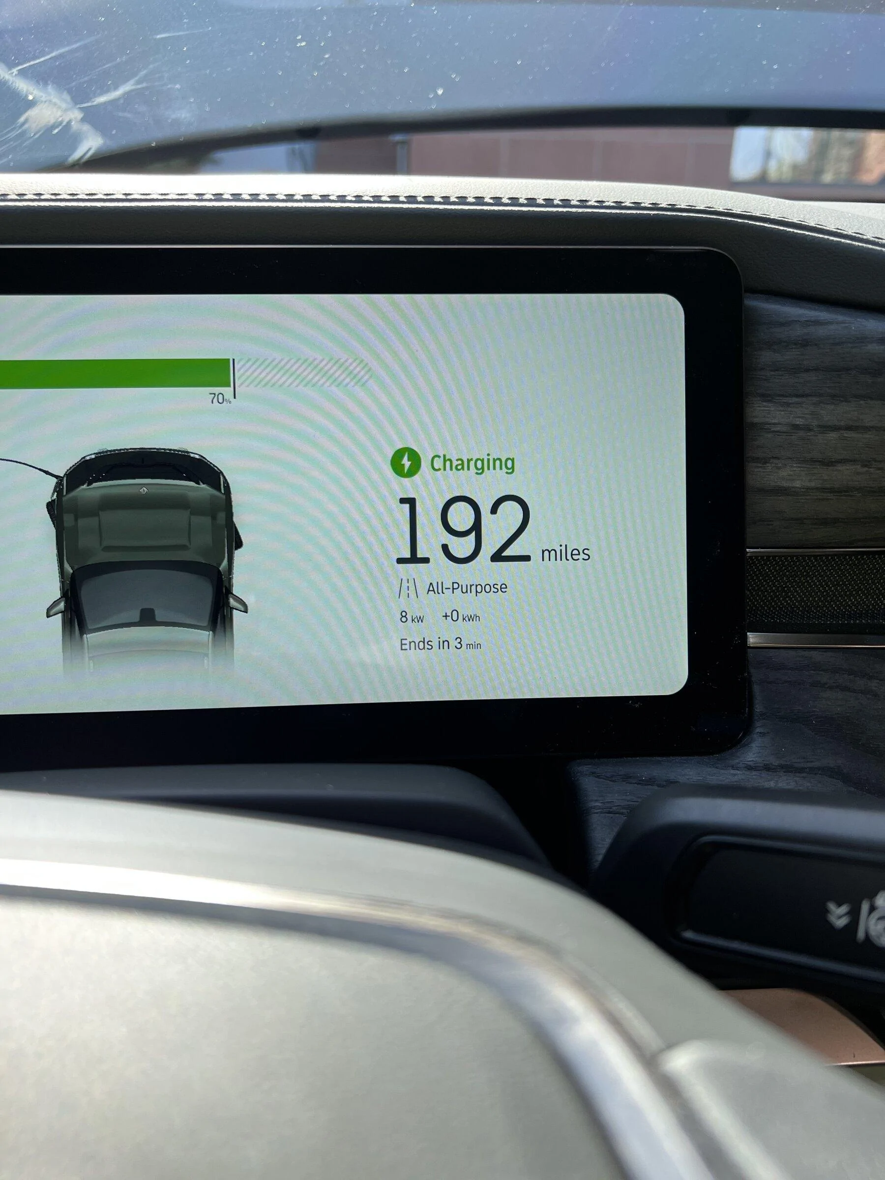

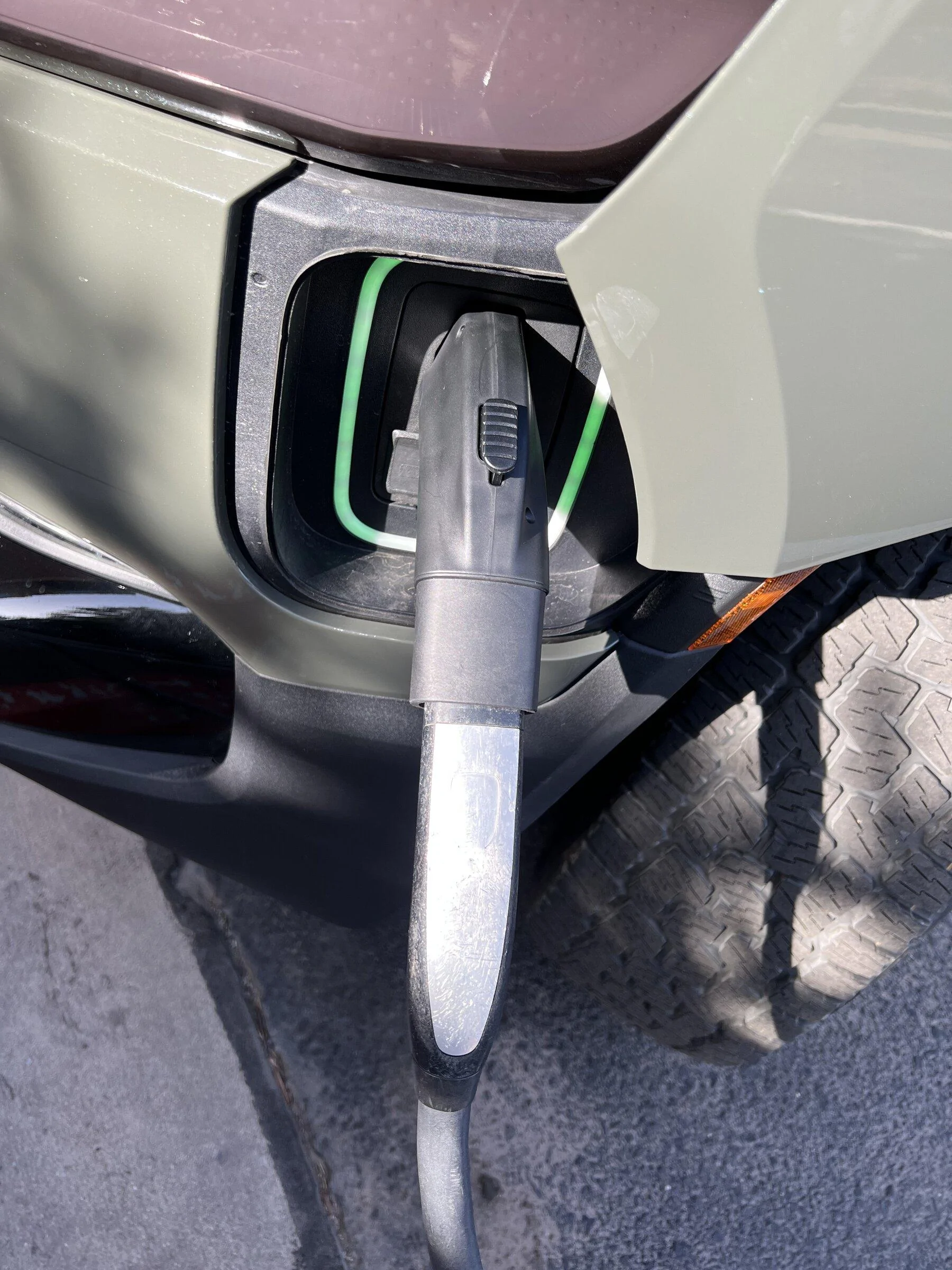

I just tried my Lectron at a Tesla destination charger for the first time today. 8kW - 12kW at roughly 70% SOC. I think thatā€™s reasonable.
Interesting.... thanks for the data point.
Remember at level 2 chargers your SOC doesn't matter. You should be able to get a constant 12kw (when it's a 48amp connection, as was the case with you)
Thanks. I did not know that. Thatā€™s because the L2 is at such a low ā€˜rateā€™ it can stay constant?
Yes, no thermal throttling needed at that charge rate.
