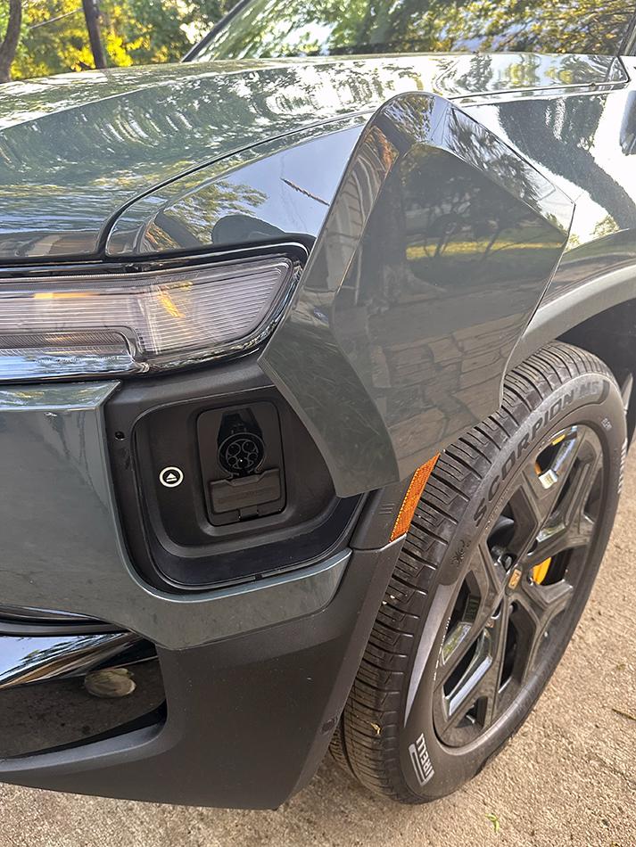

After using a Tesla supercharger for about 40 minutes, I pushed the manual button to close the port door.
The light comes on, but nothing happens. I then tried closing the port door from the vehicle display and then the phone app. Nothing.
I drove off to repark. Still open. I did my first ever soft restart followed by the first hard reset I've ever done.
After that I had to drive home about an hour at highway speeds. It made me a bit nervous because the port door is basically flailing around in the wind going 75.
First appointment is middle of June. Vehicle is 3 weeks old.
Anyone else experienced this? Googling showed me some folks have had theirs get stuck partially open. I didn't see any posts about it being all the way open.
Rivian R1T R1S Charging port door will not close IMG_0908

I used a damp cloth to wipe down everything in and around the port. I also used canned air to blow out any debris. Under controls, the Rivian app says, "couldn't open charge port - obstacle detected".
More info shows "Couldn't close charge port - An object was detected so the charge port door can't close. Check to make sure the area is clean then try again".

Luckily dispatch reached out to me from the Rivian app, and they are able to get me into my local service center today. They said they think they know what the issue is, and it should be a 24 hour turn around.
That is great news. It's supposed to rain here all week starting tomorrow and I was really worried about getting water inside the charging port.
I did order a charging port cover dust plug/waterproof protector cap and a
BestEvMod charger rain/snow cover from Amazon but they won't be here for 2 more days.
Will update post when I find out more. I have a feeling that the issue is a charge door actuator failure.

Rivian shop ended up needing to order parts. Still in the shop. Their estimate is that it will ready tomorrow.

Got my vehicle back. Here are the details if anyone cares:
Cause:
- Found the charge port door actuator fully stuck out pushing against the door bracket and
body, damaging the bracket, stem, and plate. Internal issues with the actuator.
Correction/Remedy:
- Actuator, Charge Port Door (Remove and Replace)
- Bracket, Charge Port (Remove and Replace)
Parts:
Snap Ring
Part# PT00053406-B
POWERED_CHARGE_PORT_DOOR_ACTUATOR
Part# PT00676241-E
POWERED_CHARGE_PORT_DOOR_STEM
Part# PT00712166-E
POWERED_CHARGE_PORT_FACE_PLATE_PEREGRINE
Part# PT01140220-B
POWERED_CHARGE_PORT_BRACKET
Part# PT00712168-E
Service center in Austin turned out to be a very positive experience.
