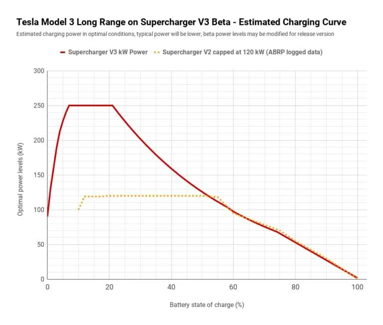

People seem to get all hung up on this. ---- Yes we do. The V3 Tesla 250kW statements are just PR and do not reflect overall average speed/time. Not all vehicles take 30 minutes to reach 80% SOC. The soon to be released KIA and its twin Hyundia EV are advertising closer to 15 minutes with their 800V battery packs.
Rivian R1T R1S Charging curve.  Has it been documentated/displayede? tesla V3 peak charging curve

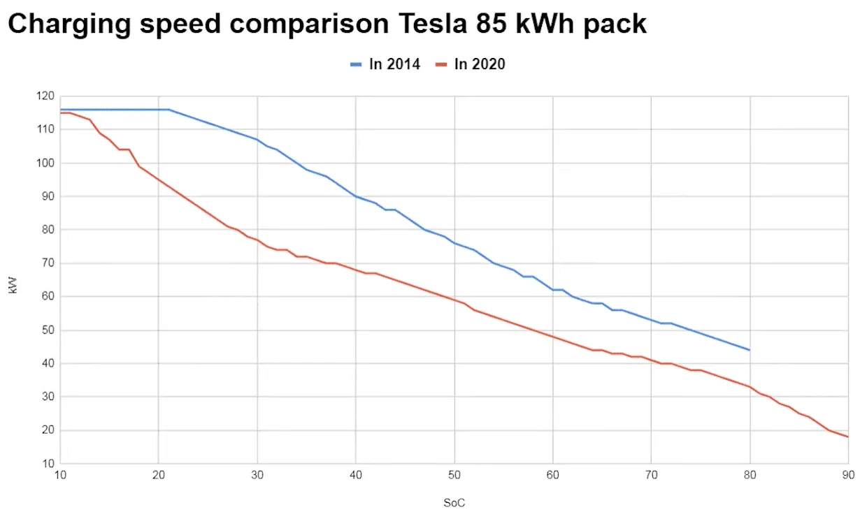

Rivian R1T R1S Charging curve.  Has it been documentated/displayede? tesla reduced charging speed over time

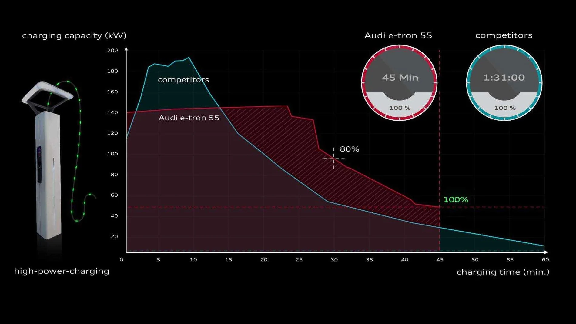

Rivian R1T R1S Charging curve.  Has it been documentated/displayede? audi verse tesla charge cuve

Etron
So does this mean 280 miles in 40 minutes? Electrify America has DC charging of up to 350 kW along most Interstate Highways which would mean that my trip from MT to AZ would require 10 charges at 140 miles per charge. The Wife would not like that.
I would use A Better Route Planner. Select the Audi e tron as the vehicle, but change the reference efficiency from 2.4 to 3.6 mi/kWh. This will effectively increase range from 200 to 300 miles.
Now route your trip and see what it says. the eTron is currently the most effective charging EV out there, being able to sustain 150kw from 0-80%, and then only tapering down to a minimum of about 50kw at full. The planner is likely only going to have you charge to around 80% at each stop though to make a more efficient trip.
It sounds like Rivian will be better than this, at least in peak rate, but we don’t know full story yet. So what I described would hopefully be worst case.
