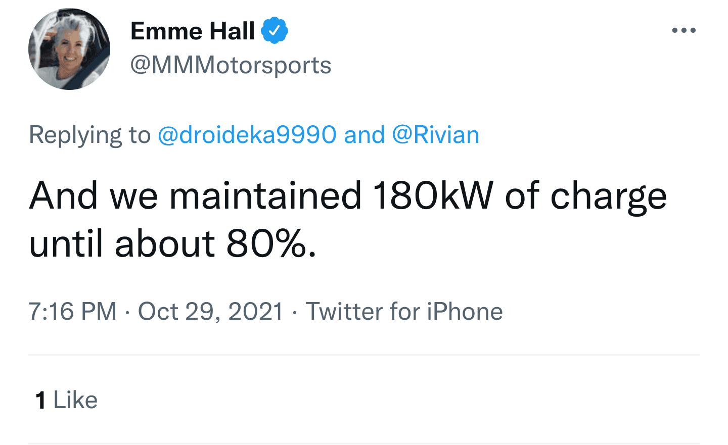

Circling back here, the user I was referencing yesterday says they had a peak of 170 kW, and had said they'd be at a 350kW charger. At that point the truck has been driving on the highway for quite awhile, so I would assume it was warm. Another owner reported 29 minutes go to from 51% to 80%. Other than Emme's data point, it seems like the curve tapers quite a bit for the current owners. Worth noting that you can still achieve Rivian's 140 miles/20 minutes from a low SoC with the curves the current owners seem to be observing.
I'm definitely taking this with a grain of salt, but it would be nice to be able to confirm what Emme saw. I kind of want to ask her if she meant to type in 80kw instead of 180kw. That would more closely match what the owners seem to be seeing.

Maybe not needed for the race, itself... But consider that a custom software build would allow Rivian to test things and gather some great data. The faster charge curve may not be needed to satisfy Emme, but it could give Rivian valuable information about how the truck handles it and what the effect to battery longevity may be.
Not saying it is custom software or stock…. Just saying it is entirely plausible that it is custom.
They absolutely had a custom S/W build for Rebelle Rally. there are various restrictions placed on every vehicle, like not being able to use GPS/map. Rvian had to disable a number of things on the system so its possible they also enabled some other things to track, help the drivers and help Rivian collect data.
SeaGeo
Brice
Jan 12, 2021
5,258
9,697
Xc60 T8
Agreed. We aren't seeing a similar curve as what Emme had.
