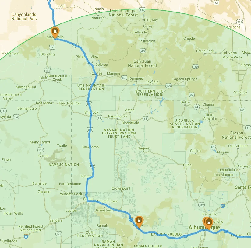

Thoughts on how to do this? Plugshare shows nothing other than a few random J1772 going US550 to US491 until Monticello, UT. 311 miles (aka not gonna make it)
Only option I see is leave Albuquerque over to Grants, 100% charge at the AE at Walmart, then squeak the 251miles up US491 miles to Monticello at the Frontier Museum for 125kw chargers. Is 251miles cutting it too close?

Take the Santa Fe/Pagosa Springs/Durango route, charging at Chargepoint units in the latter two. The longest stretch is about 150 mi. There is EA in Santa Fe as well.
The Chargepoint units in Pagosa and Durango are the CPE 250 units, which are 125kw shared units. You'd think that it would be possible to get the full 125kw if no one else was there, but unfortunately that's not the case. However, I've found with my eTron that it's not the 62.5kw necessarily either. I've seen around 80kw when alone.
It's probably a little longer, but you don't have a 250mi ass puckering stretch either and at least those are nice little towns for a stop. You'd probably want a longer meal stop somewhere along the way anyway. The elevation in Grants is about 6400ft and it is over 7000 in Monticello, so you have a climb to get there. Any headwind and you're in trouble.

Routing in PlugShare kinda sucks. I'd recommend ABRP for routing over PlugShare any day. That said, I'm seeing an EA station in Gallup that it didn't use on the route for whatever reason. There's also a slower ChargePoint unit in Bluff, UT.

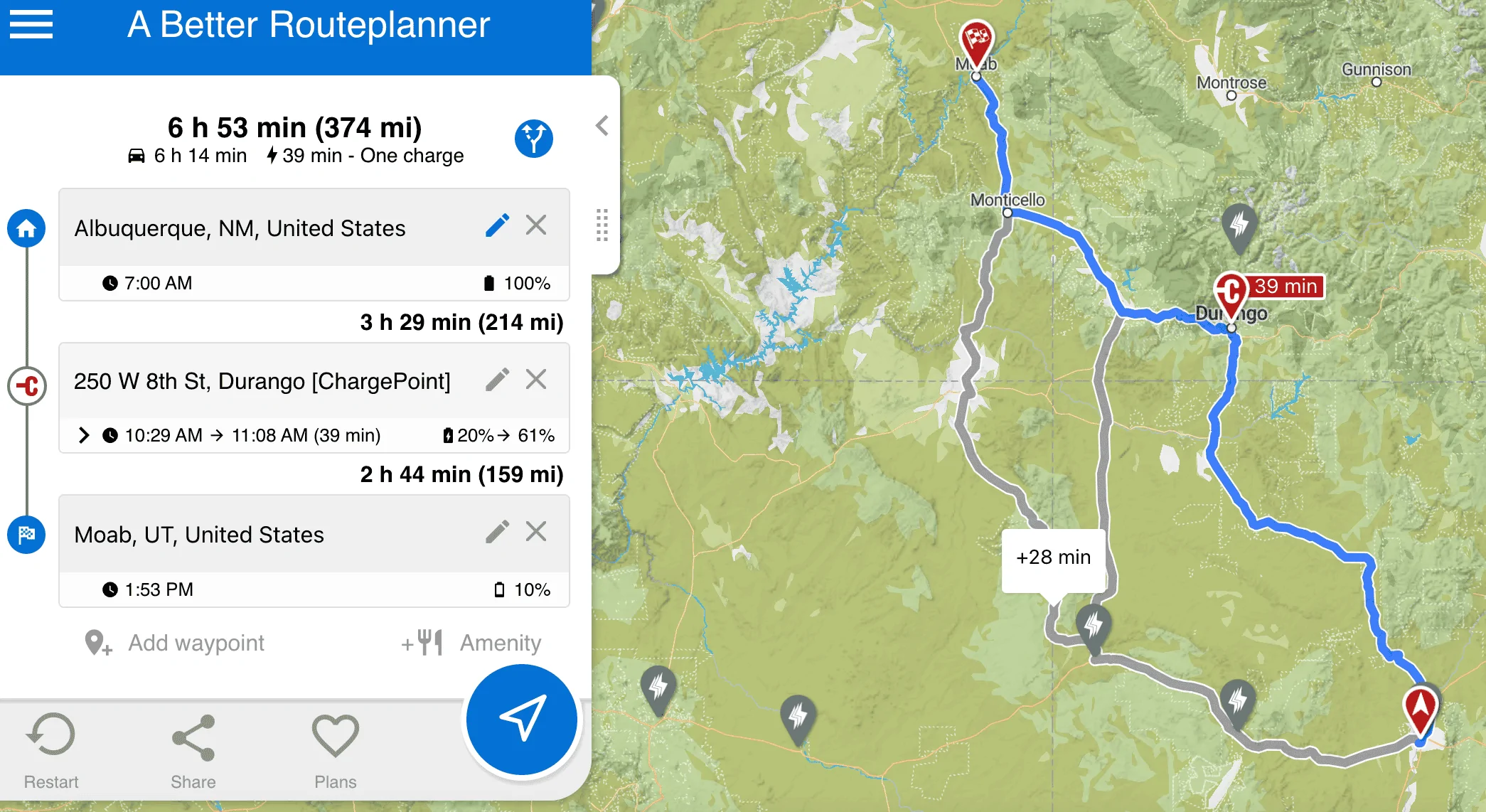

FWIW, here is the ABRP solution. ABQ to Durango is a 1200 ft climb, so keep that in mind. However, ABRP is factoring that in and thinks you should get there with 20% or so. That's using 2.4mi/kw as the reference consumption at 60mph. At 2.2mi/kwh, it would be 13%. So, still a somewhat decent buffer but you'll want to check your winds.
Leave in morning, eat lunch in downtown Durango, nice little trip.

It looks like Durango it is! Thanks everyone.
