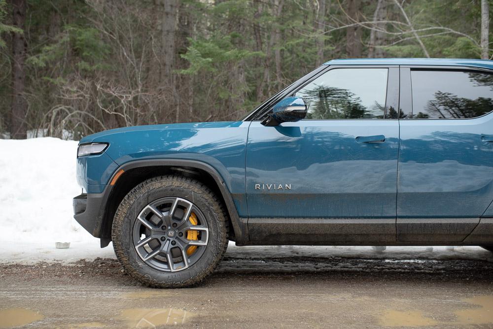

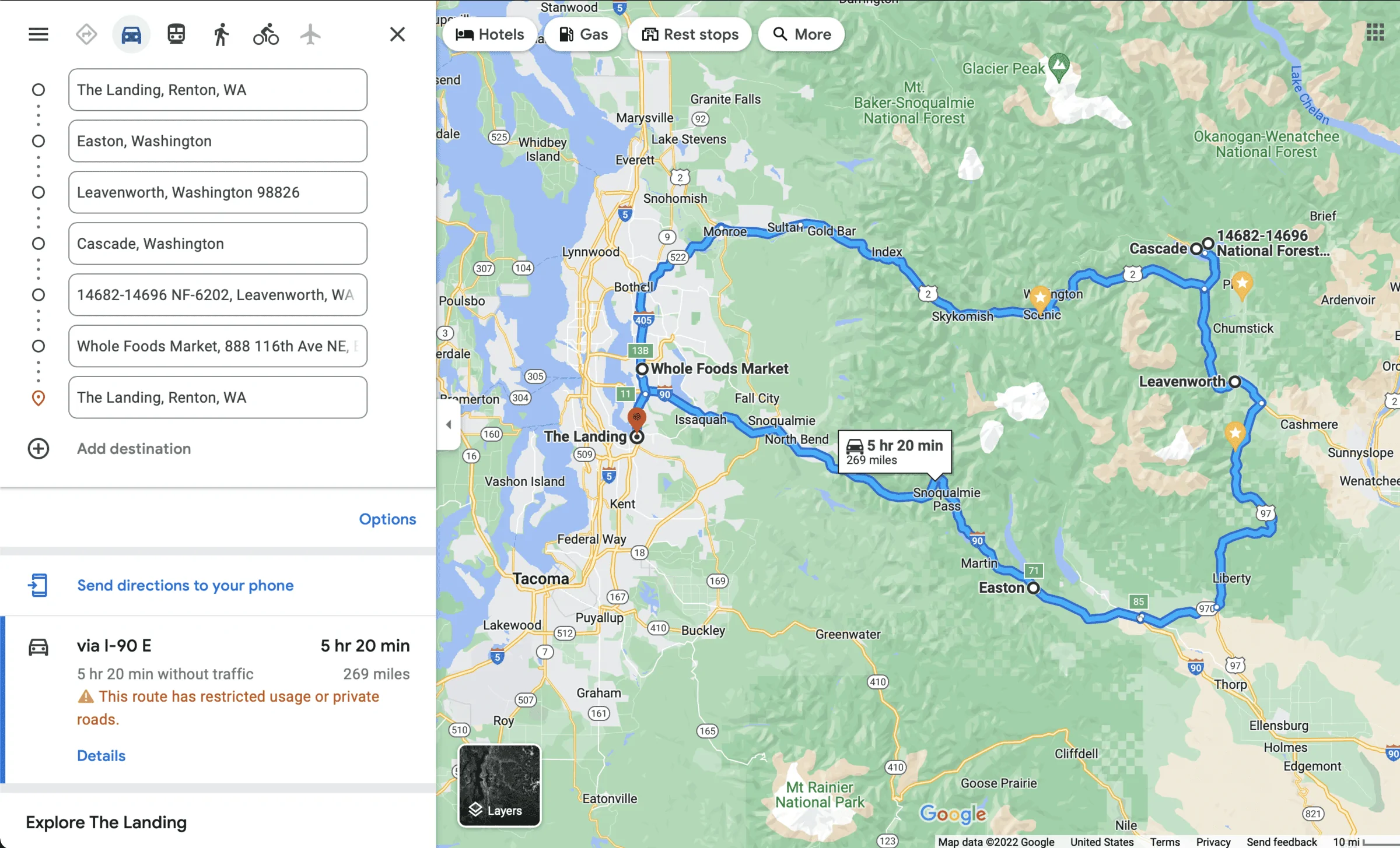

Today, we drove from south Seattle over Snoqualmie, Blewett, and Stevens passes, charged with EA and EVGo, and found a little mud, ice, and snow for good measure.
We drove 289 miles, generally at the speed limit (70 on I-90, a bit slower on the secondary highways). We left home with 69% state of charge (SoC) and 188 miles on the range meter.
No significant wind, mostly sunny, temps in the 40s ish. A little rain as we descended Stevens on the way home and rainier once we were in the lowlands.

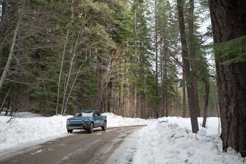

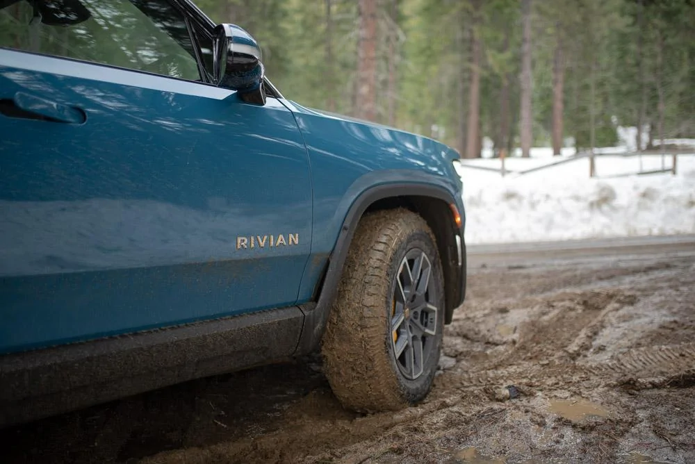

From Leavenworth, we drove up to Lake Wenatchee and found an icy, muddy dirt road. We didn't take detailed interval logs here, but it is worth noting that when we returned to the highway, our efficiency had dropped to below 0.8 miles per kWh. We were going slow, stopping for photos, running the dogs, and running the climate the whole time. But yikes.

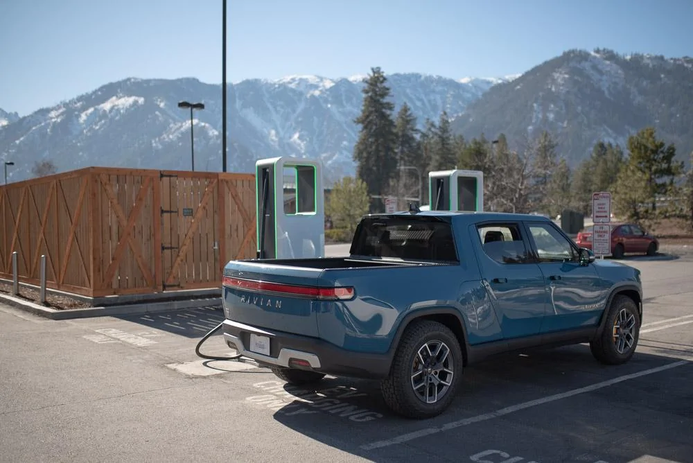

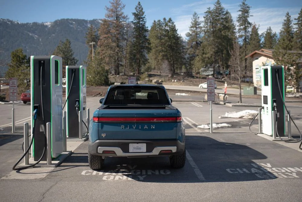

We used two DC chargers for our trip. The first was the EA in Leavenworth. We already have EA accounts (set them up for the free charging when we bought the ID.4). Plug in, tap, it went. No drama.

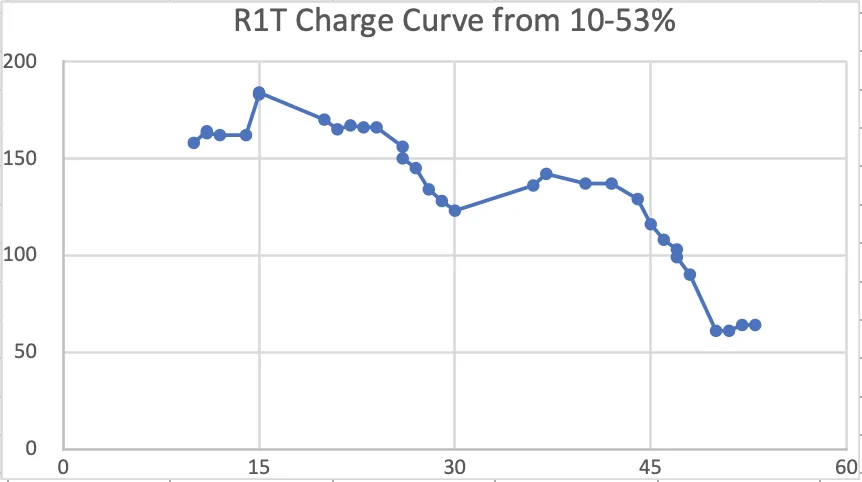

We arrived at this charger with a 10% state of charge and stayed for 30 minutes, adding 119 miles and 43% SoC. Peak rate was 194kW.
Here's our graph of Charge Rate (kW) vs State of Charge (%):
Session info from EA: 30 minutes, 19 seconds; 66kWh @ $0.43/kWh = $28.38.
Not impressed. 30 minutes for 119 miles during the optimal part of the curve is far short of 140 miles in 20 minutes (I supposed you can adjust to 85% of 140 for the ATs, but that still means I'd expect my 119 miles in 20 minutes not 30 -- it takes 50% longer than the marketing text promises). I really hope this improves as they gather data and confidence.
