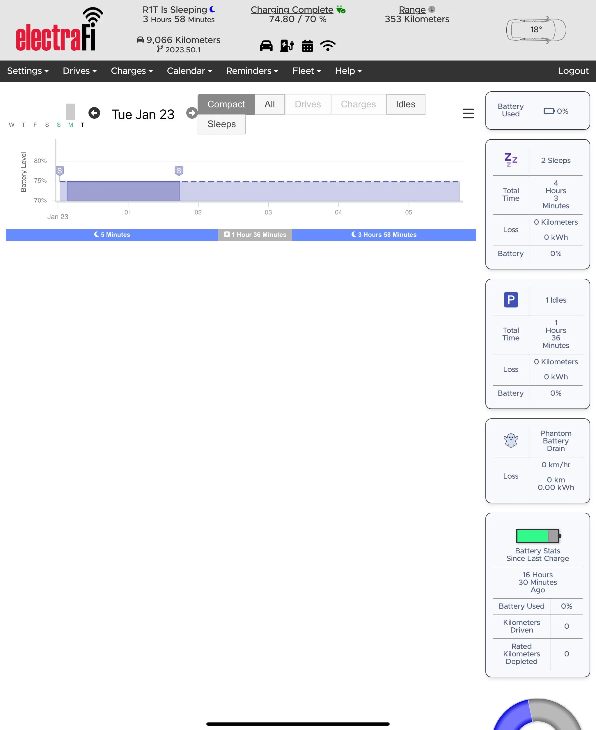

Regarding the screen staying on, i tested different variations of proximity settings in the vehicle, just to sumarize that ideally Rivian would address the Proximity polling when parked at home to be less chatty in polling for a nearby device, as this is what is keeping the device screen on at certain times. (I wonder how much this also impacts the vampire drain some people referenced in other unrelated threads)
I think you are right about this and the vampire drain. At home, my phone and fob are above the garage and I think this is frequently keeping the vehicle awake. I signed up for Electrifi before leaving the vehicle at the airport. The truck is spending way less time awake there. I’ll see what happens when I head home.
(I let the truck charge to 75% on the first day, then set the charging level back to 70% to account for vampire drain over the days I’m gone)

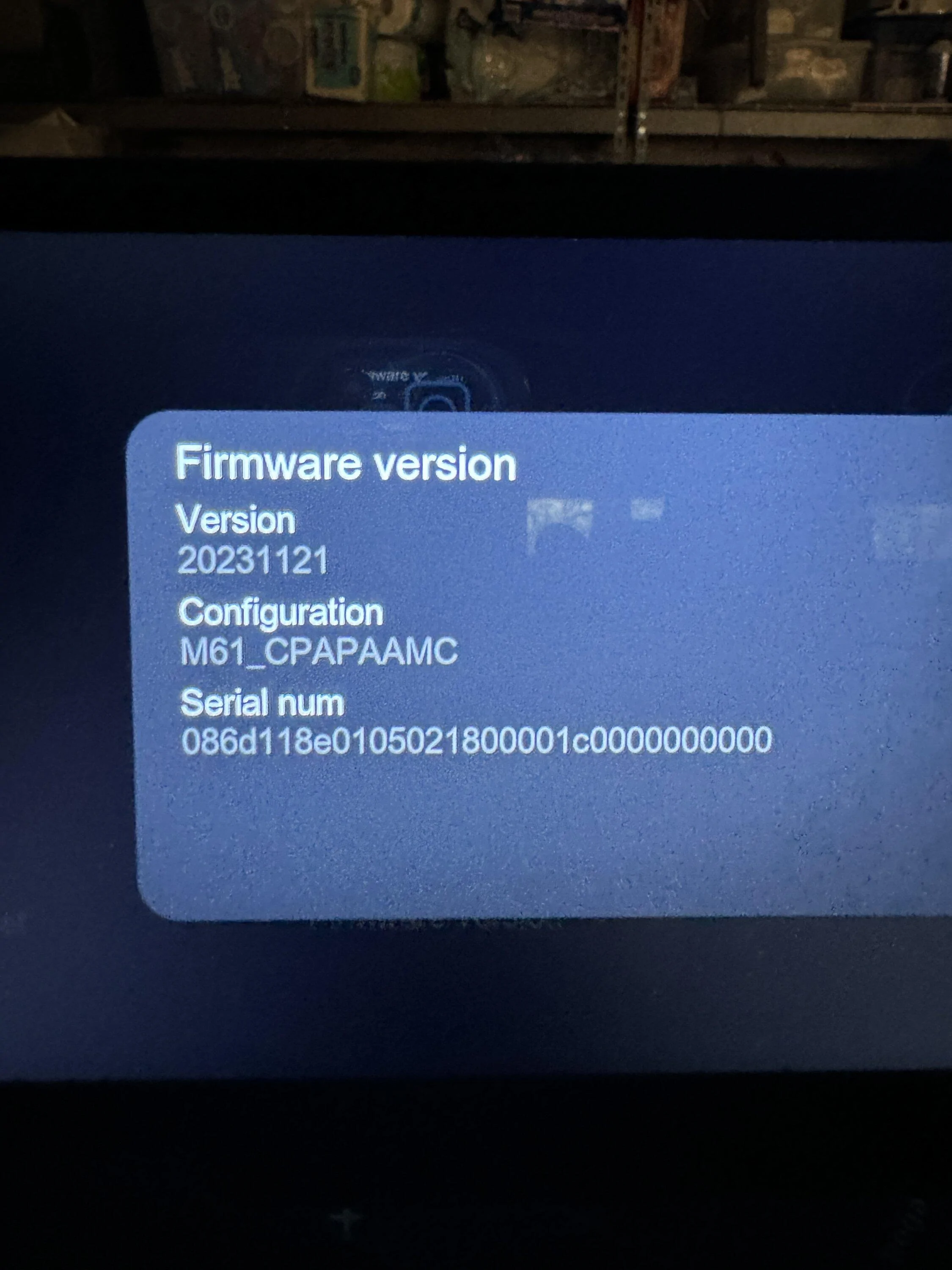

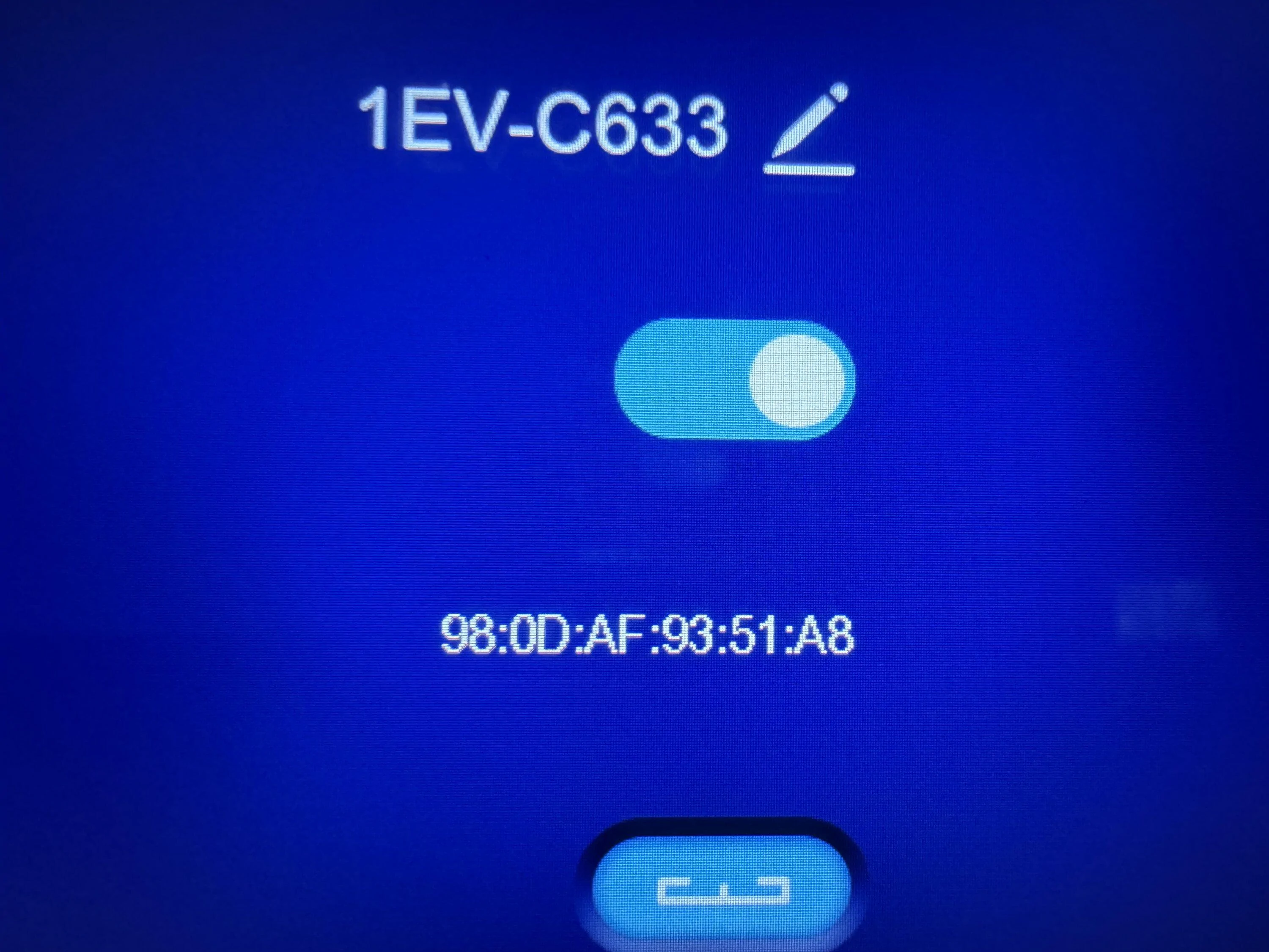

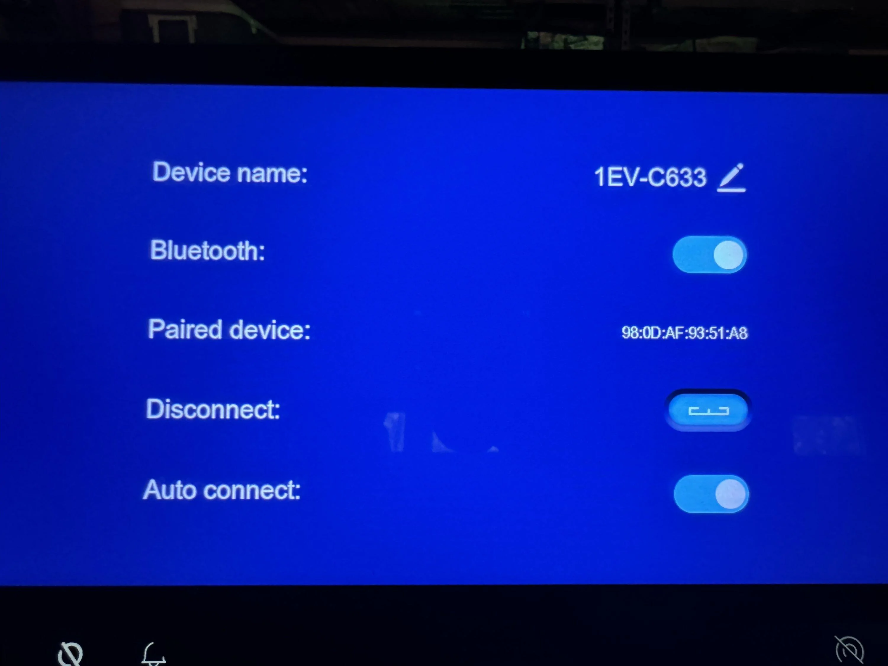

Hey everyone,
I successfully installed the CarPlay screen and everything was working perfectly! Then I tried switching to AirPlay to test streaming YouTube, and couldn't get that to work, then I did everything they showed in the install video to go back to CarPlay, and it seems to successfully connect to the device, but CarPlay refuses to come back on.
(using iPhone 15 Pro, iOS 17.3 - see pic for EV1 screen firmware)
I have tried:
- Turn phone on Airplane mode
- Turn off EV1 device
- Turn EV1 device back on
- Turn off airplane mode on phone
- Select CarLink on EV1 Screen
- Locate device on Bluetooth and connect
- Accept all prompts to pair/connect and share contact on phone
- The EV1 screen then just sits on the connect instructions and CarPlay never comes back on, even though it shows that it's connected on both devices, and it worked the first time I tried it.
I have tried:
- rebooting EV1 screen and phone
- removing device from bluetooth and doing the connect process all over again (tried several times)
- I have also tried just waiting for several minutes and nothing
- reset EV1 device back to factory settings
- cleared all connected devices from EV1
- updating iOS
Any ideas to try?

We have an issue with airplay due to the new iOS 17.2.1, a new firmware update will be posted within a week! Thanks again

Cool, I just updated to 17.3 so hope it works! I guess you'll explain how to download/install?
the update is super easy. you can download our file and put it on a micro sd card, and insert the card in the dash. when the dash powers up, it auto loads the new firmware!
