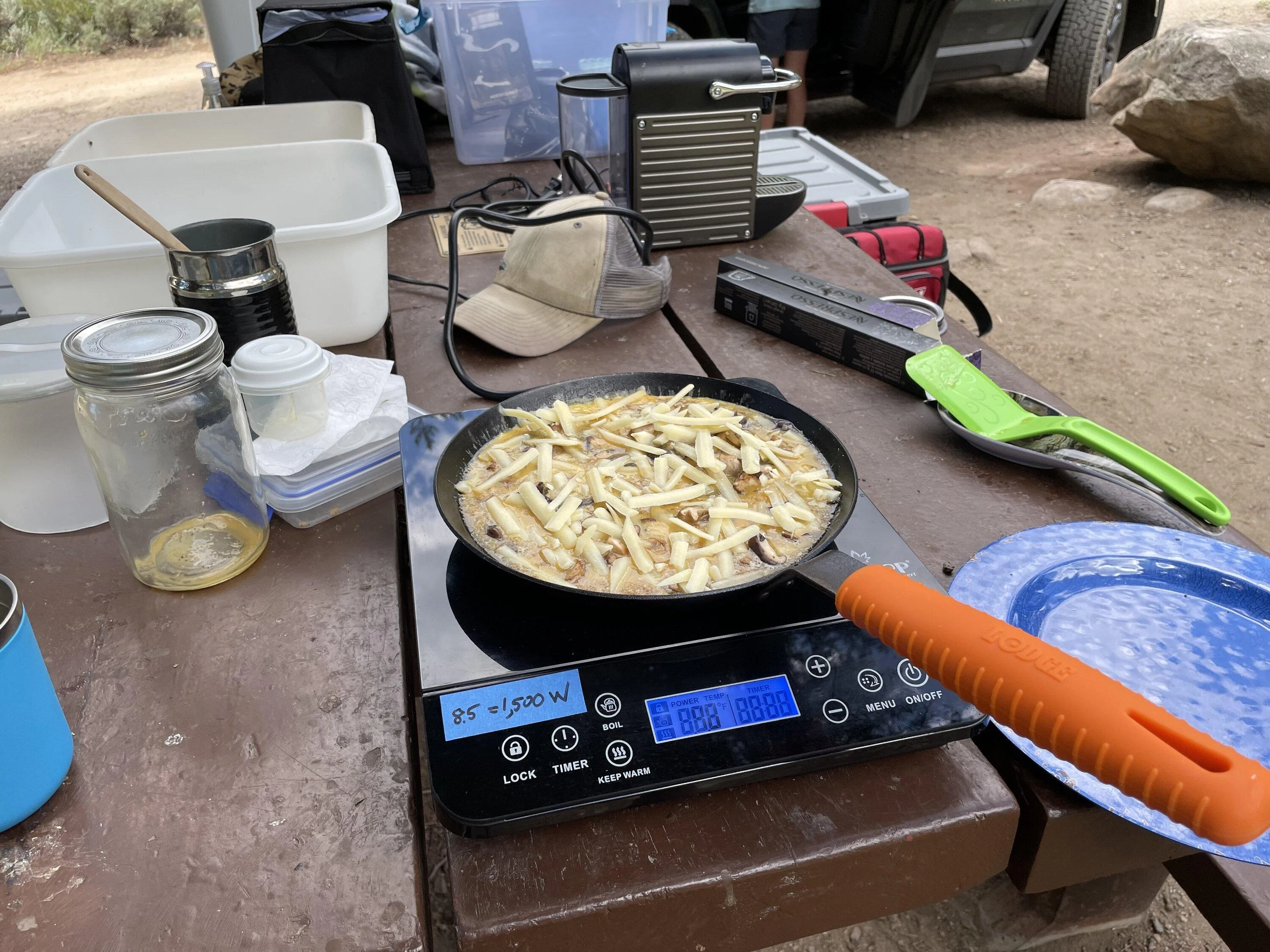

Rivian indicates a max wattage of 1,500W. The stove on Power Level 10 draws 1,800W, but the manual indicates a Power Level of 8.5 draws 1,500W. That is more than plenty for what I need. It would boil water way faster than my old propane camp stove.
Also, the Lodge 12" Carbon Steel skillet works perfectly with the induction stove. I also have a set of Green Pan pots that will work with induction, but I haven't tried them, yet.

As he just stated above "Rivian indicates a max wattage of 1,500W". If you go over the max, it *should* trip the breaker, so you could just turn it up until it breaks the circuit. But it's safer to know the limit ahead of time. Getting a Kill-O-Watt (also mentioned above) would be a good thing to use to check it at home before using it on your vehicle. This would work for whatever device you want to connect.
One thing to note is that the induction cook tops don't tend to use a constant power input. They tend to cycle to get their desired output. So, if you use the Kill-O-Watt, you may find that your induction cook top goes from like 900-1800 watts while between 5-10 power setting. If it does it quickly enough, the Kill-O-Watt won't be able to detect it, and then it probably won't be an issue for the R1* either.
The DC->AC adapters also tend to have a short term max higher than the reported constant power available. I haven't seen anything official, but I'd expect Rivian's absolute short term max to be between 1.8 and 3kw based one what I've seen with other aftermarket 12V AC->DC adapters. You'll probably be surprised to find out how much current/power some things draw when first turned on or plugged in compared to the average output. But again, Rivian's AC outlet should protect itself; still safer not to push your luck.
