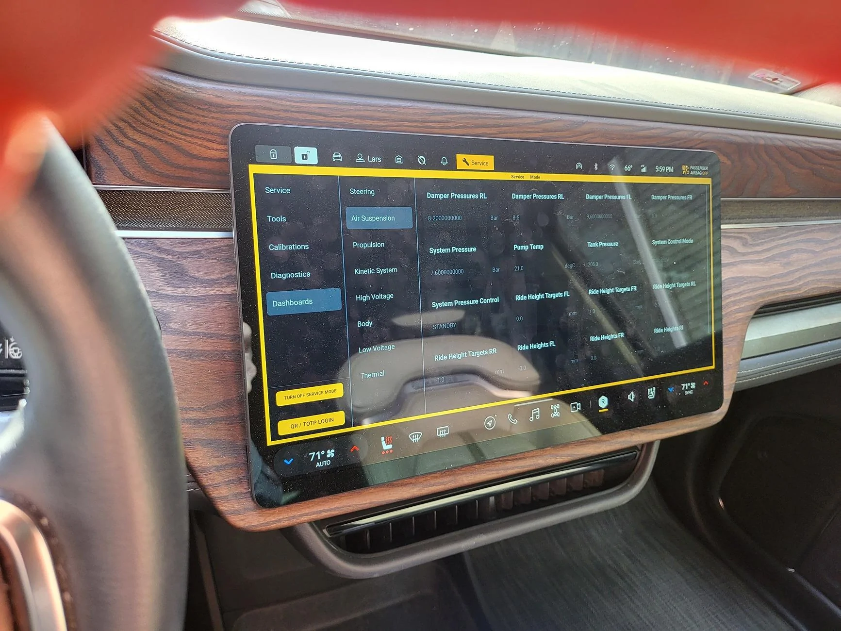

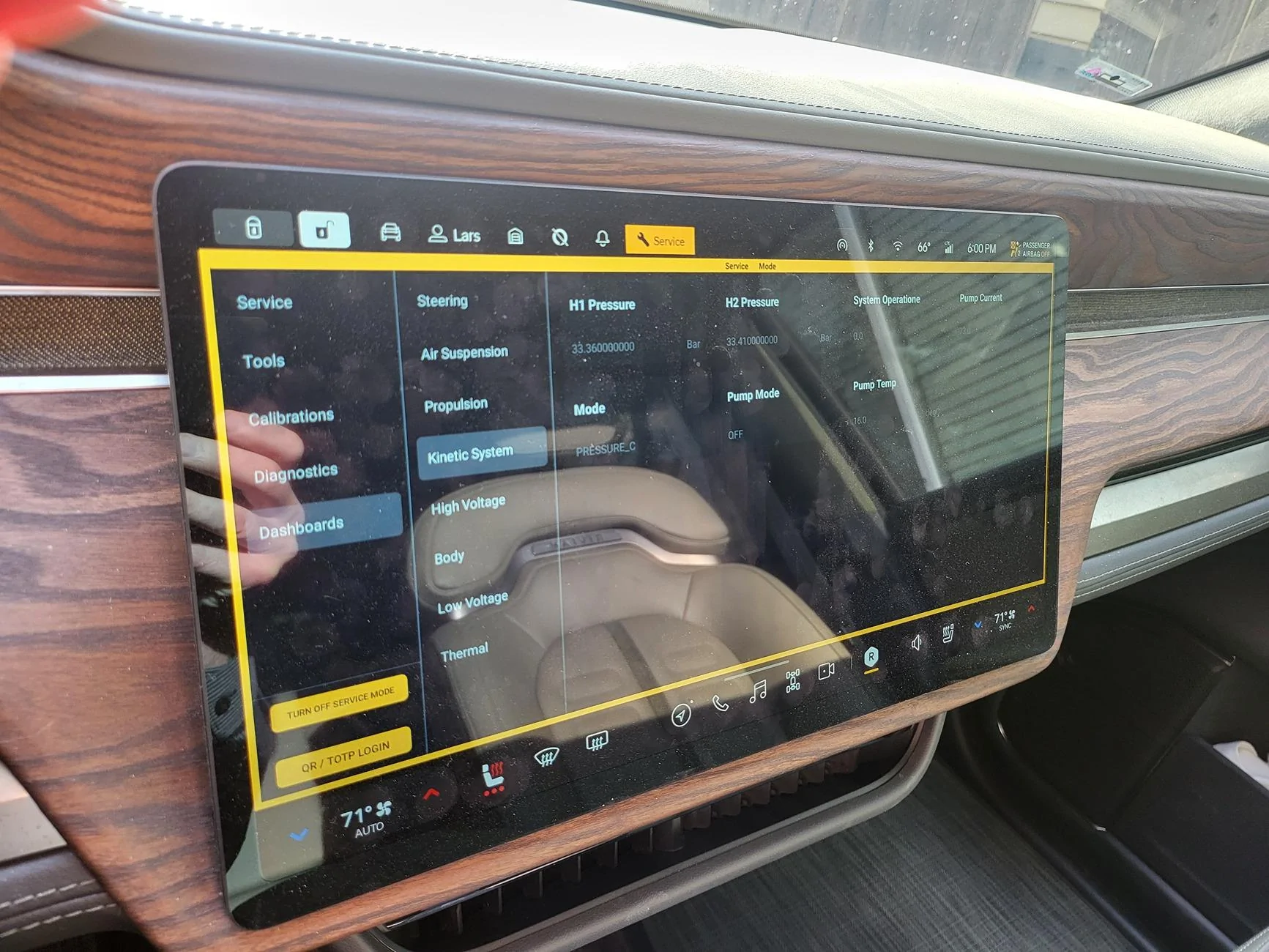

91107
The RIDE menu shows all the pressures of the struts. Might be a way to diagnose something like that.
How do you get to the ride menu? Is there a "normal" value to expect?
Thanks!
Settings, service mode on, tap top menu bar 5x, swipe from bottom and open ride app, tap on quote 5x, 33748, diagnostics, air suspension and kinetic system
