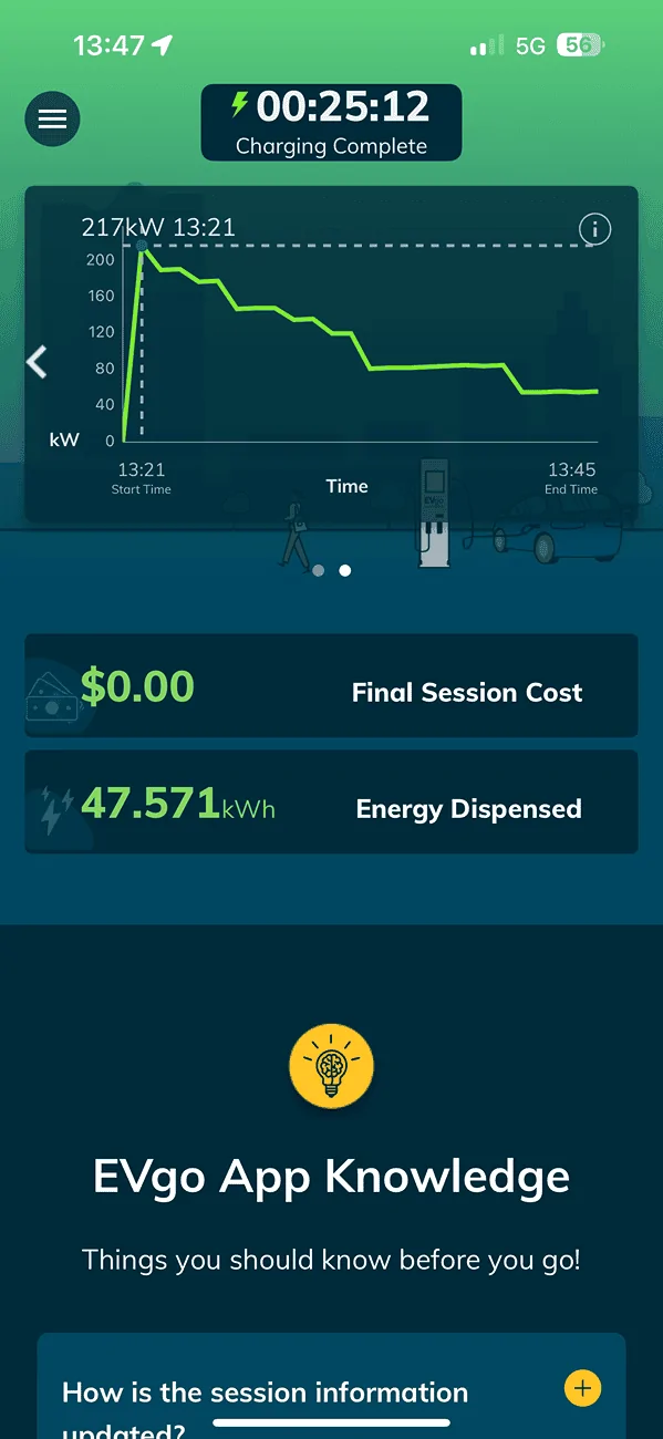

I’m lucky enough to charge at home but today I needed to fast charge to 100% as we were taking our daughter to college and I forgot to plug it in last night (doh). There are a bunch of EVgo DC fast chargers close to me so I thought I’d give them a go. I had to swallow the 69c/kWh as I needed a fast charge. I preconditioned the battery by navigating to the charger. It started well, 217kW speed but immediately dropped and ended up at 55kW with an 81% battery. I appreciate charge speed drops as the battery nears a full charge but seeing as the EVgo charger had a top speed of 350kW why did it drop off so much and so quickly??

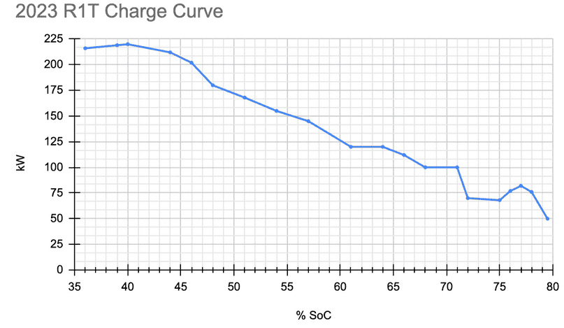

Unfortunately that's fairly normal - Best charging speeds are always near the "bottom" of the battery. Part of that is the natural charge curve of the battery, part of that is your Rivian trying to keep the battery temperature under control.
When road tripping it's often better to do more frequent shorter stops with high charging speeds as opposed to fewer longer stops

If you only received 47kWh of energy to get to full charge, that means you were already at almost 66% SOC when you arrived at the charging station.
That high arriving state of charge explains why the current tapered down as soon as it did.
Rivian R1T R1S Can someone explain….. 1723600811666-bq
6,027
10,252
Just the nature of the curve.
First, Rivian maxes out at around 217 kWh in the best cases, you will never see higher than that so using a 350 kWh charger is no real benefit. As a matter of fact the difference between charging at an EA 150 verses an EA 350 might be a couple of minutes as I see in the 170s frequently on the EA 150 chargers.
As the percentage fills up it will slow down, especially once you get over 80%, I never got to 100% as the miles I get from 95% to 100% just is not worth the time it takes. There are many articles out there on charging curves both in general and Rivian specific, I suggest tracking one down just to better understand the challenges for charging EV batteries.
