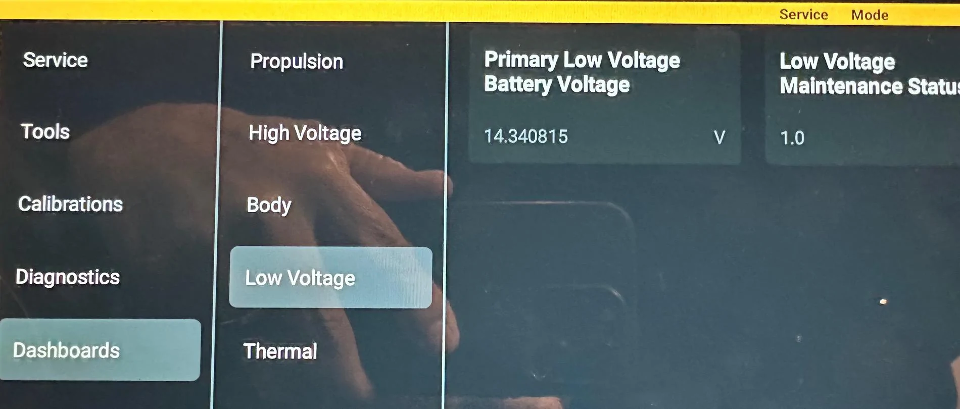

Hi, I am seeing all of the posts about the failure of the 12V batteries; has me a bit concerned. Is there a way I (the owner) can run a diagnostic in service mode on the 12Vs that would provide me an indication I can understand so I would know if I need to request a service ticket?

There is a “Ride” menu, sort of diagnostics service screen, you can search this forum for information on it how to get to it and the pin for it.
If I go into it, shows my low voltage battery at 14.1 volts which is in the healthy range of 12.6-14.7 a 12 volt battery would be. I will occasionally go in and look just out of curiosity.

This is my status tonight;
How long can it go below 12.5 before it fails? Since we can't see a log, we can't see progressive decline and predict failure.

I was answering the OP question about a way to run a diagnostic. Looking at this screen shows the volts without needing to get out a volt meter and attaching it to the battery.
I’ve probably looked at mine at least 6 times and have never seen it below 14, if I saw it getting into the low 13s I would probably check it more often, if I saw it in the 12s I would probably schedule a replacement.
Not aware of any diagnostic tool that would give you a detailed log of historical battery voltage. Not saying there is not one out there, these days it is possible there is something you can purchase to install and collect that type of historical data just not sure that is what the OP was asking about.
Checking the voltage like you are is not indicative of battery health at all. When the vehicle is on, the HV battery contactors are closed and voltage is being supplied to the 12v system. The only way to to get an accurate voltage is to read it when the vehicle is asleep, but there is no official way to do that. Several of us have built low-power Wi-Fi battery voltage monitors and log the data continuously, which can potentially give an early warning of impending failure.
