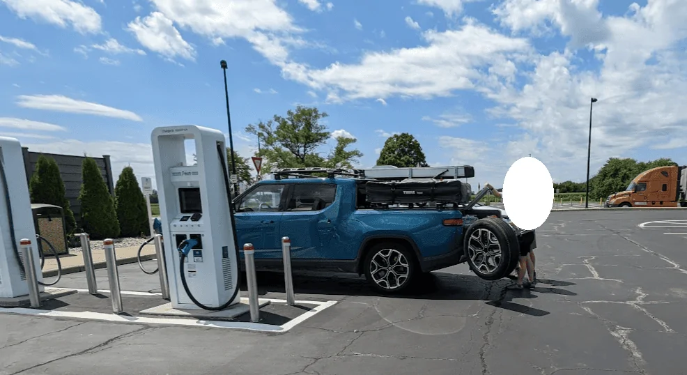

For us, the hassle of charging with a trailer attached (or having to drop a trailer) has been a bigger deterrent then the impact to range or the longer charging stops. Our common routes into the mountains only have so many chargers, and we've been paying close attention to which ones would have trailer friendly spots (even if not labeled as such) and which ones would require us to drop, and there are a fair amount where even finding a spot to drop a trailer would be a pain in the ass, and we're only pulling a Turtleback Getaway.

It takes dedication and planning to pull a trailer long distances, not to mention extra extra time.
You would use ABRP and google maps to scope out the charger and plan your entrance so as to not drop the trailer. A lot of them where I live seem to have a large area with metal walls [like at grocery stores or walmart] that hold the electrical equipment - it allows you to pull into the first charger and let your trailer sit out in the roadway without blocking folks.
