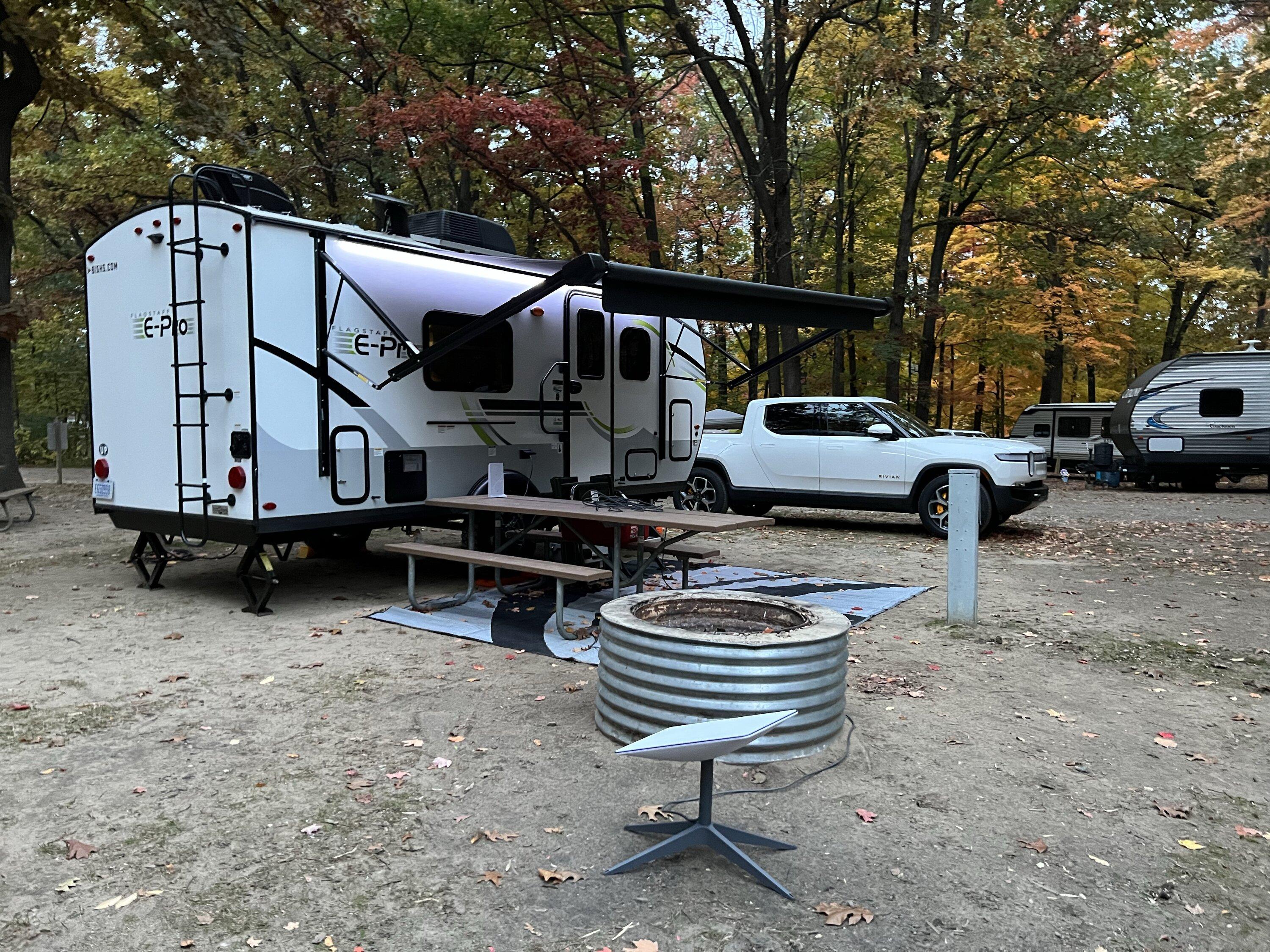

I’ve got a Epro 19FD. ~4200lb loaded. Doesn’t even feel like it’s back there while towing.
