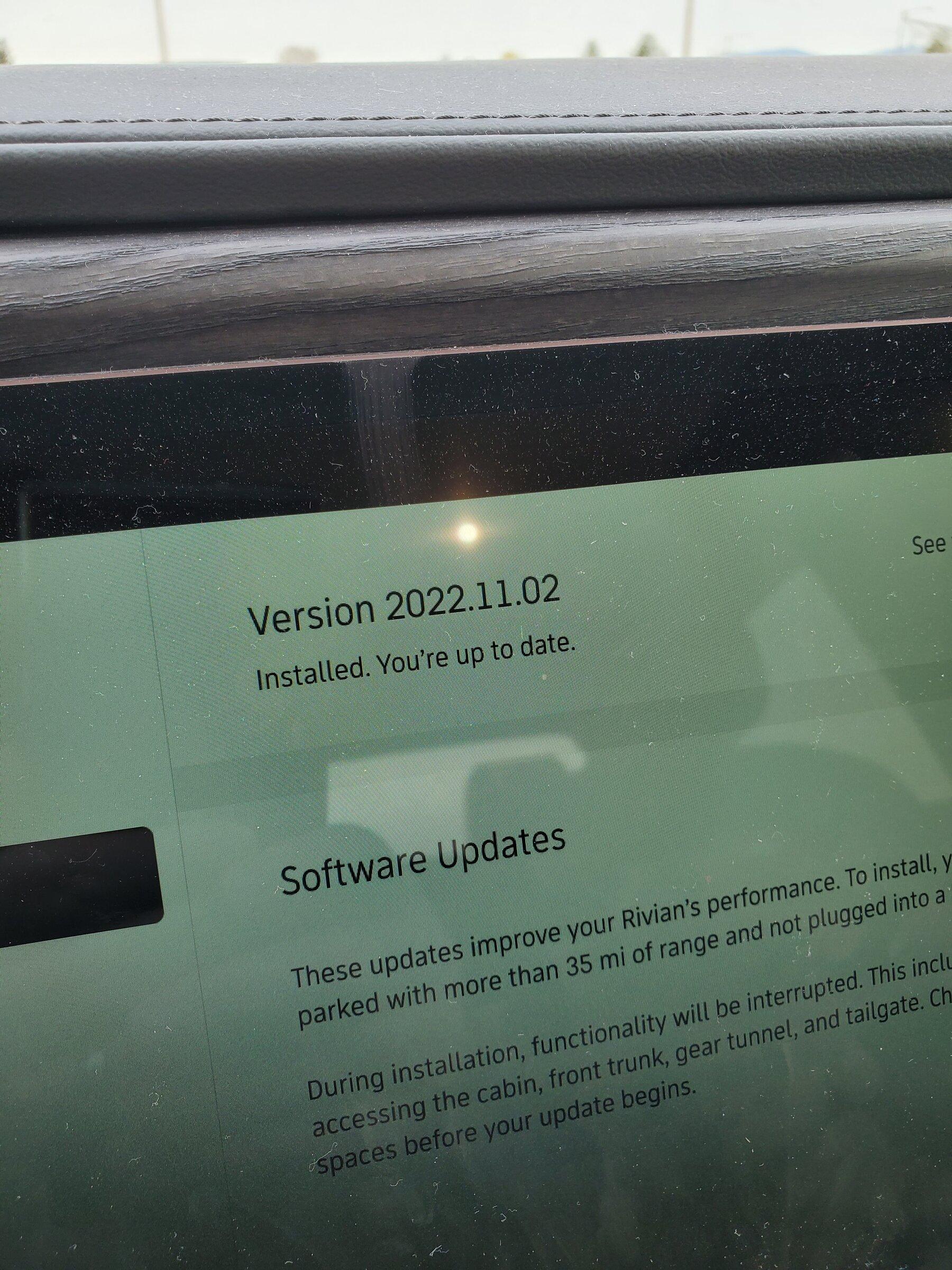

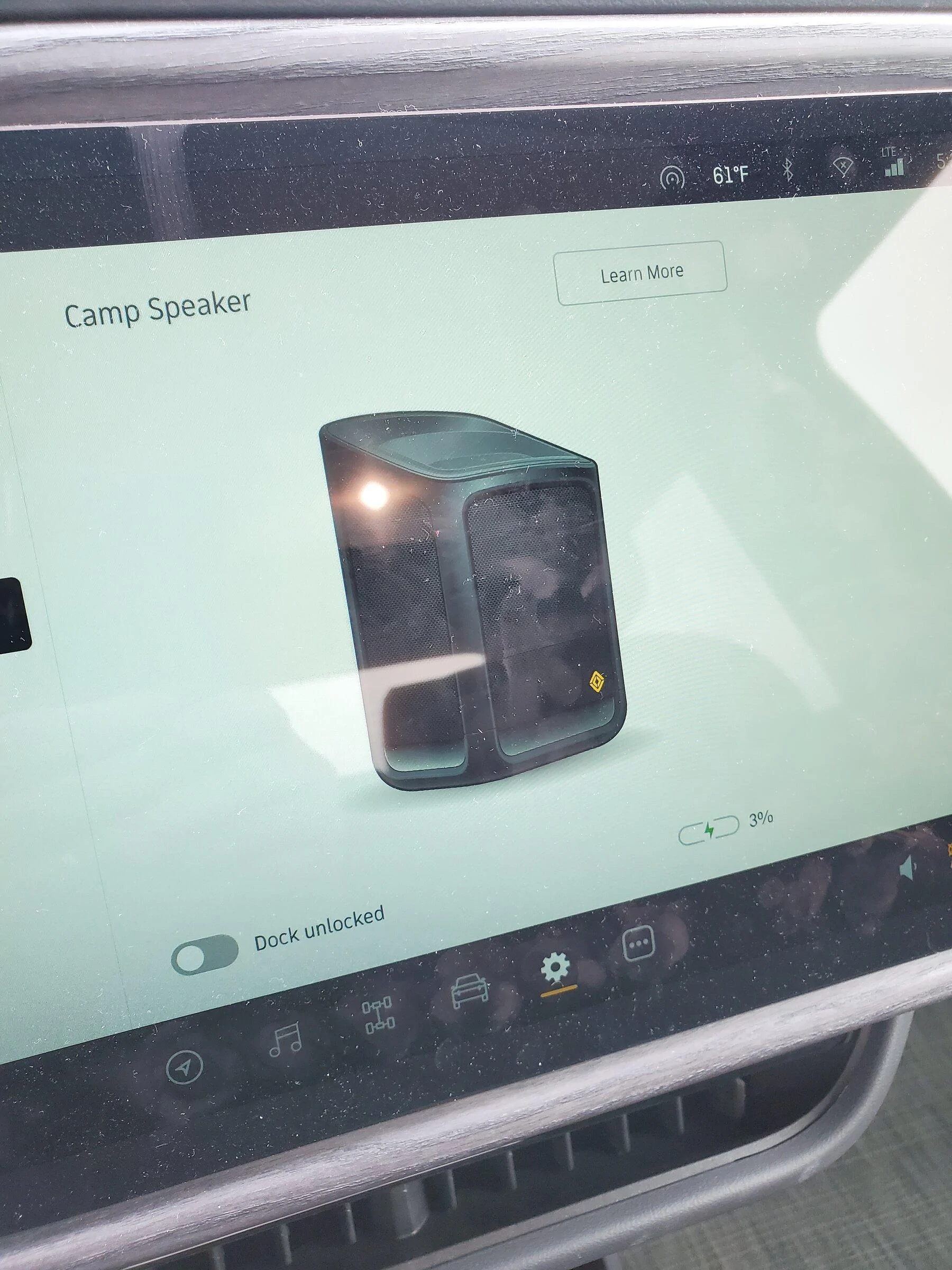

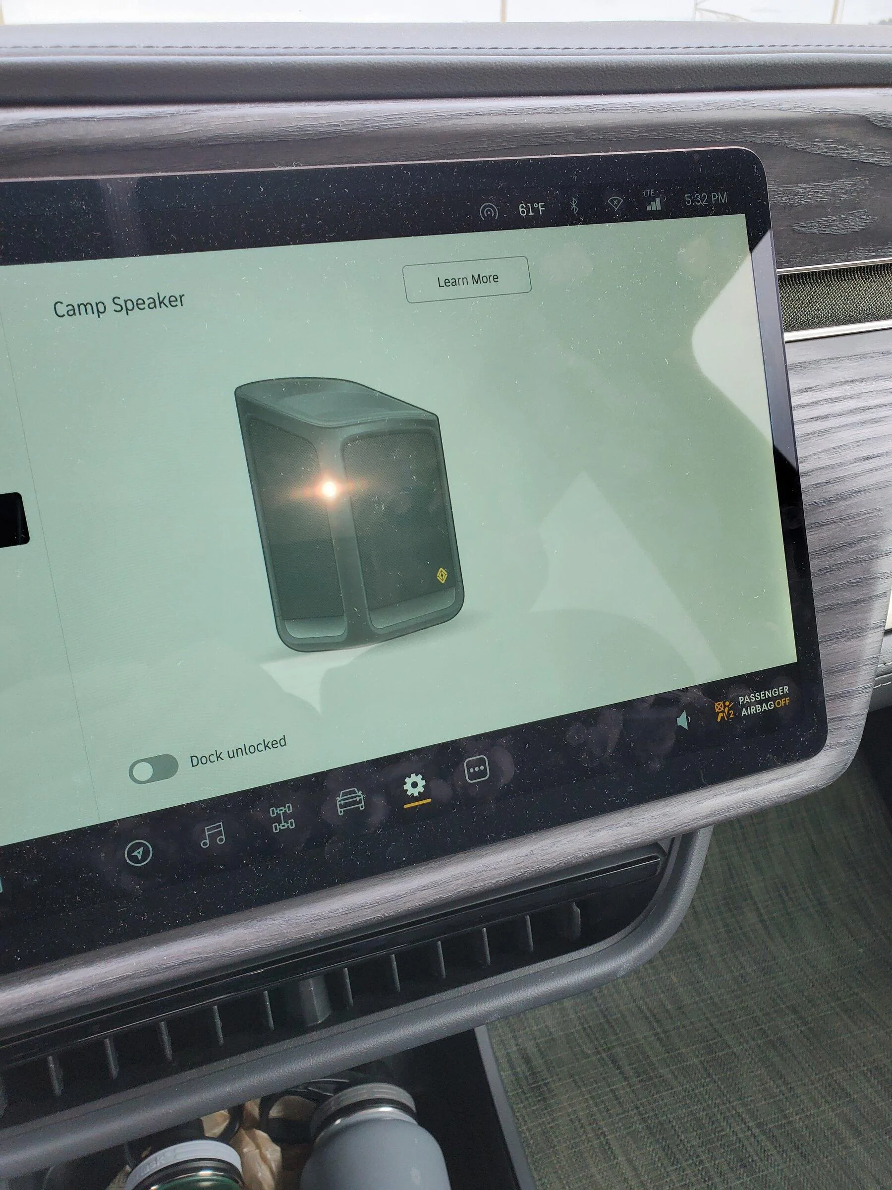

I have 2022.11.02 and no charge state is shown...

Edit: Looks like I had the same issue as OP. Pulled it out, turned it on, put it back in and now...
The charge % display can be … shy.
Sometimes there's the "reinsert" prompt I mentioned.
I asked if "100%" was 100% or was it more like 70% of a larger battery, but that fact won't be known till someone decides to disassemble the speaker. I'm just not that curious … : )
