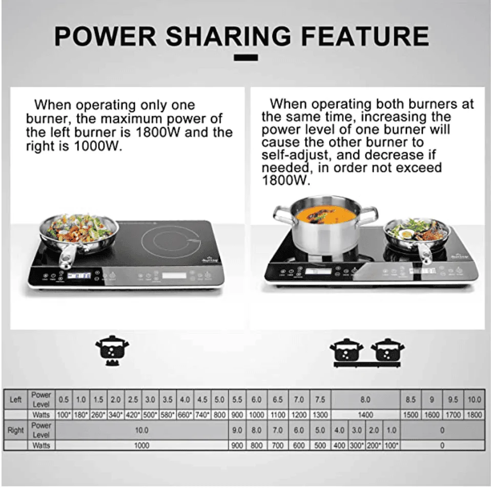

How does the 1800w cooktop work with the 1500w limit of the R1T - does it mean it just can't go to 11?
ETA: Answering my own question
Rivian R1T R1S "Budget" Camp Kitchen (No Gear Tunnel) Screen Shot 2022-06-08 at 8.05.48 PM
1000W on the stovetop boils water really fast, and I can’t imagine a scenario where I’d go that high for anything else. I don’t think I’ll ever have a need to go above 1.5kw total for both burners at the same time, but honestly haven’t tested what happens if I were to try from the bed of the truck. My guess is that it might still put out 1800W for a while (probably longer than I would want/need to try). Or, maybe I’ll just get some error message from the burner if it doesn’t auto adjust. If it’s a big issue, I’ll just accept that boiling water may take 30 extra seconds.
Regardless, I should just test it out this weekend.
